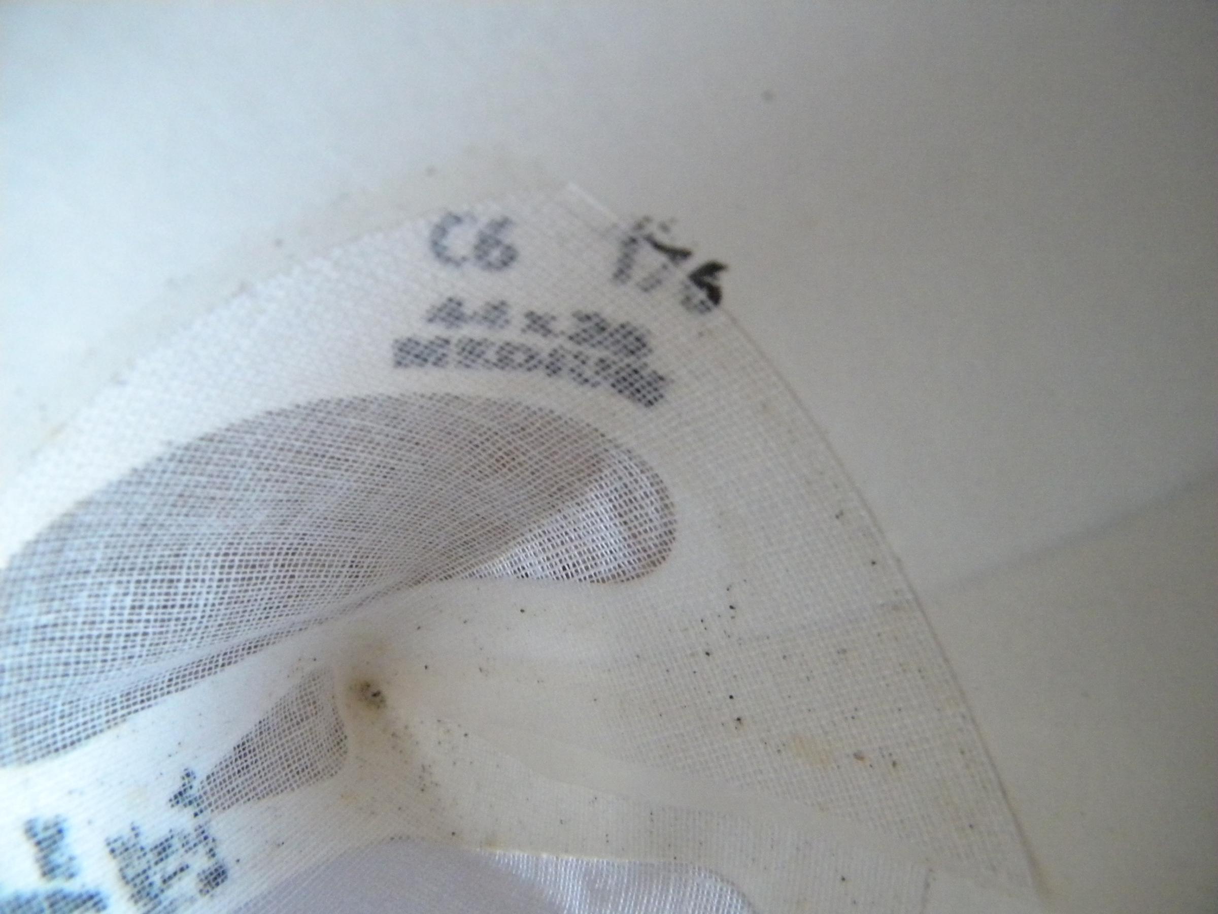

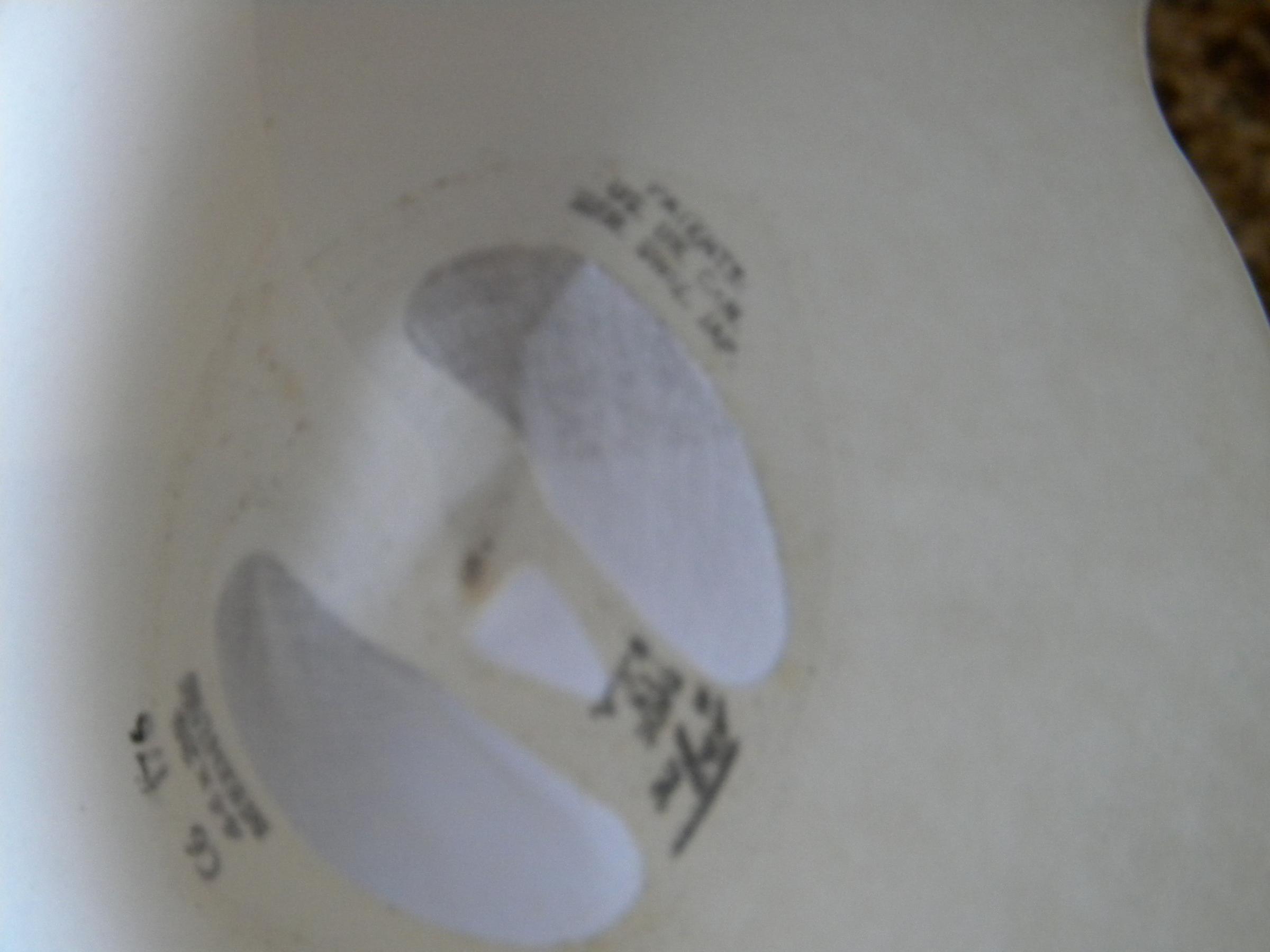

The factory recommends changing the oil after 1 year or 10,000 and12,000 miles depending how hard you drive your car. I think that is a load of crap too. ............ I never had a car that I didnt change the first oil at 2000 miles.
Leaving the oil in for 12,ooo miles only allows for metallic particles from the manufacturer casting and forgings to float around in the engine...... My bf's cousin builds race engines, from bareblocks to blown engines. These are engines with aluminum blocks.
He and no one else I know reocomends leaving oil in that long. If you dont believe that it should be changed at 2000, try doing the following........ On the first oil change get an auto paint strainer from any automotive finishing hous and run the first oil change thru that strainer.
I included a pic of the strainer. the strainers are thro aways and u can get a pack of them for 10 dollars. The size I use is a C6 176. These are availabile in both the U.S. and the UK, Switz and Japan. I drain every oil change thru one of these, looking for particles, at 2000 miles.
I can see a metallic glimmer but I never have found large flakes or pieces.... If you dont cahnge your own oil you can ask whoever does to run the oil thru the strainer when he pulls the plug. If they wont do it then go somewhere else.

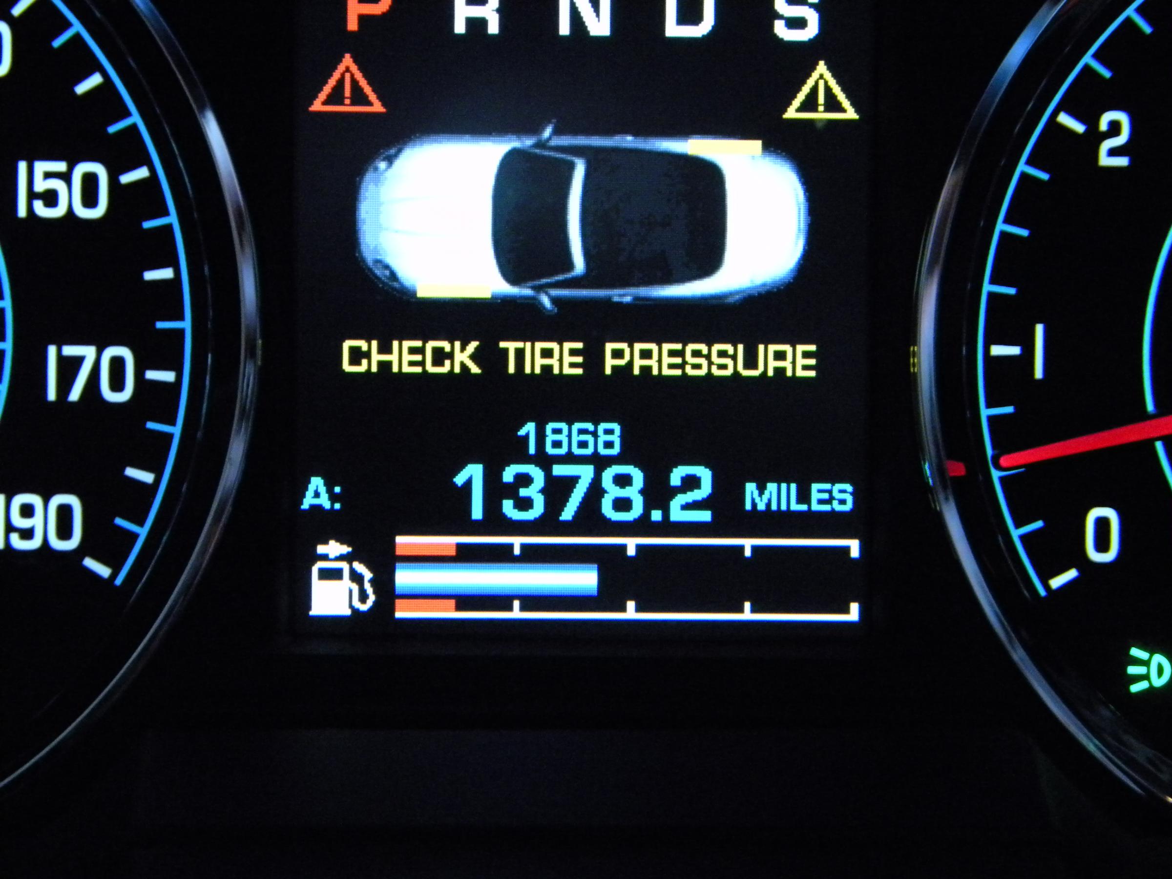

I sent a pic of my mileage and I am changing my oil now at 1850........... peace of mind from a Polish hooligan. .......... If anyone has a 5.0l s/c engine they want to sell I am more than happy to buy it. But no thrown rods through the block.
