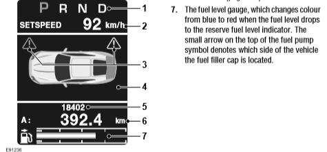

And finally... What are the little red bars on the top and bottom of the fuel gauge?
(This is not a pic of ours, just an example)
Is that the oil life indicator? If so, there is no mention of it in the handbook. If not, where is it? There are youtubes about how to do the service reset. Surely if my 1999 Ford explorer has an oil life gauge, this thing does too, right?
Any help would be appreciated.

The red bars on the fuel gauge indicate that you are on reserve.

The red bars indicate water temperature .
In regards to the oil spec Woo5ie is 100 percent correct!
Surely, they are as Woo5ie states "The red bars on the fuel gauge indicate that you are on reserve."

Here's the correct answer for the fuel gauge (red bars). Click the image to enlarge.
Attached Thumbnails Oil Change Questions-jaguar-2007-fuel-gauge-warning-blue-red.jpg

Yeah, I saw that - page 116. But that graphic doesn't refer to the red bars that go from 0 to 1/8th of the fuel gauge. Now I am surmising that those are actually pertaining to the fuel gauge - as in, if your fuel level gets to that area, "you are in the danger zone" of running out of fuel. And that there is no visual gauge pertaining to oil life. You just get a notice that your car needs "service" when it's time for an oil change.

I assume you don't have the OM so just to make sure you know there is no , oil pressure , oil temp. , oil service life , water temp . and battery voltage instrumentation in the XK series cars. The fuel gauge is the fuel gauge and tells you level of fuel with the red warning zone which only give you a few gallons of fuel left before you stop. You can buy an OBDII adapter and SW that will show the water temp and other functions but nothing about oil.
Assuming "OM" refers to "original manual", why do you assume I don't have one? I just said I saw that graphic on page 116...
Also, I think OBDII stands for on-board diagnostics, but I am not familiar with "SW". What does that stand for? See? I know just enough to be dangerous.
No, they do not. The red bars indicate that the fuel level is LOW - and running often on low fuel will damage the in-tank fuel pump which is cooled by the fuel around it. This is the most frequent cause of fuel pump failure.
