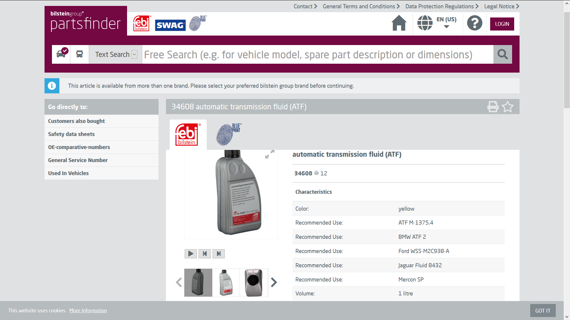

I'll add that the Jaguar Manual recommendation is Shell M1375.4 which Mercon SP meets as does Ravenol, Pentosin ATF. Valvolene has a product out there too. So I suspect when the transmission was originally developed, the fluid specs were probably only met by ZF but as time passes and as with other parts, Non OEM catches up.

Just to add to the confusion, here's some German fluid that conforms can be founfd for ~$15/litre
