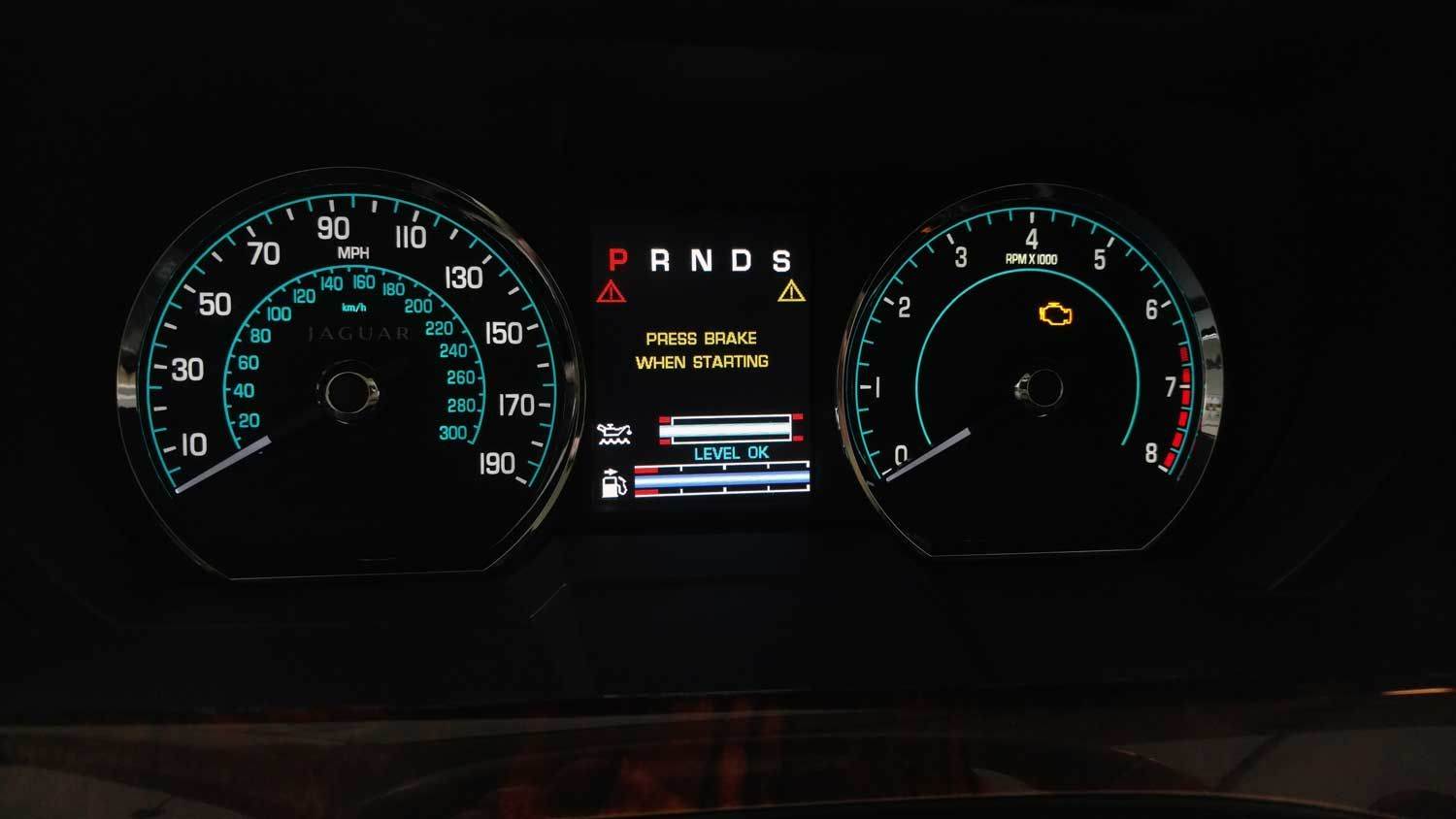

Originally Posted by pwpacp
I'm not sure what you are refering to on the gauge. Here is what mine looks like right now. I know it indicates a little low but I'm changing the oil this week end anyway and won't be taking it out until then. Can you snap a pix of what you are looking at on the panel? That might make it clearer for discussion.
My oil change process is to warm the engine, wait 15 mins then begin the extraction process. I don't worry about measuring what is removed only making sure I add exactly what the manual calls for. After all is done I check the guage to make sure it looks at least like it indicates now then warm the engine...wait 15mins and check it again to see if it needs to topped off.
Just an FYI you are not low on oil. If you have a solid bar filling the two red bars on the right you have TO MUCH OIL. The solid bar should stop at the two red bars.

Hey all, my oil gauge now looks like the jagtoes one. It looked like that after I refilled the oil. all good.
