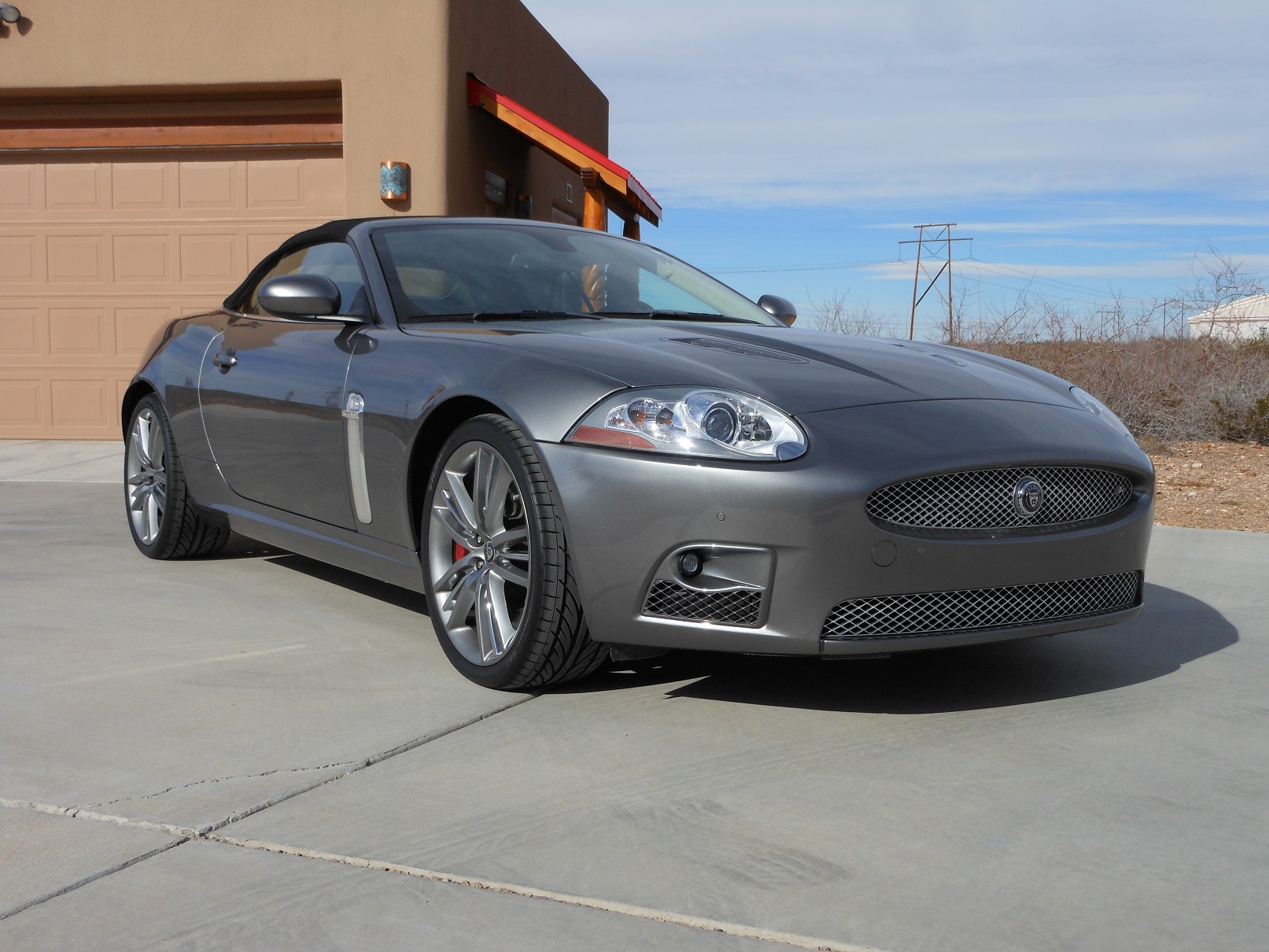

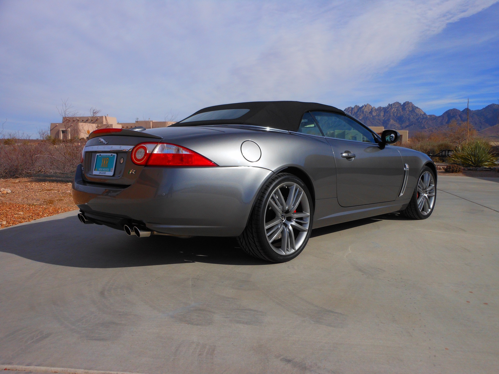

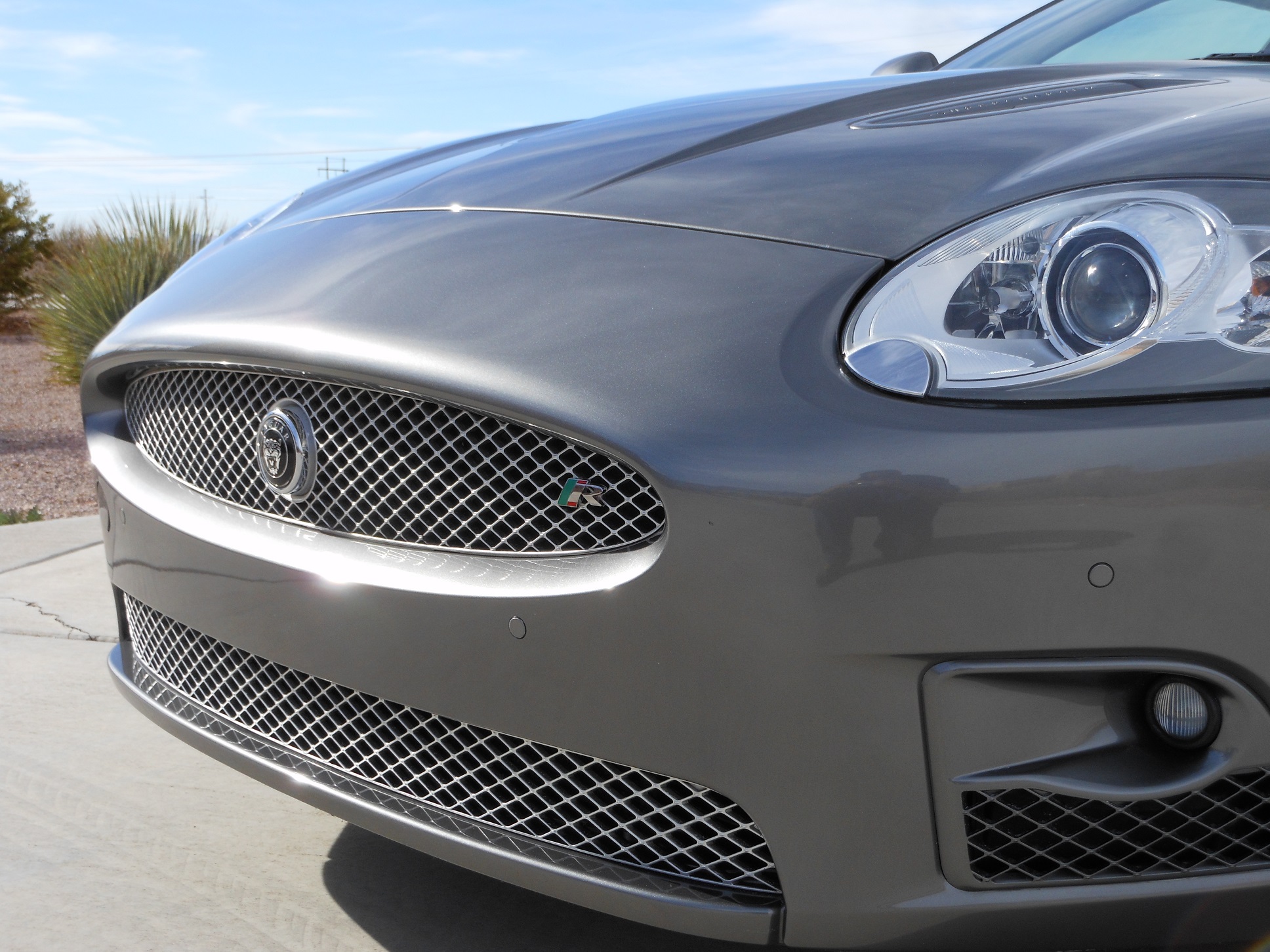

2009 Jaguar XKR Portfolio Edition finally detailed with Opticoat 2.0 sealant.
Total time about 12 hours as a DIY project.
DIY Cost for supplies including Opticoat 2.0 from Autogeek.com was right at $130.00...
Opticoat 2.0 $89.99.....Autogeek.com
Detailers Pre Coat Sealant Prep $19.99.....Autogeek.com
Meguairs Gold Clay Bar Kit $18.99....eBay
Washed the car....used dual action buffer with Meguiars Swirl X removal product....clayed the car w/ Meguiars Showtime Detail Spray for clay lubrication.......cleaned off excess Meguiars Showtime detailing spray residue...used Detailers Pre Coat sealant Prep....used alcohol for final wipedown...applied Opticoat 2.0
XKR turned out beautiful.......photos taken after 4 days after sitting to let Opticoat 2.0 cure on the paint surface under car cover.
It was allot of work, but for the price ...well worth the end result.
Attached Thumbnails Opticoat 2.0 Paint Sealant DIY Detail-jaguar-xkr-portfolio-edition-w-opticoat-2.0-002.jpg   Opticoat 2.0 Paint Sealant DIY Detail-jaguar-xkr-portfolio-edition-w-opticoat-2.0-003.jpg   Opticoat 2.0 Paint Sealant DIY Detail-jaguar-xkr-portfolio-edition-w-opticoat-2.0-004.jpg   Opticoat 2.0 Paint Sealant DIY Detail-jaguar-xkr-portfolio-edition-w-opticoat-2.0-006.jpg   Opticoat 2.0 Paint Sealant DIY Detail-jaguar-xkr-portfolio-edition-w-opticoat-2.0-007.jpg
