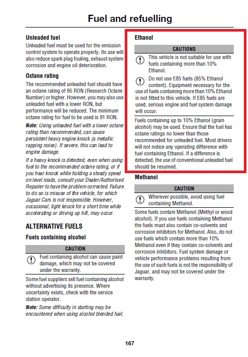

European spec XK/XKR can safely use E10. Here's the relevant section from the 2008MY Driver's Handbook (see section boxed in red):
It's becoming increasingly difficult to find 98 octane in France.

Thanks a lot, a gas station owner said it was bad and i was worry.
