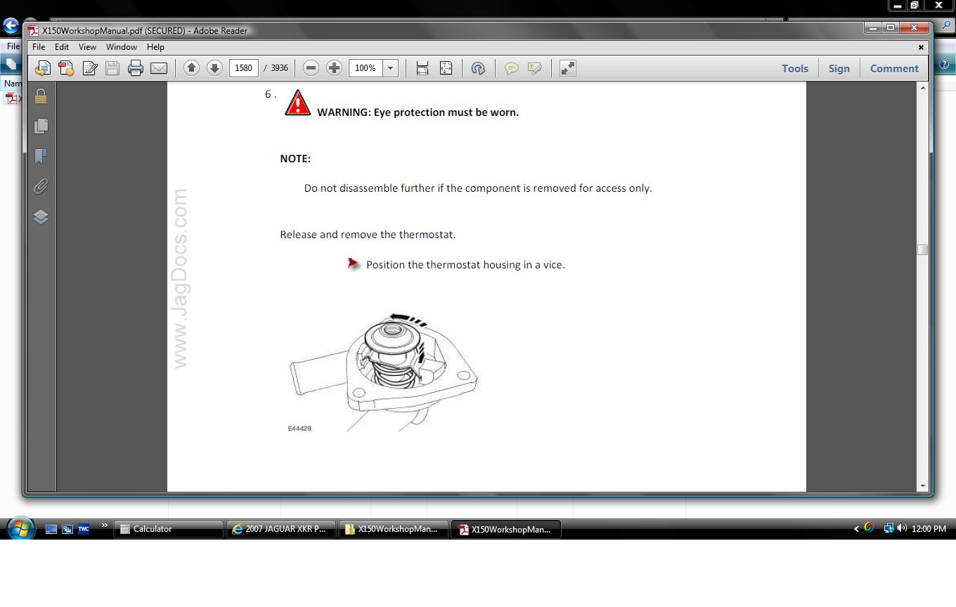

I tried to order just the thermostat from Gaudin and they came back at me wtih it not being available. The only way I could get the thermostat was to order number 12 on your list, which is the coolant outlet assy , which included the thermostat as a part of it and also it had a new ECT sensor installed in it.
I'm glad they did not sell me just the thermostat because I found out my Real problem was the outlet assy had an internal crack that was the Real problem. I made a post on this a month ago or so.
The thermostat assy itself is composed of three distinct parts that are installed inside the cover of the coolant outlet assy.
Gaudin could not sell me just the thermostat, but maybe your local Jag dealer will have one.
I agree with the post just below this one.............replace the whole coolant outlet assy for your own good. Number #12 I believe from memory.
You need item #14 and #15 but not #13. The 13 is a oring b/t parts your NOT going to have to remove to replace just the thermostat.
EDIT: Your just going to remove the radiator hose from item #16, then unbolt the three bolts from item #16.............hold item #16 in your hand and unclock the thermostat assy from item #16............discard the old thermostat and put your new thermostat together with the other two parts that clock into the #16 (cover) and reassy the shebang.
Item #13 is used only if you replace the whole coolant outlet assy.
Attached Thumbnails P0128 -- XKR Coolant Thermostat Change-thermostat.jpg   P0128 -- XKR Coolant Thermostat Change-thermostattwo.jpg
