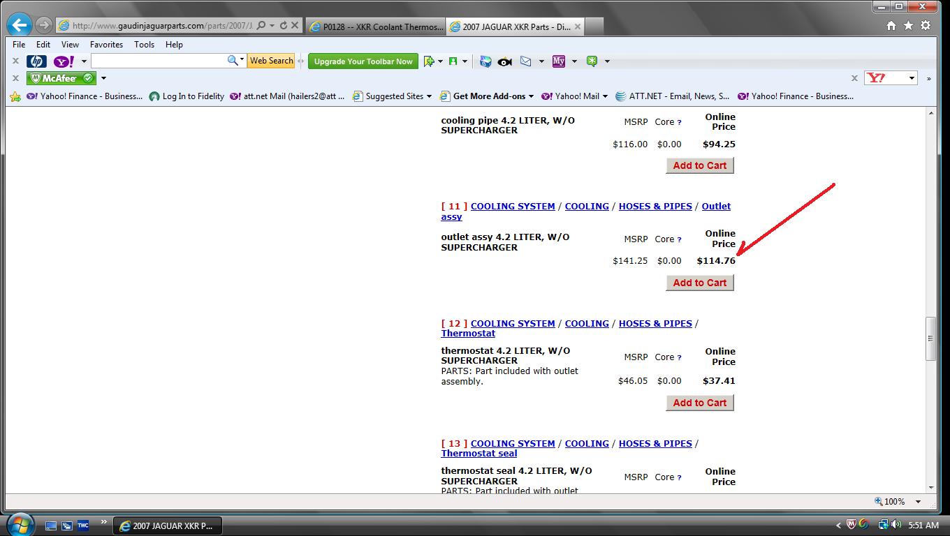

I went to the Gaudin site and searched for a 2007 XKR and came up with the two jpg attached.
The first shows a box with numerous parts in it and they all have numbers. Outside the box is the number 11. I ordered the number 11 part which include all the parts inside the box. Number 11 costs $114.76.
I'm not sure why your attached jpg looks different than mine. I never added up all the seperate parts and compared it with the single number 11 costs.
Yeah, you shoulda just ordered number 9 in your jpg.
Attached Thumbnails P0128 -- XKR Coolant Thermostat Change-xkrgaudin.jpg   P0128 -- XKR Coolant Thermostat Change-xkrgaudintwo.jpg

It looks like you've pulled up non-XKR parts as it says "W/O supercharger".
I did order #9. So I'm guessing I ordered the right thing?

Your right. I don't know why I got it wrong the first time. See new jpgs
Yes, everything in "the box" is what I ordered. Number nine in your picture and number 11 in the jpg I just now attached.

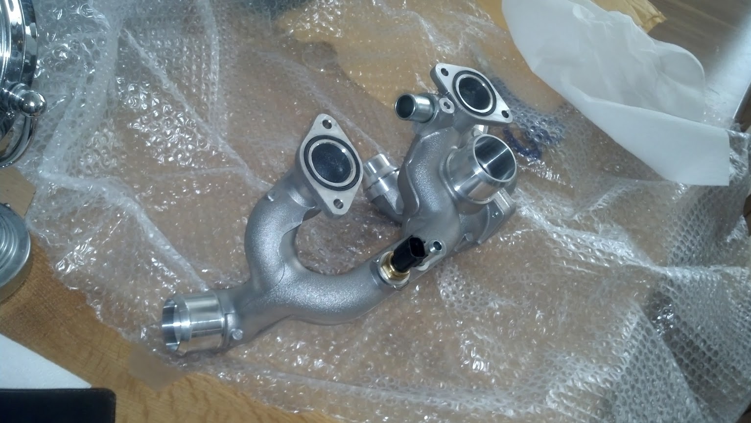

I just got the delivery in the mail today. I'm a little surprised--I was not expecting the thing to be made out of metal, but out of plastic! Are you sure that I need to replace this big honking metal piece? There is some plastic built into it on the inside that is prone to breaking?

plums's Avatar
Posts: 9,733
Likes: 2,203
From: on-the-edge
In post #12, WhiteXKR mentioned that the SC models with an aluminum crossover do not have the same problems as the NA models with the plastic crossover. Hailers has the NA model, you have the SC model.
What you need is just the thermostat.
NAPA 33948 is the *exact* same as OEM complete with seal.
$20 or so.

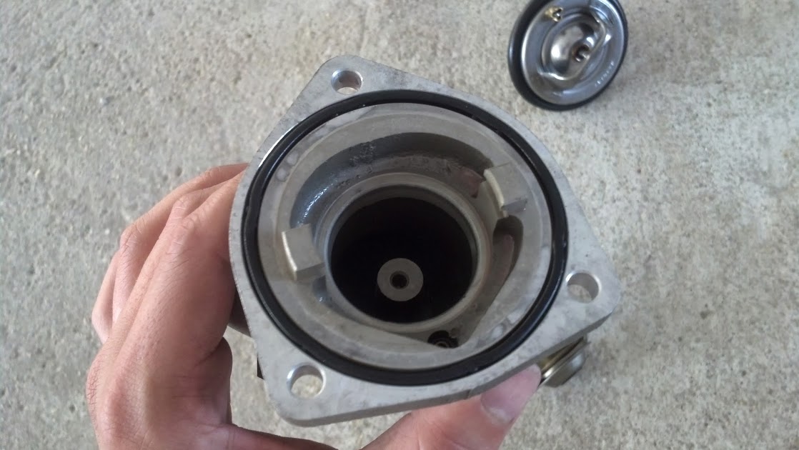

Argh.... am I not doing this right? The Stant 14748 I ordered does NOT appear fit the thermostat housing. The original OEM thermostat appears to be a multipiece thermostat.
OEM:
Stant/Gates/Waxstat:
Thermostat housing (notice the two notches where the original thermostat sort of clipped in):
Interestingly, it does seem fairly obvious that the thermostat had failed, as the seal has come apart (it was like that before I even took it out of the thermostat housing):
Did I not remove the old thermostat completely? What's going on??
I am really irritated because now my wife has to drive me to work!!
Attached Thumbnails P0128 -- XKR Coolant Thermostat Change-img_20131006_114632_473.jpg   P0128 -- XKR Coolant Thermostat Change-img_20131006_114835_376.jpg   P0128 -- XKR Coolant Thermostat Change-img_20131006_114650_026.jpg   P0128 -- XKR Coolant Thermostat Change-img_20131006_114640_381.jpg   P0128 -- XKR Coolant Thermostat Change-img_20131006_114820_728.jpg

Ngarara's Avatar
Posts: 3,425
Likes: 1,140
From: London, UK
According to what I can see in the workshop manual, the OEM part is what the thermostat should look like - it certainly doesn't took like the Stant part.

Hailers's Avatar
Joined: Aug 2012
Posts: 379
Likes: 98
From: FORT WORTH TX
My 2007 NON supercharged thermostat is a three piece like the one shown in your hand. I do not see how that STANT could possibly work. Then again, I'm not there to see it in hand.
I'd recommend a factory thermostat and it is a three piece one (counting the spring) that locks under those two 'dogs' in the housing. One of my dogs was also broken off (plastic on non turbo cars).
