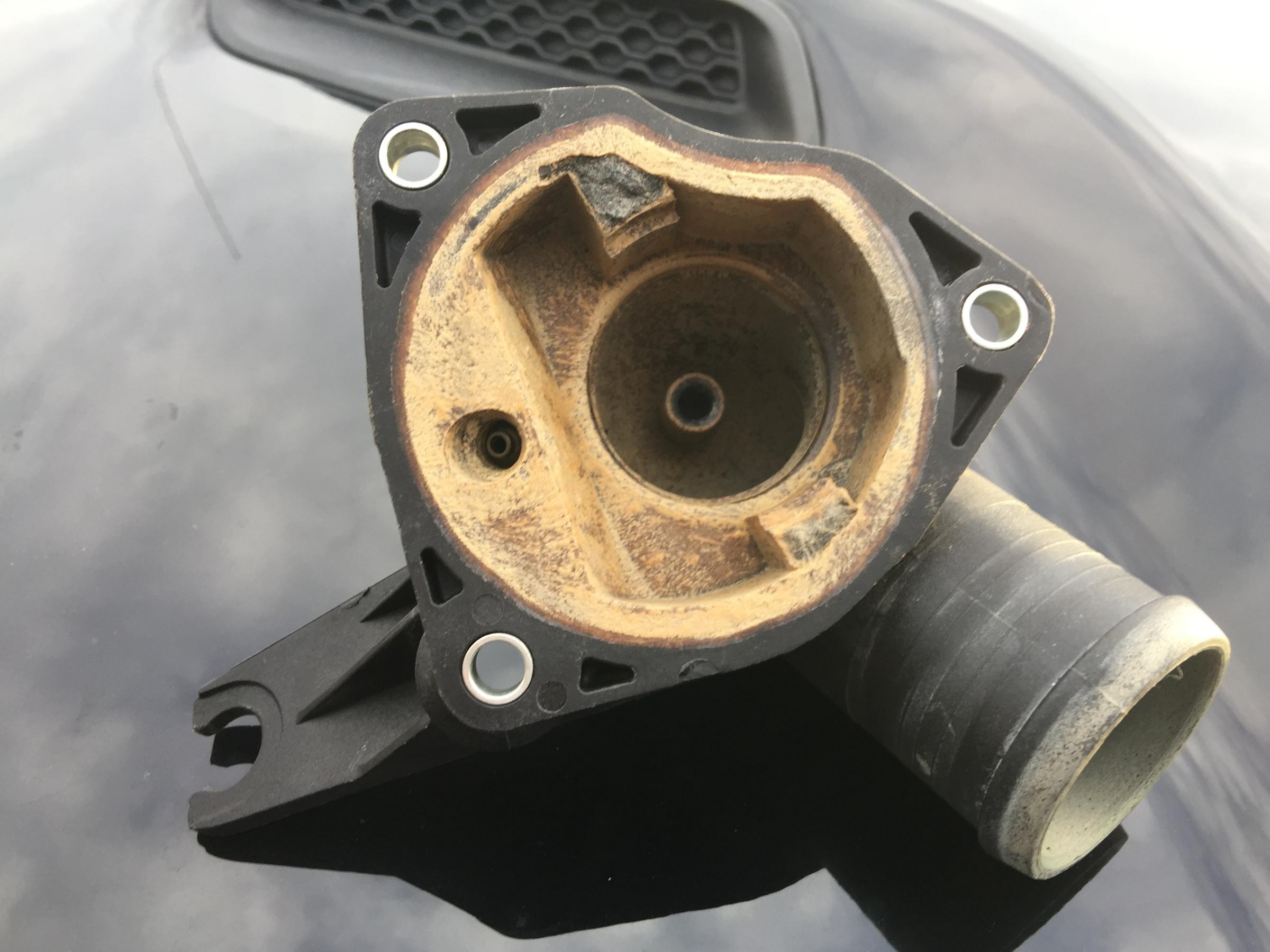

Old Feb 2, 2015 | 09:35 AM
  #51
synperkaya's Avatar
Joined: Jun 2012
Posts: 66
Likes: 7
From: san antonio tx
Default Housing has to be checked..
If your having problems with the temp warning or fans running more than you usual, you Must check your thermostat and the housing...Up until 2 weeks ago I noticed my fans running and I had purchase a Bluetooth scanning tool, and found my engine temp was getting above 230 degrees, after opening the thermostat housing my thermostat was completely broken and the main housing was cracked in the inside, see attached.. I managed to purchase the whole assembly from Gaudin and put it in this weekend...if you can rebuild a carburetor you can install this assembly. .My Xk only had 49k miles as well. My xk now never passes 198 degrees as of yet, and now runs awesome...It would seem the design is poor and if you have over 40k miles, it will eventually fail..
This is just my two cents..
Attached Thumbnails P0128 -- XKR Coolant Thermostat Change-thermohousing.jpg   P0128 -- XKR Coolant Thermostat Change-thermohousing1.jpg
