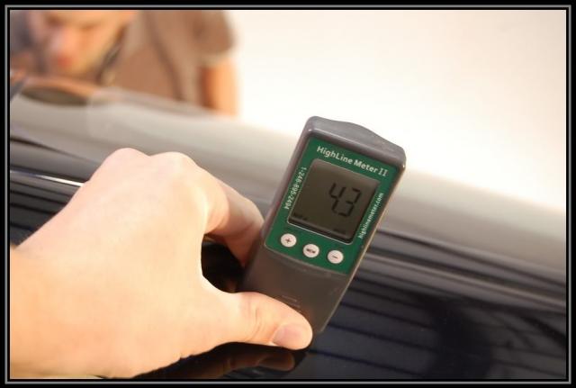

Had some paint correction done a couple years back. The detailer measured the paint before starting the machine work. Here's a LINK to the whole process. He was trying to grow his high line business so he documented it pretty thoroughly for marketing purposes.
"Next we took paint thickness measurements to make sure the paint was thick enough to safely correct the paint. 4.0-4.5 mils are typical thickness for original paint thickness (some make and models slightly differ)."
Attached Thumbnails Paint thickness-xkr0096_zpsd9cf7f79.jpg   Paint thickness-xkr0097_zps1808f7f8.jpg

All measurements are in um (microns) taken with Highline II meter, same as pictured in AirCav's post.
