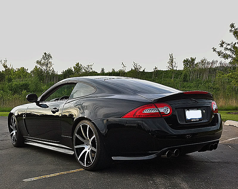

Hey Mike....mine is about a 1 inch drop with the PP. Like Moe said...it is stiffer than stock but by all means not bone jarring stiff. I do wish it was alittle more stiff as I still do feel alittle more bodyroll during cornering than I like. Possibly you can also add a bigger sway bar and or polyurethane bushings...have not seen these aftermarket upgrades available though.
As for ground clearance I find the front bumper stilll goes over the curb when parking near one (amazing).....but now with my front splitter I have tap the front splitter onto the curb once when parking. Small chip on the paint of the splitter. Going over speed bumps I've had no problems so far either although I try to angle my way over.
Here's the difference in the paramount as you can see the gap difference in the rear. I bought it more for a lower stance.

GREAT INFO! Thanks guys. You can see quite a difference in the before and after pics around the wheel wells (Great mods Ghostrider) and with the sway bar explanantion I now understand that when I lost her taking a curve too fast the other day it may have been unrecoverable if I had stiffer sway bars. I'm probably better off leaving those alone and just going for the lower asthetics.
BEFORE (MINE WHEN STOCK):
AFTER:
Awesome XKR Ghostrider. I noticed the trim around the side windows and the side louver is black in the "after" photos. Were they painted or is that a film that is applied? If it is the film, has it started to peel around the edges? Are you happy with the results. The Black Series has this & I think it looks great...Approx how much $$ is it for something like that?

Eurotoys did the vinyl.....similar to vinyl wrapping roof or hood. Indeed I wanted mine to look like the black pack/XKR75. I did blackout the front grills, rear blade and side louvers also. I'm don't remember how much as I had Eurotoys do the side skirts, rear diffusor, air intake, ECU tune, hiflo cats, HID yellow foglights and blackout kit (including blacking out the window trim) all at the same time. I'm guessing $100-$150. You can probably call your local decal/pinstriping shop to get a quote. If you're in the LA/Irvine area, There's a guy name Don who does great work. Although I've never had anything done from him.....his pictures of wraps on other forums looks awesome. Here is some of his work:
