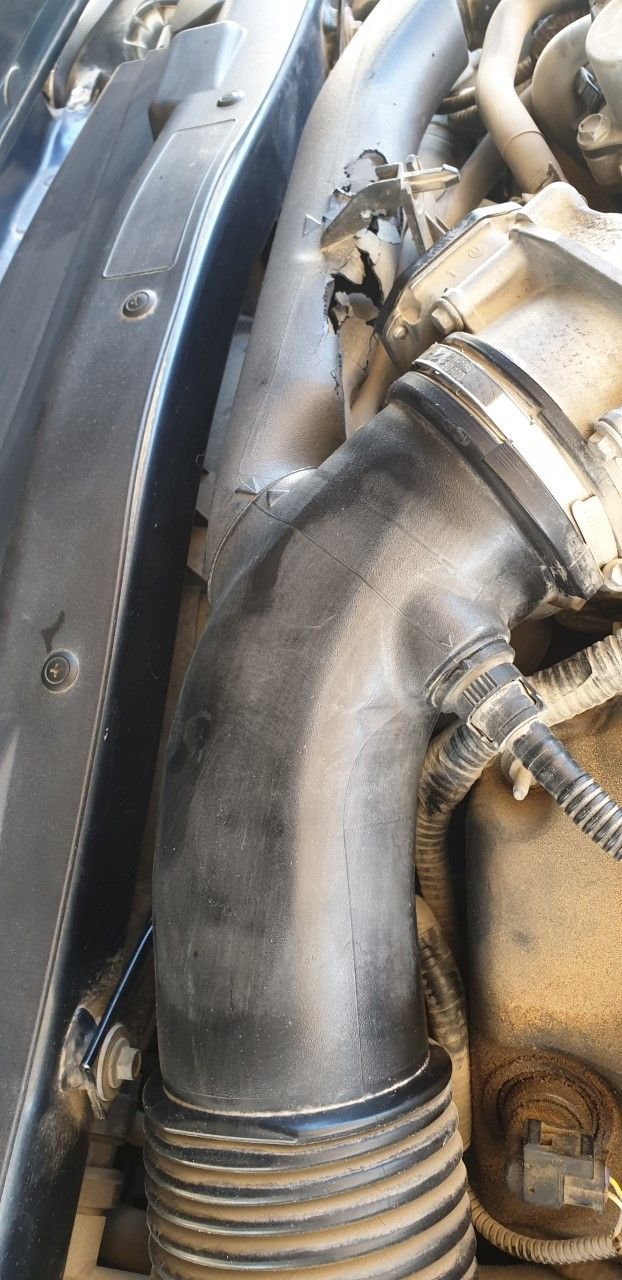

I opened the bonnet on the XK today & found some brutal damage to one of the plastic components (air intake?), located directly in front of the engine.
I was reluctant to remove the piece to avoid further damage, as the piece is extremely brittle. I have no idea how the damage occurred, however the Middle East summer temps have no doubt contributed.
I'd appreciate any help ID'ing the part & any help with the Part No would be brilliant.

Up in the stickies you will find a link to the workshop manual and electrical information. They can both be downloaded at no cost. You are correct about the part being pat of the cold air intake system. You should be able to find what you need there. If not, another member of the forum more knowledgeable than I will probably jump in with more specific information.

Looks like part # 8 on this diagram, part # C2P2147: https://partsfan.com/jaguar/ww/7422/.../12570/8#parts

OzXFR - that's the part. Thanks for your help. Dealer price here for that is near extortion, so will look for a better source online.

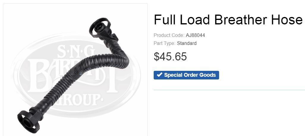

Can someone please tell what this part is (assuming some form of air sensor), as it connect with the Air Intake Tube?
The plastic retaining/connection clip is broken & I'd like to replace the connection.
Cheers.

Cunjie make sure you change your oil immediately. Your engine took in a lot of sand and its in the oil.
You can use aluminum tape (available at air conditioning supply companies) for now to fix it, it will last for many months.
Just make sure you break all the lose pieces as that can go through you engine.
Important, before you seal- replace the air filters. you will have sand on the back of them, which will get sucked in after you seal and give the engine full suction.
Another thing you can do is just cut that entire section of pipe and replace it with a rubber hose or plastic pipe of same diameter. You can find cold air kits on ebay that use same size tube.
You may think this is a bad thing to do, but if you are correct that the heat has started to break the plastic, the rest of it will also break soon and you will have to find complete assembly.

Queen & Country - I have a new inlet pipe & new filters ready for replacement this weekend & oil change has been completed.
Cheers for the advice.

Cheers gkubrak, I will order myself a replacement.
