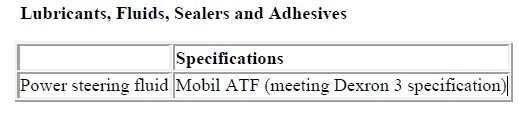

I have no idea why the workshop manuals (both the 4.2 [misspelt as Dexron] and later 5.0 versions) both state Dex III but the owner handbook does not

The Op misspelled "Dextron" - its Dexron. Service manual says "Dexron 3" rather than using three " III s" . The owners manual for my 2009 says Dexron III - eye, eye, eye captin.

In defence of the OP, it's JLR who cannot spell "Dextron"!
There must be so many x150s that have been topped off or flushed through with CHF 202, just waiting for pump and rack failure, it's a shame.
