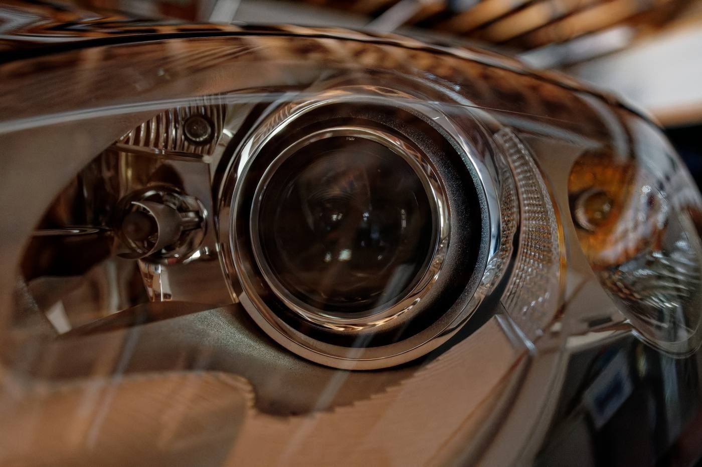

The main beam housings on these cars can get very cloudy on the inside. You can tell if it needs help by just looking at it from the outside. Are they a cloudy silver or a totally transparent crystal in appearance? They should look like crystal.

I think they are pretty clean/clear. When apart I cleaned the inside of the lens, it was not really dirty or dusty…there is either a coating applied to or etched on the inside helping to disperse the light, the lens is not water clear.

My lenses definitely don't look that clear... more like cataracts .. Has anyone cleaned them ? What is the process ? Assuming you have to remove the headlight assembly from the car , unscrew the round black cover/ring and remove the Xenon bulb... do you just use something like a large q tip or something to wipe down the inside of the lens ??

I used 'Stoners' glass cleaner, sprayed into clean dish and then really long swabs.
https://www.harborfreight.com/cotton...ece-57577.html
be careful! When I pulled the bulbs the wiring sheathing fell apart into 4 million 300 hundred thousand pieces. I then had to add heat shrink to the wiring for fear of a short. This insulation failure is documented and I assure you that it is not a fun project to make repair.

Well… just clean them. I have to do the same. I added LED bulbs to mine and there is more light output, but I have to still clean the cataracts
Fat better than before

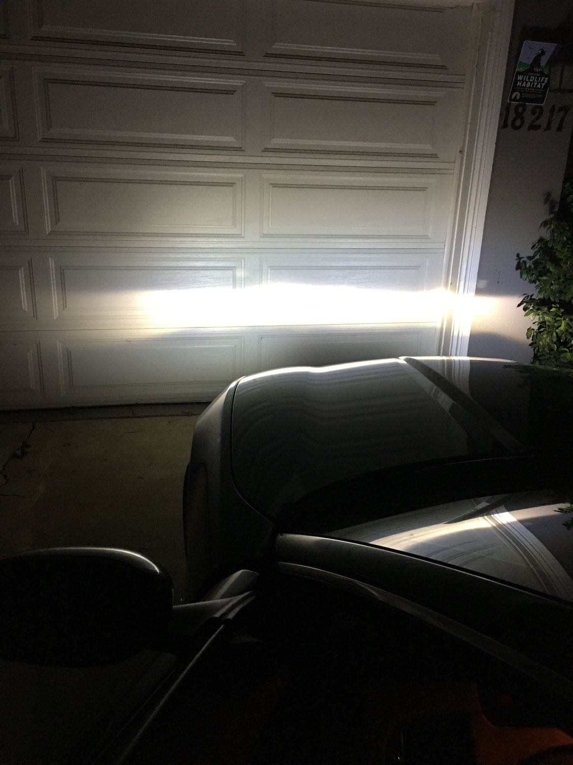

would you be so kind as to take a photo where the car is pointing down a street or driveway...maybe say 100 feet or more. Once with low beams and once with highs?
thanks if you can...

I used a cheap Ebay brand, but Id look into buying a set of Lucas units which are about $200 for a set. I just wanted something that would plug right into the existing ballasts. No splicing or messing with any of the factory wiring.
Plug n play LEDs Plug n play LEDs
