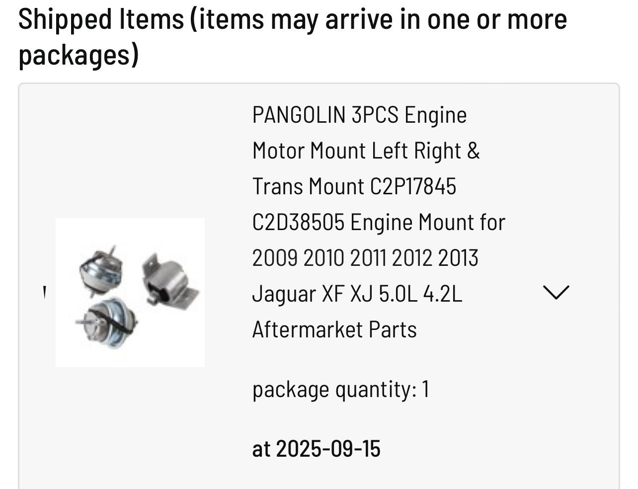

I got 2 engine and a trans mount for under $200.
I have not had them installed yet, but they look identical and everything I could find here and elsewhere says they will fit my 2008 XKR.

They will probably be exactly the same dimensionally, but I'd bet the XKR had firmer bushings in them from factory, which is why the part # is different. However, the aftermarket ones probably don't discriminate, and any you find that will fit your car will be the same as the base one anyway. I'd say go for it.
