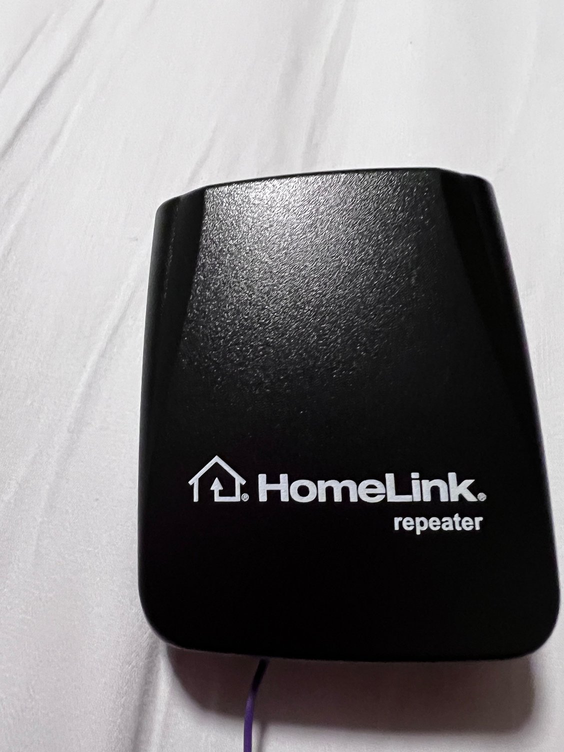

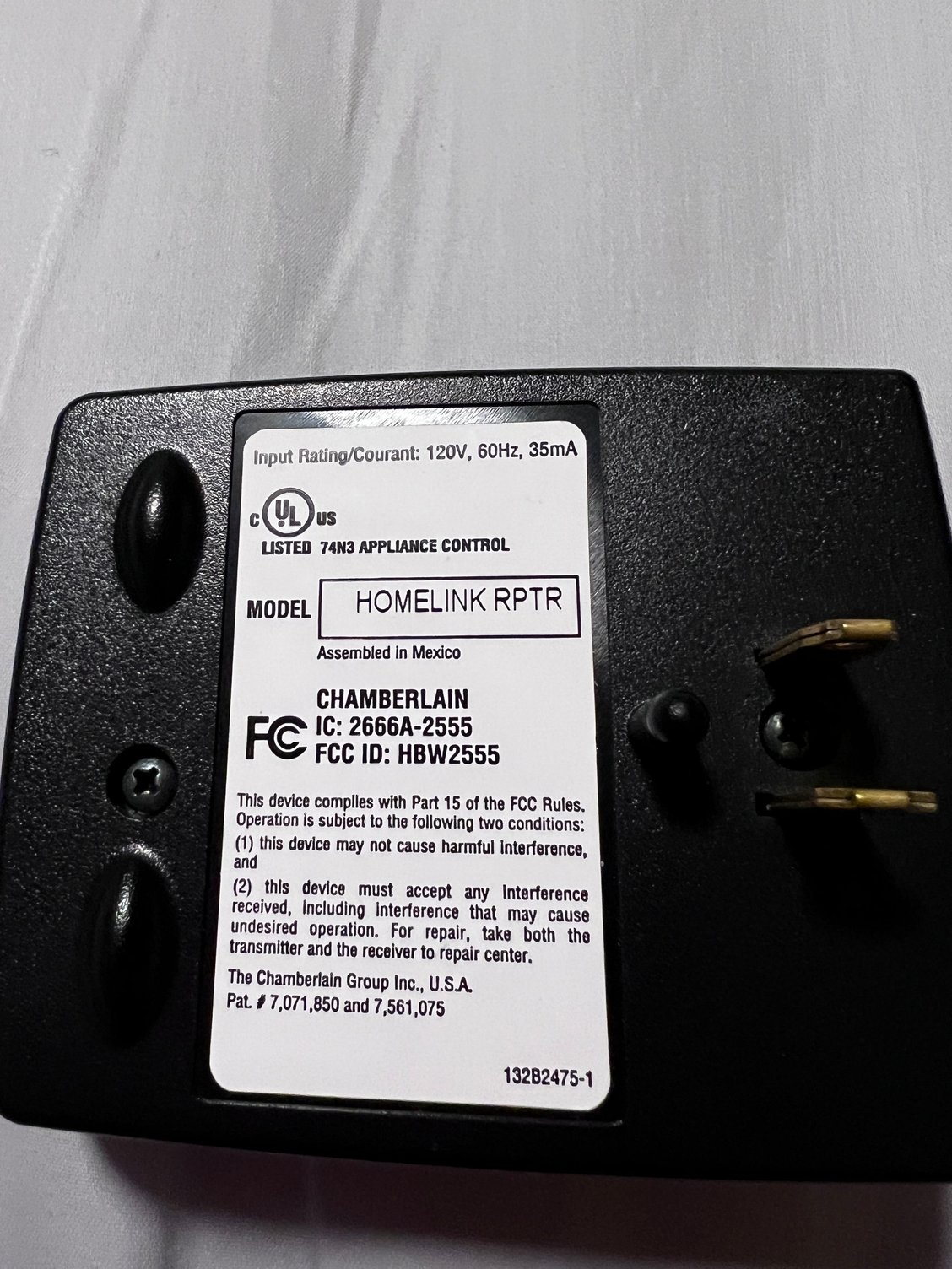

Default Garage Door Opener Repeater for XK compatibility
Originally Posted by ptaylor2000
I've tried to program the garage door opener. I've cleared the 'old' programs by pushing the two outer buttons until the center LED flashes quickly.
I've held the current garage door transmitter and pushed one button simultaneously.
The LED will eventually flash...but NEVER goes to a "rapid flash" sequence.
Any ideas on how I can get into this program phase?
For newer garage door openers… what works for my 2007 XK is a homelink repeater like the one shown in these photos.
