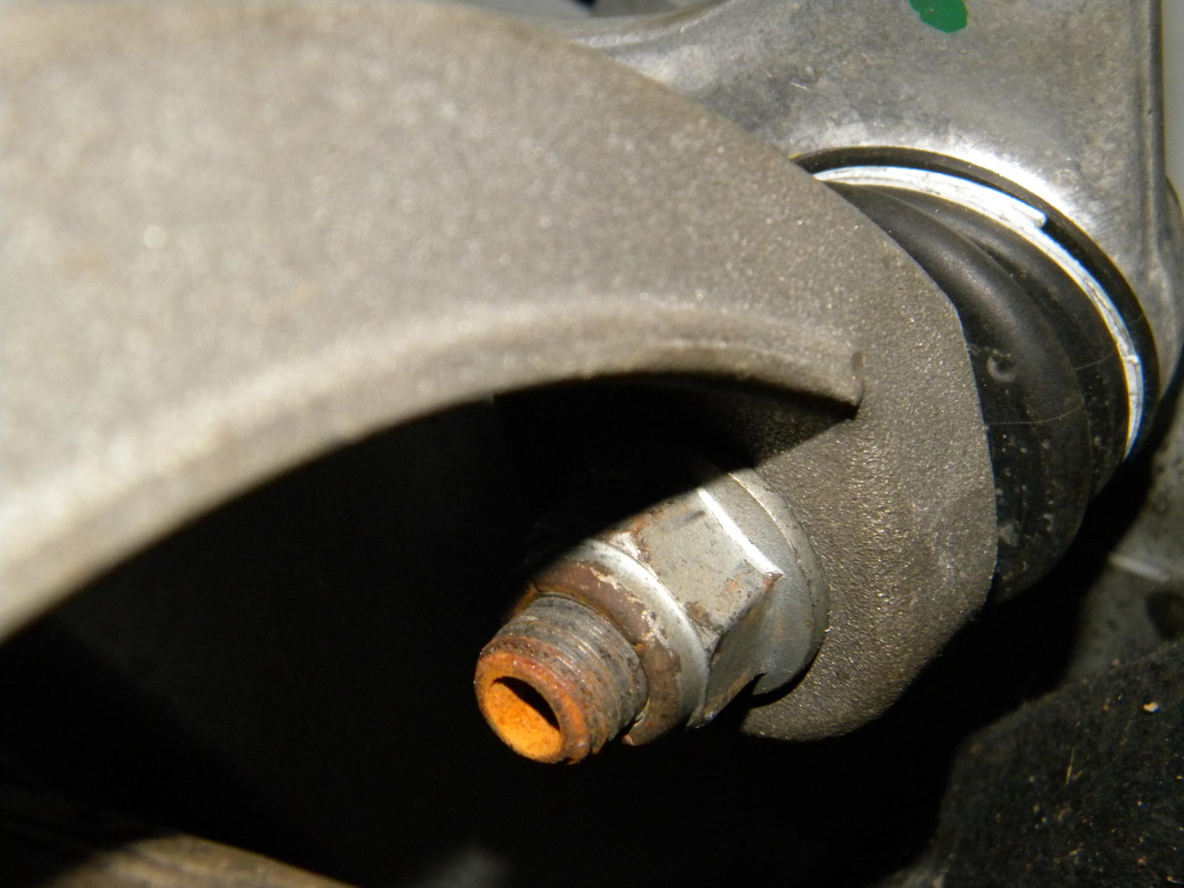

There was one single thing that I was concerned about before beginning the process of pulling the front strut/spring assembly and cutting the spring. It was the mounting of the upward curving suspension knuckle to the upper A-arm. The upper A-arm has a pressed ball joint. Those are known to spin upon slight loosening...
Yeap, that is EXACTLY what happened. All went well up to that point. Normally, I would use an impact wrench to spin off the fastening nut from ball joints but, in this case there was not enough room for either of my two impact wrenches. Thus, I loosened the 18mm nut with a regular socket but, as soon as the nut started turning, so did the ball joint bolt with it.
Looking at the parts picture, it appears to me that the ball joint shaft that the nut goes onto is straight cut instead of the usual cone-cut. Cone cuts get tighter with the torquing of the nut and that tightness provides the friction during the removal process. Who ever heard of using straight cut ball joint fitting???
I was stumped for a good while, trying all kinds of tricks to at least re-tighten the nut so I could drive the car. No luck, just a spinning nut and ball joint bolt. Finally, I decided to use my 4" high speed disc-cutter to cut a slot into the bottom of the bolt that hangs out below the nut. Using a short and wide screwdriver, I was able to apply enough counter-torque to re-tighten the nut.
I always hated spinning ball joints and, it bit me again today. At least the car is back to normal, torqued correctly. Have to think about how to proceed...

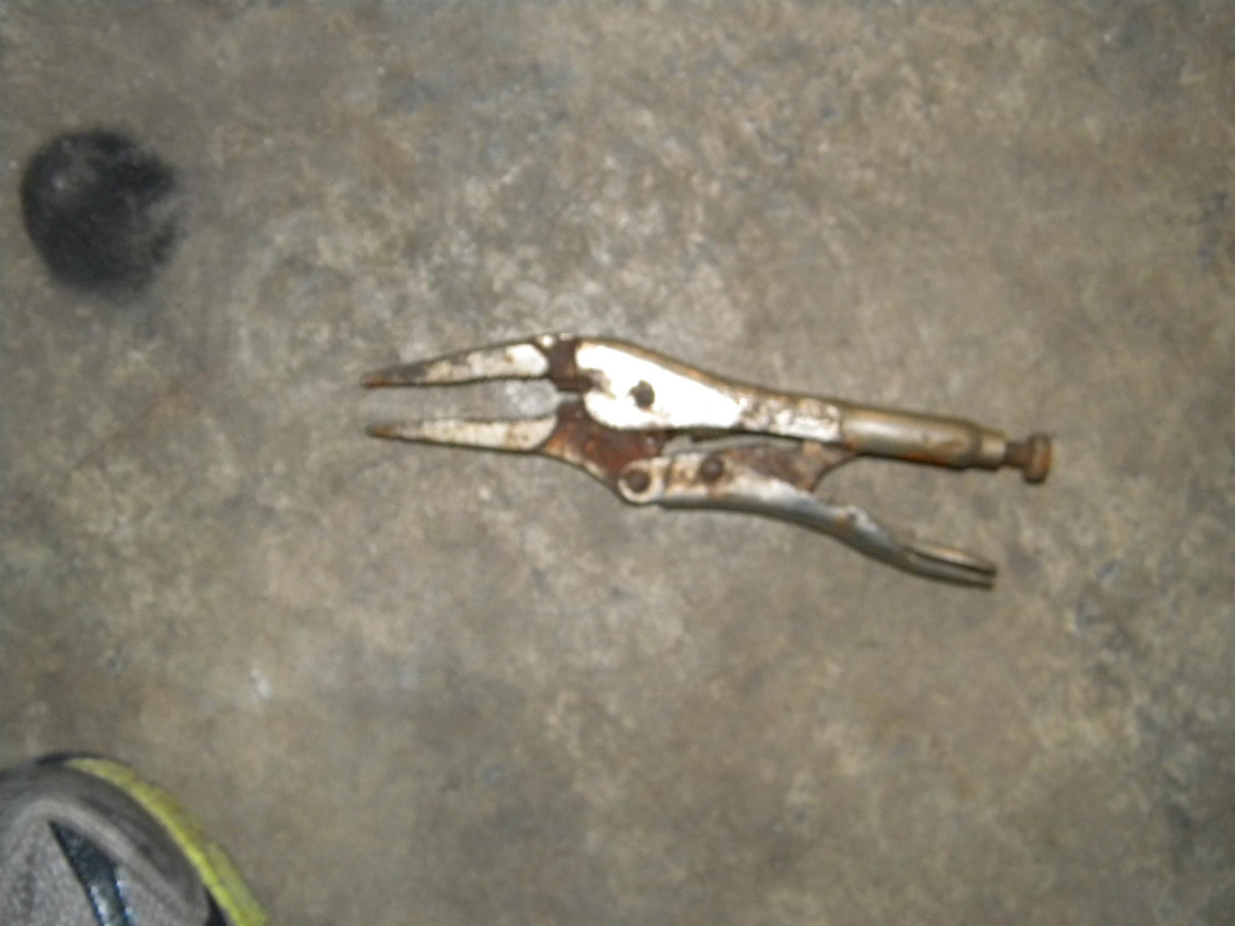

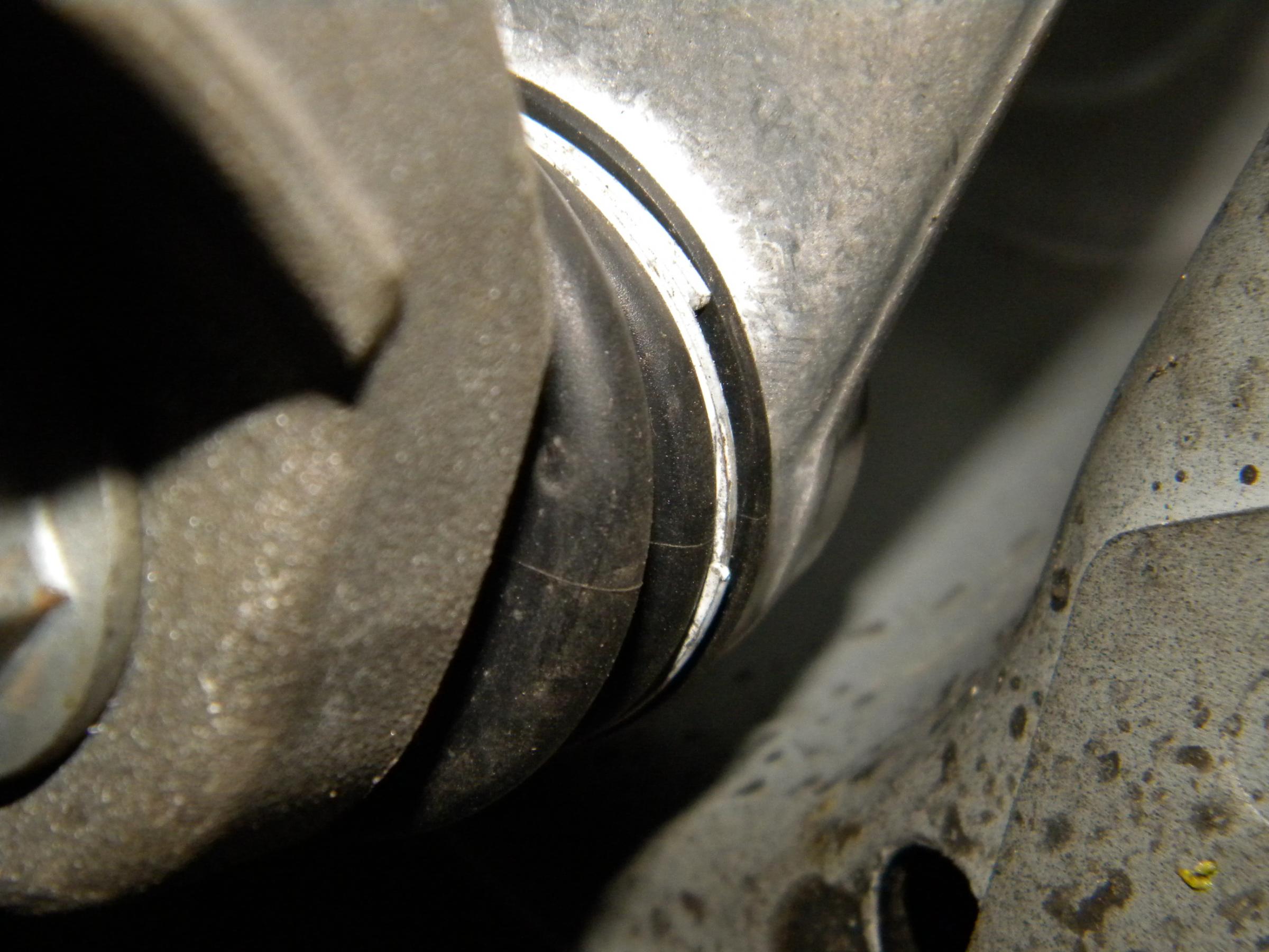

Please try the following:
The very top of the ball joint has a metal concave stop before the curved upper suspension knuckle. the stop touches the bottom of the knuckle
This concave stop, that is part of the ball joint is approximately 2.5cm round
This concave stop can be easily gripped with a long nose narrow vice grip
not much gripping force is needed
once you grip it, the ball joint wont spin again. you wont be able to damage this part of the stop. you wouldnt be able to press the vice grip tight enough to do that
DO NOT use a standard short stubby vice grip, you will just frustrate yourself, and damage the ball joint
my car is a 2013xkr convert. your car is no different
If you still have a problem with this, pm me and I will send a pic of the vice grip I use or we can do this on skype

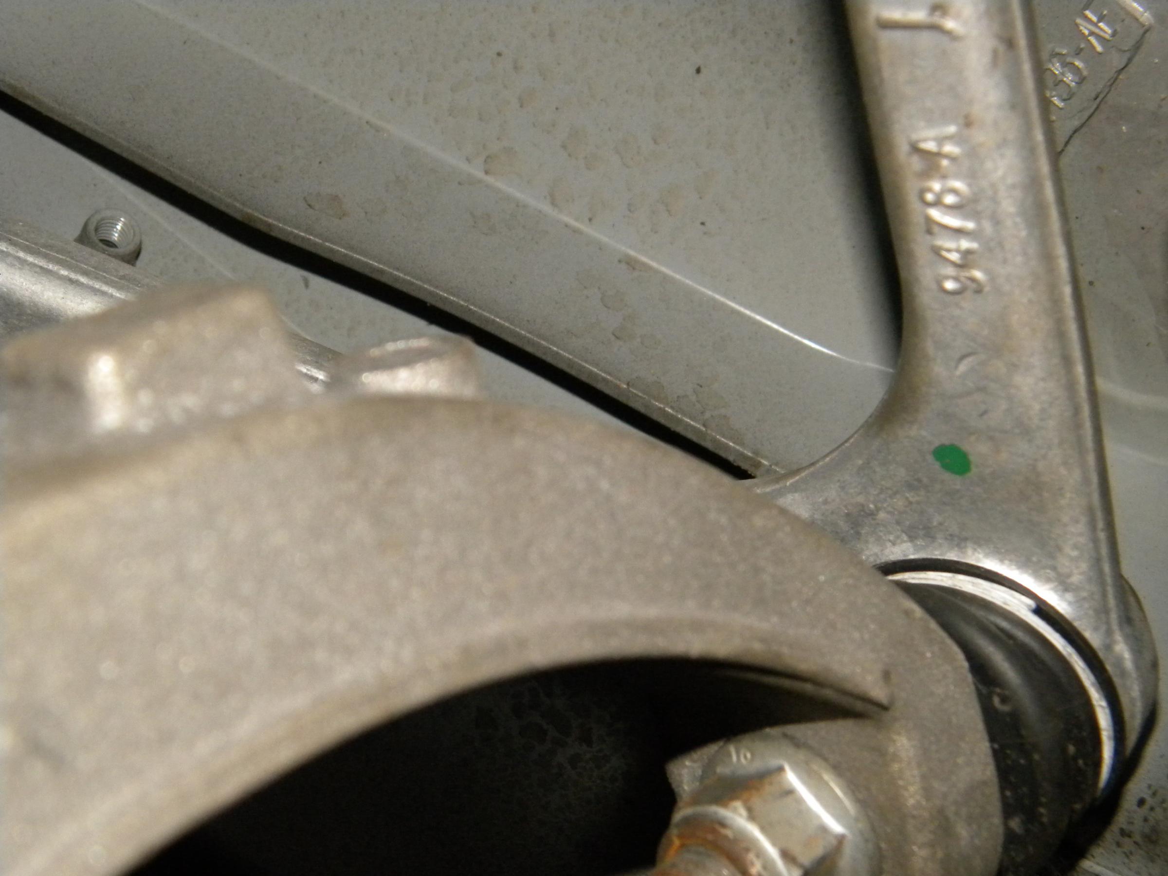

look at part 2 then the balljoint, then at top balljoint you will see the silver round line that you atach the picced long jaw pliers to. above that is the part 10. If you still dont see how to do this I will come out there and spank you for not seeing it my way!!!!
if it still doesnt work put a 2x2 piece of wood in between #2 and #10 to put stress on the nut to get it off
Doesnt matter what kind of springs you buy if you cant take it apart. try again, my way

WOW!!! SoCal Babe - You have gone through a heck of a lot of trouble to get those pictures just to help me out. I don't quite know how to thank you for your efforts.
After your threat, however, I do feel obligated to say that I still don't see it, just so that you could keep your promise and come and spank me. I provide the whips and the chains
Ok, Ok, I see it now. Does that mean, no spanking
