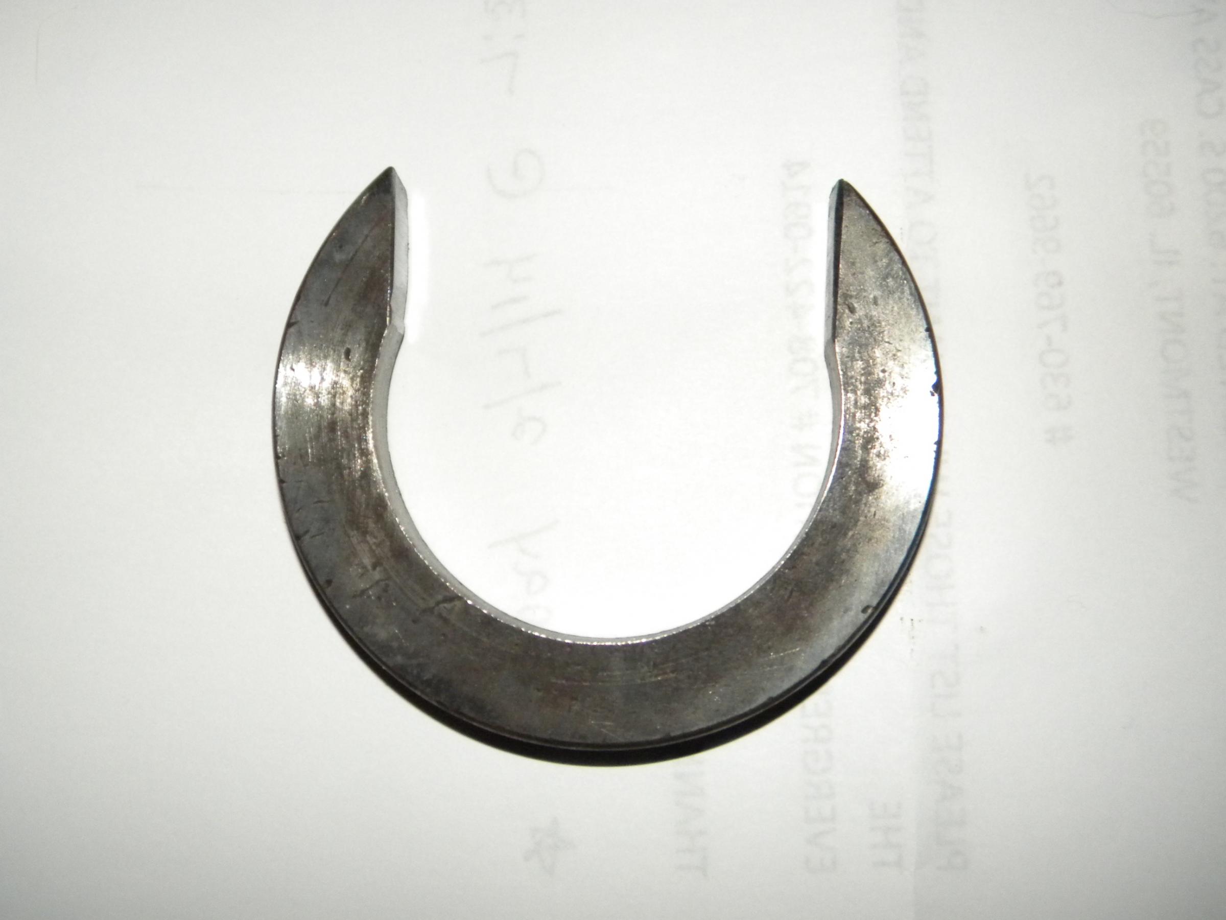

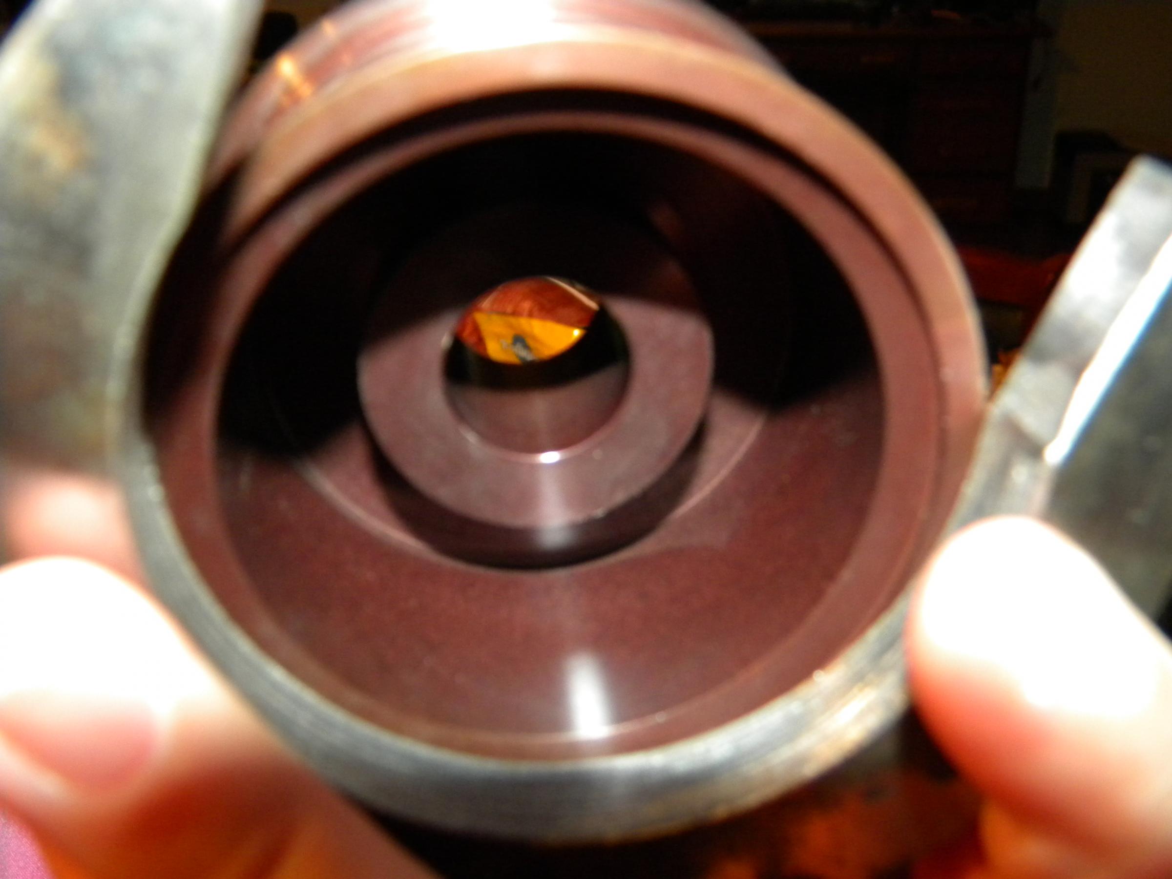

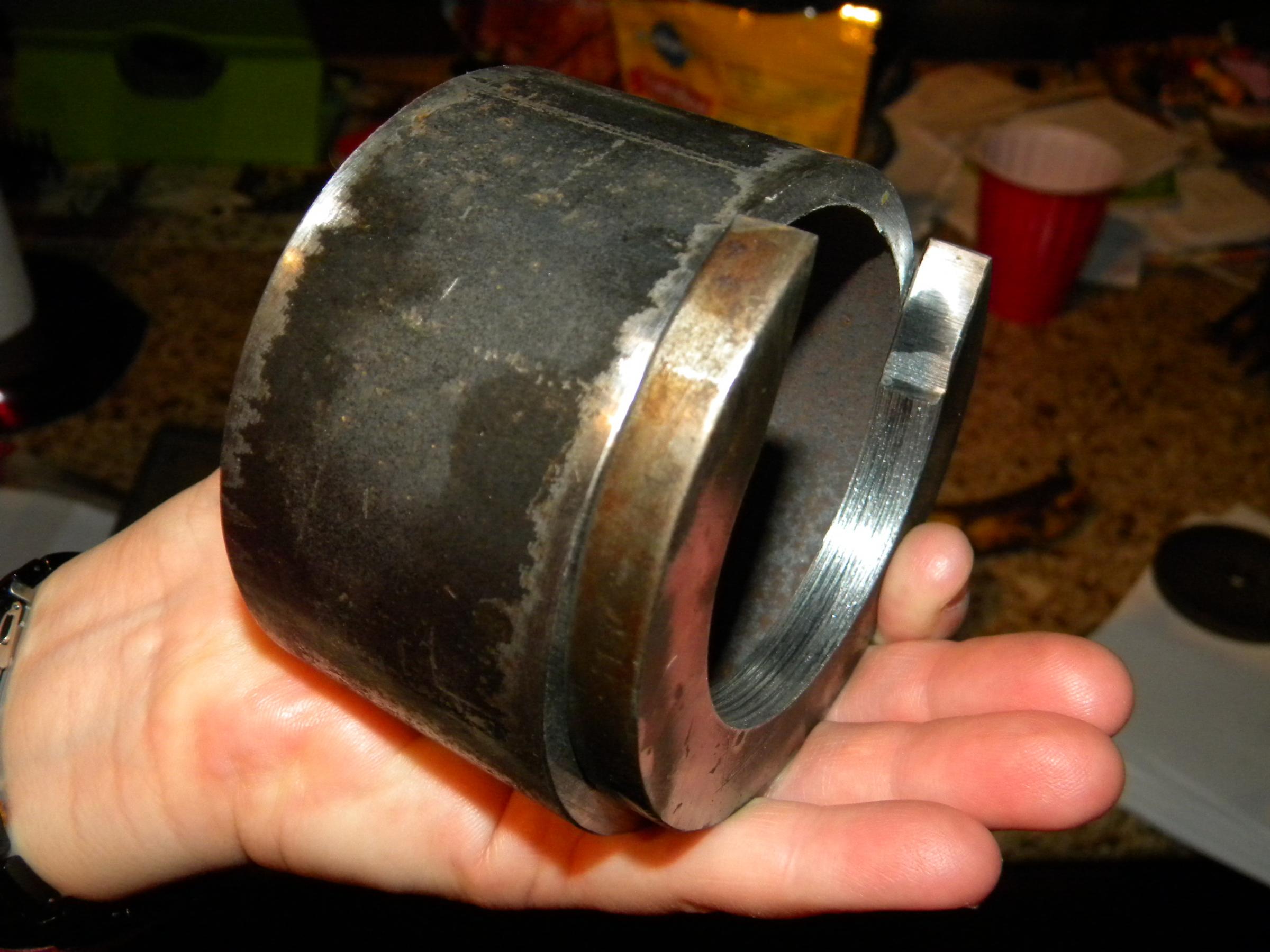

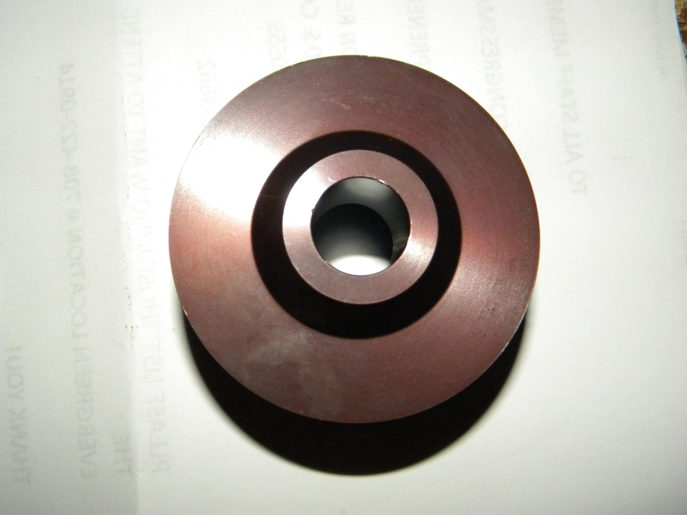

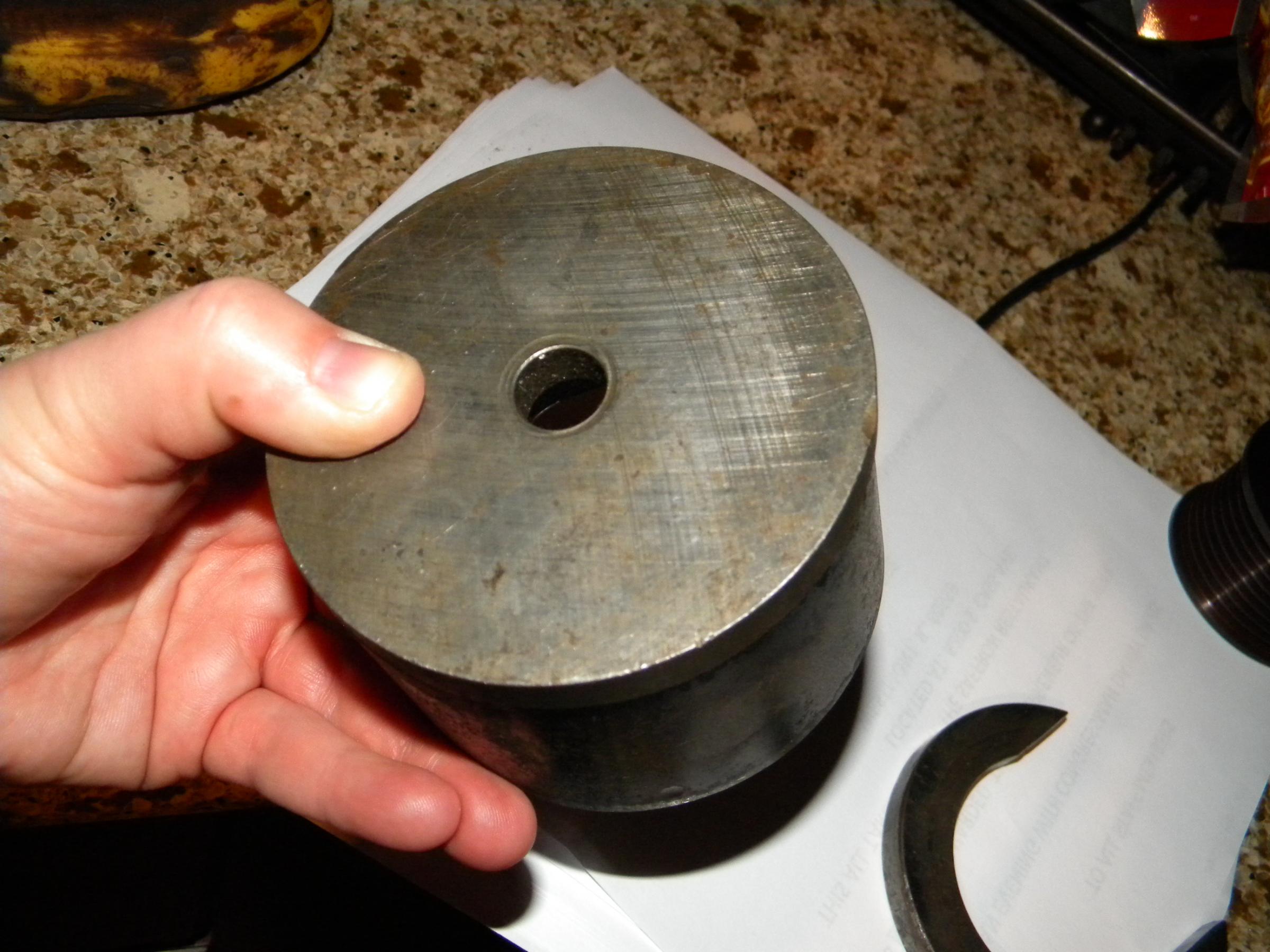

Hey DGL: I dont know how to send private pics so I m sending it thru the forum. I had my bf's cousin machine shop cut me parts to make a homemade pulley puller. 2 of my gf's bought a xkr and one has deposit on xkrs. I m making puller to help the xkr friend to pull off hers. Since I have to cut round circle in half I will have enough material to make a second puller. Chris at Mina said it needs to have 5 tons of strength to pull off pulley. My bf cousin said the backside of puller and front didnt start to warp until over 7 tons of force on a press. We are going to weld them up this week to make the puller. We are using a grade 8 bolt as the driver in the puller. so that should be enough. If you want you can have the second puller free as I wont need but one. My bf said he would be more than happy to hook me up to skype tohelp walk you thru pulling off your pulley. I will b able to give u distributor of the new "forever" tune tomorrow. If you want u can pm me back on how to get u the puller
