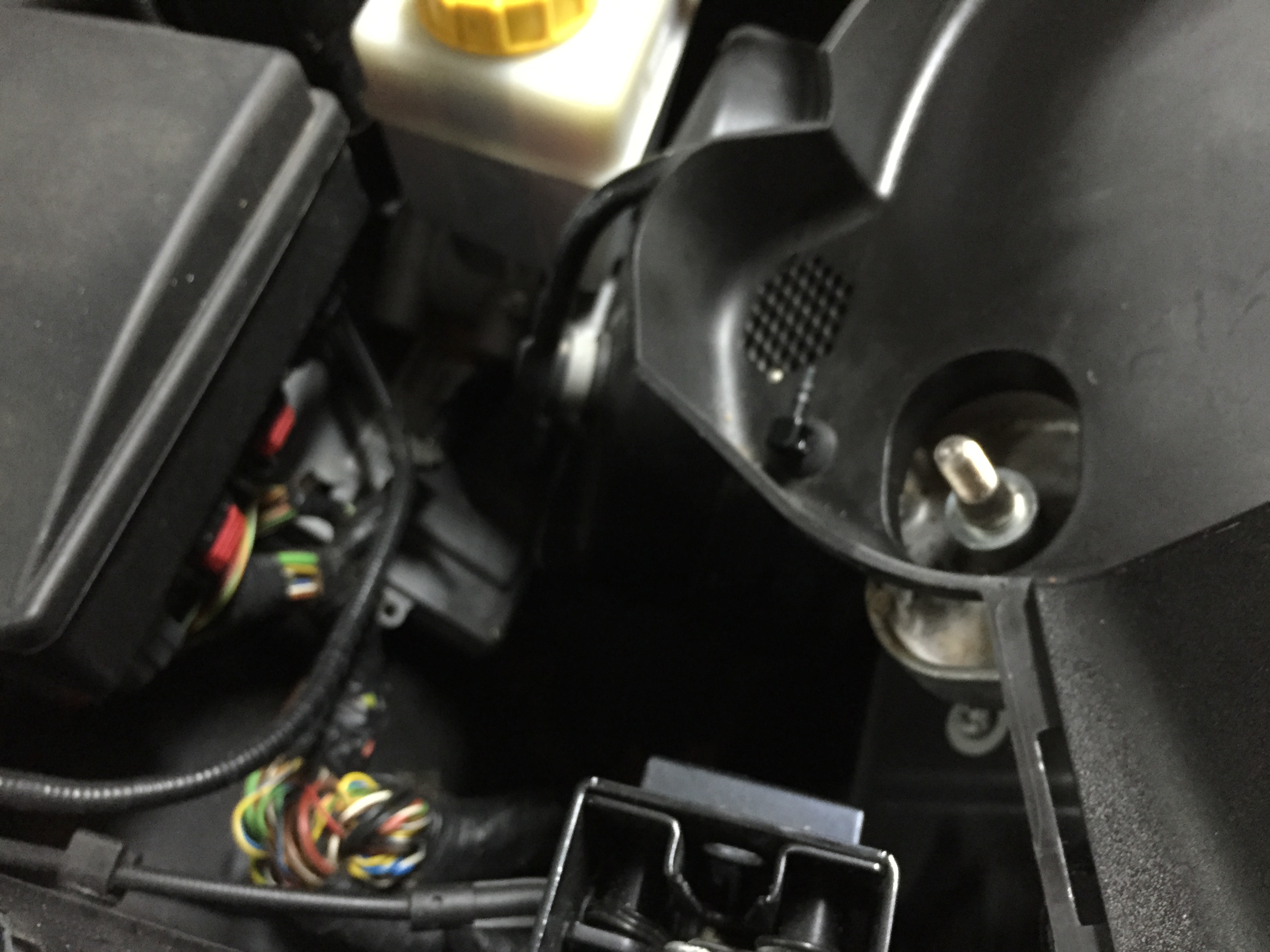

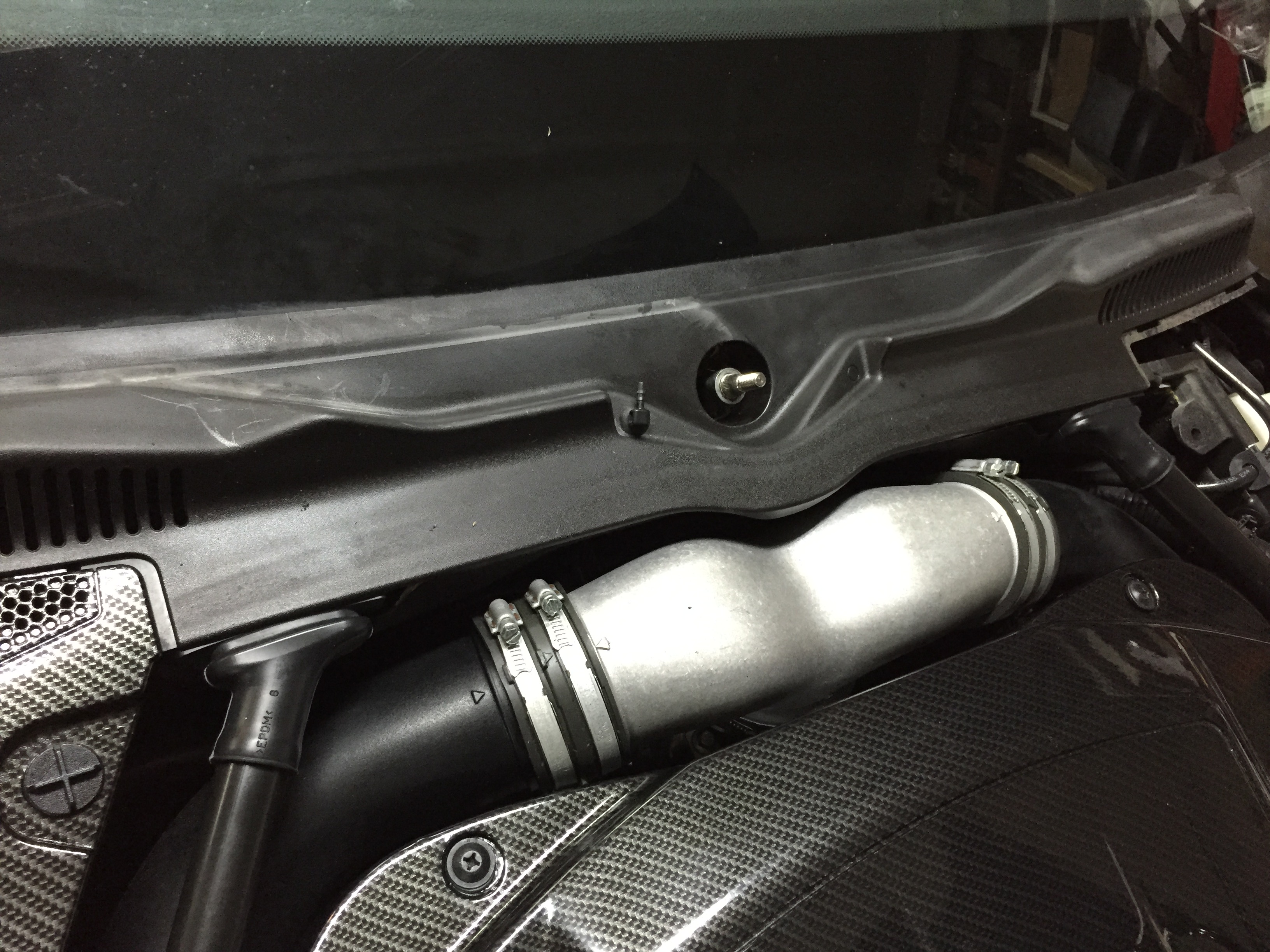

Hey Guys,
Wiper arm removal update....
After removing the cover cap and the nut (13mm), I gave the post a shot of PB Blaster and let it stew for an hour, or so.
Using a nylon pry and soft cloth, I applied light upward pressure while slightly wiggling the arm in different directions. Each broke loose after a little effort.
Thanks for your advice.
