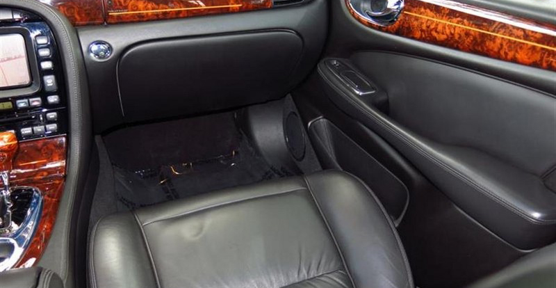

I find Lexol conditioner to be overly greasy and only use their cleaner from time to time. I prefer Blue Magic conditioner and cleaner works flawlessly and smells like new leather. It kept my Super V8 seats like new for 95k miles, literally soft supple leather and crease/wear free.
This is the driver's seat after 95K+ miles and the passenger seat.
