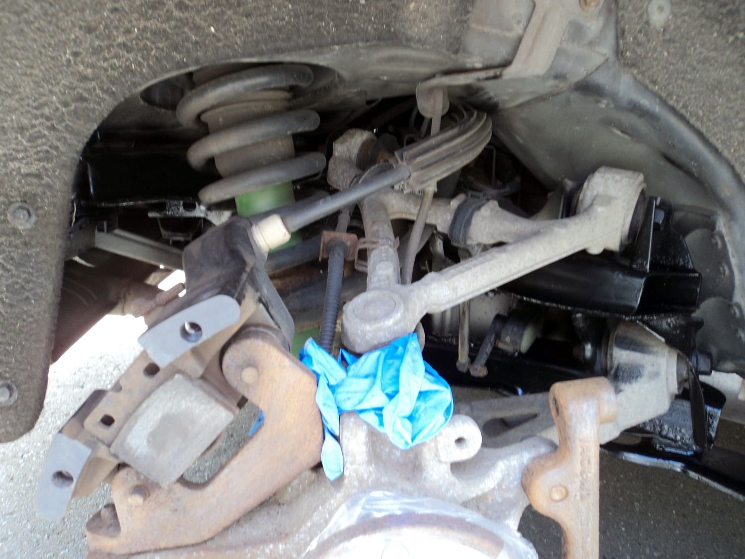

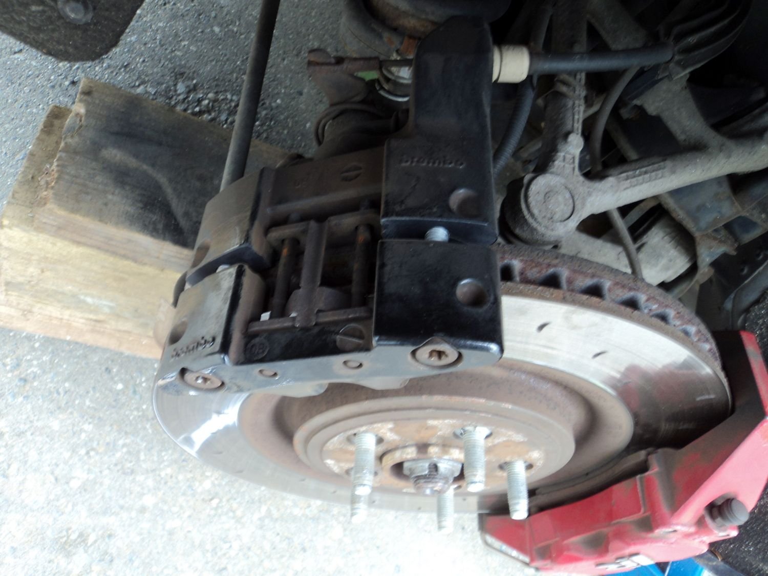

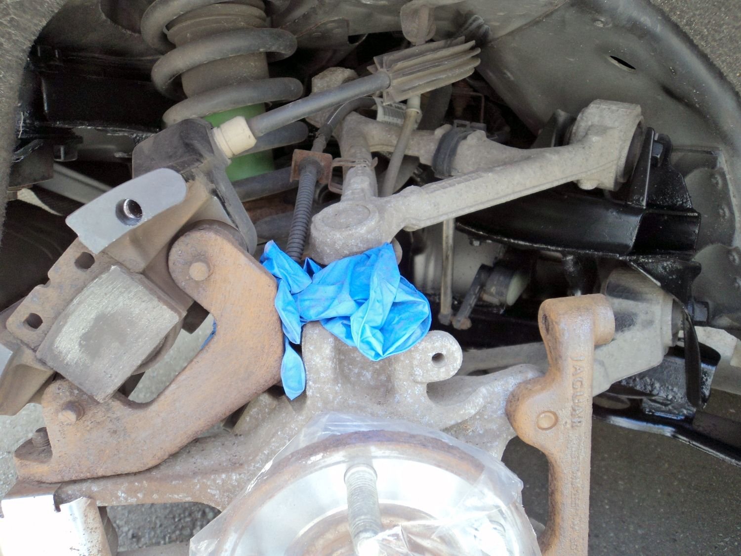

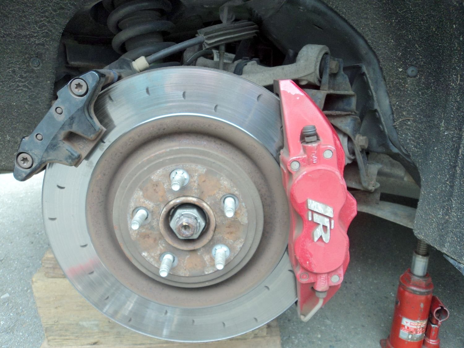

Can someone please post a picture of the Emergency brake caliper and bracket? The last step in the Alcon conversion is the R-brake. I’m getting an audible (annoying) audible warning… the only way it seems to get rid of this is to change the rear Hub and install the XKR tear E brake. Thank you
