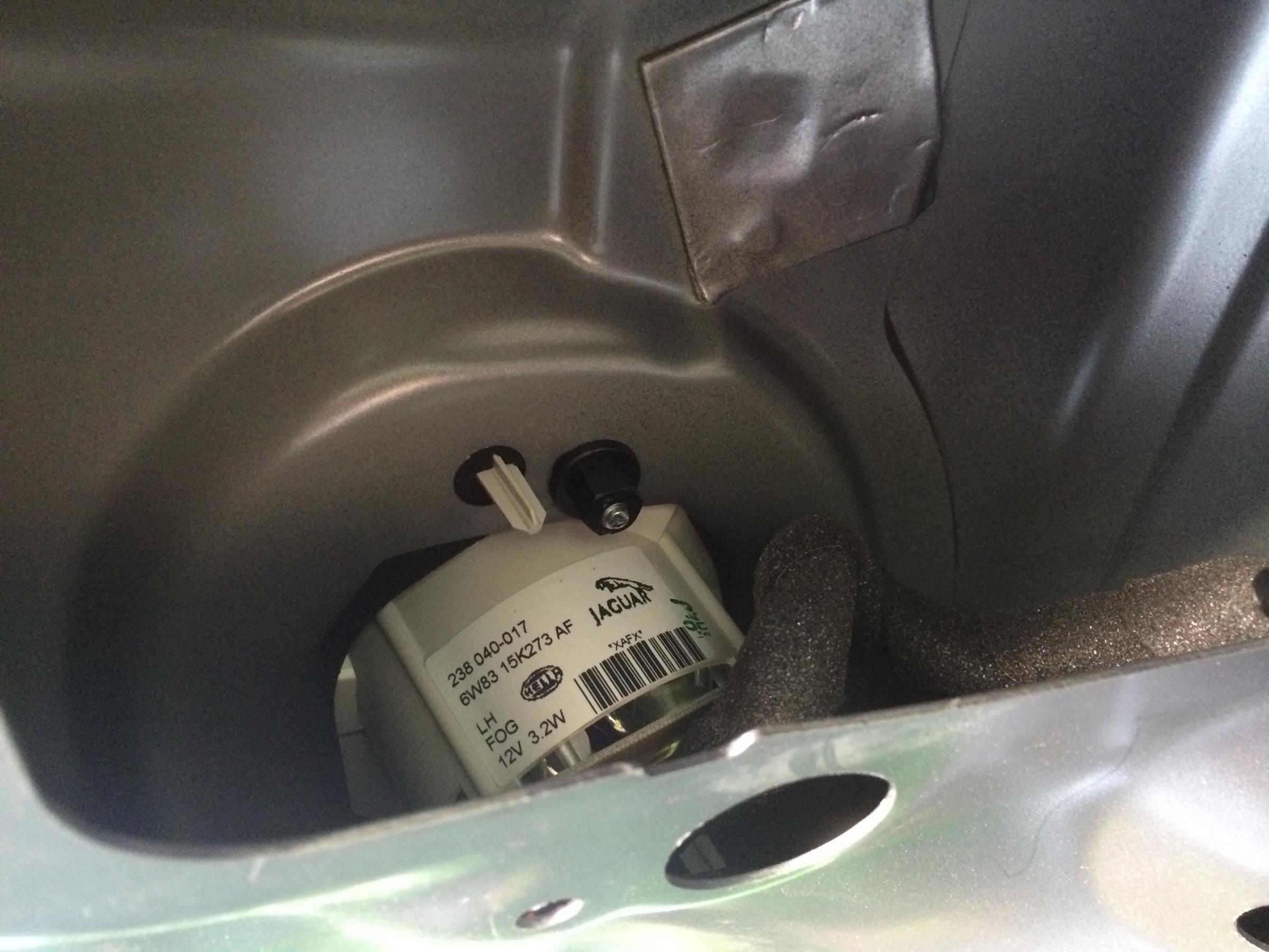

Hey guys, trying to remove the rear taillight assembly on my 09 xkr and am having a difficult time removing the cluster. I have removed both nuts but the assembly doesn't want to come out. At it's furthest point it just rotates into the body. The service manual indicates there is also a clip that needs to be removed. Can't seem to find it. Any help will be appreciated. Thanks in advance. Gary

If you are referring to the inner tail light there are 3 nuts, the third is located inside the deck and requires the removal of the interior trim and covers.
