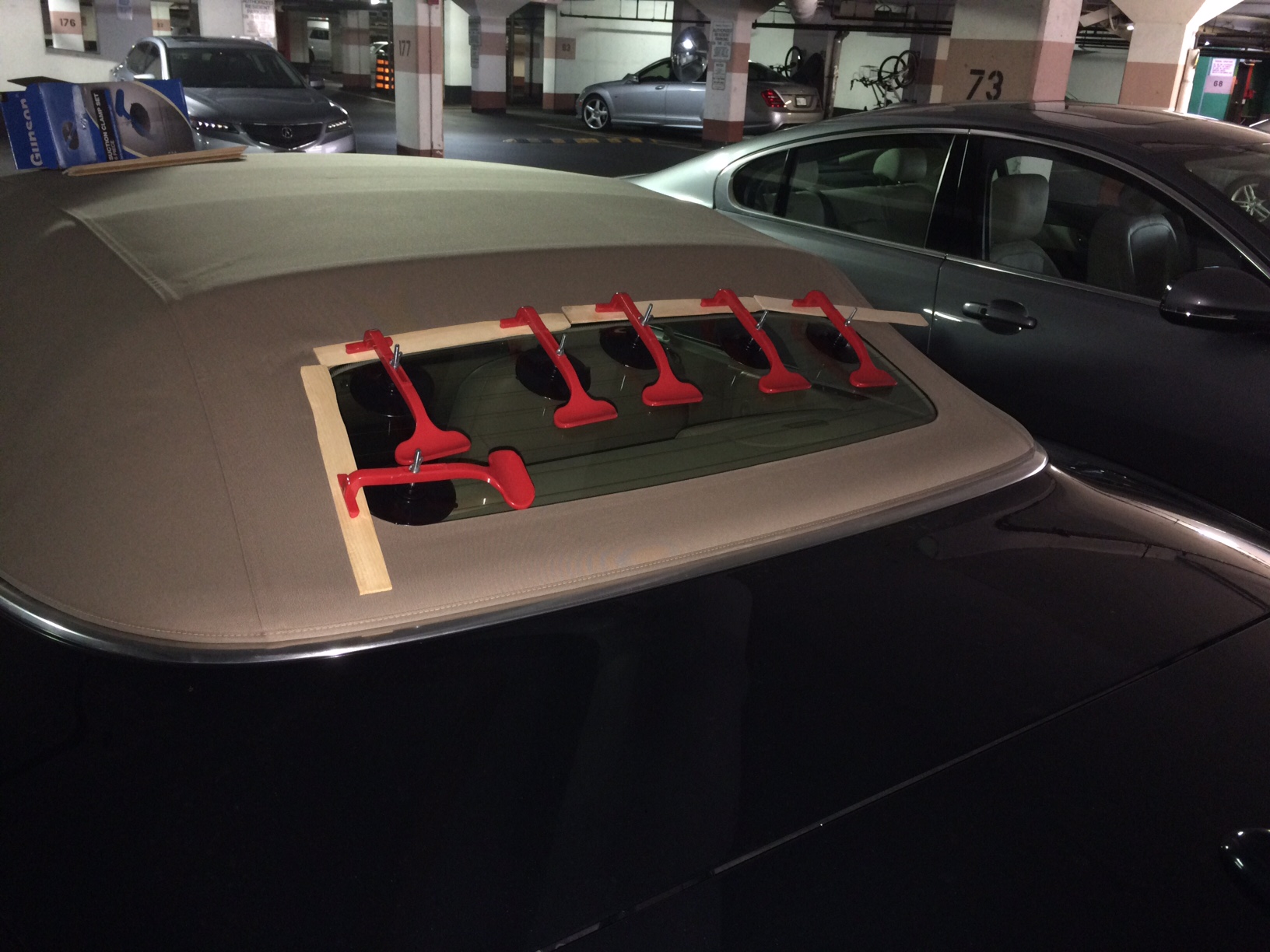

I took mine to a Speedy Auto Glass guy who had experience with this particular repair. Had to leave it with him for two days to allow the glue to cure properly. He said the problem is that the top material shrinks over the years,, therefore, there's less material to cover the window's edge, so it will never be as strong as the original factory job. Having said that, he also adds that he's never had anyone bring their car back for subsequent repair.
So far, so good.
He used these suction clamps in the process. (pics are from the internet, not my car)
Old Aug 24, 2016 | 02:04 PM
ndy.boyd's Avatar
Joined: Nov 2013
Posts: 476
Likes: 158
From: Toronto, Canada
This is a pic taken during the curing process, showing the aforementioned suction clamps and simple paint stir sticks that Home Depot gave me for free. After 24 hours, the window was like factory installed.
