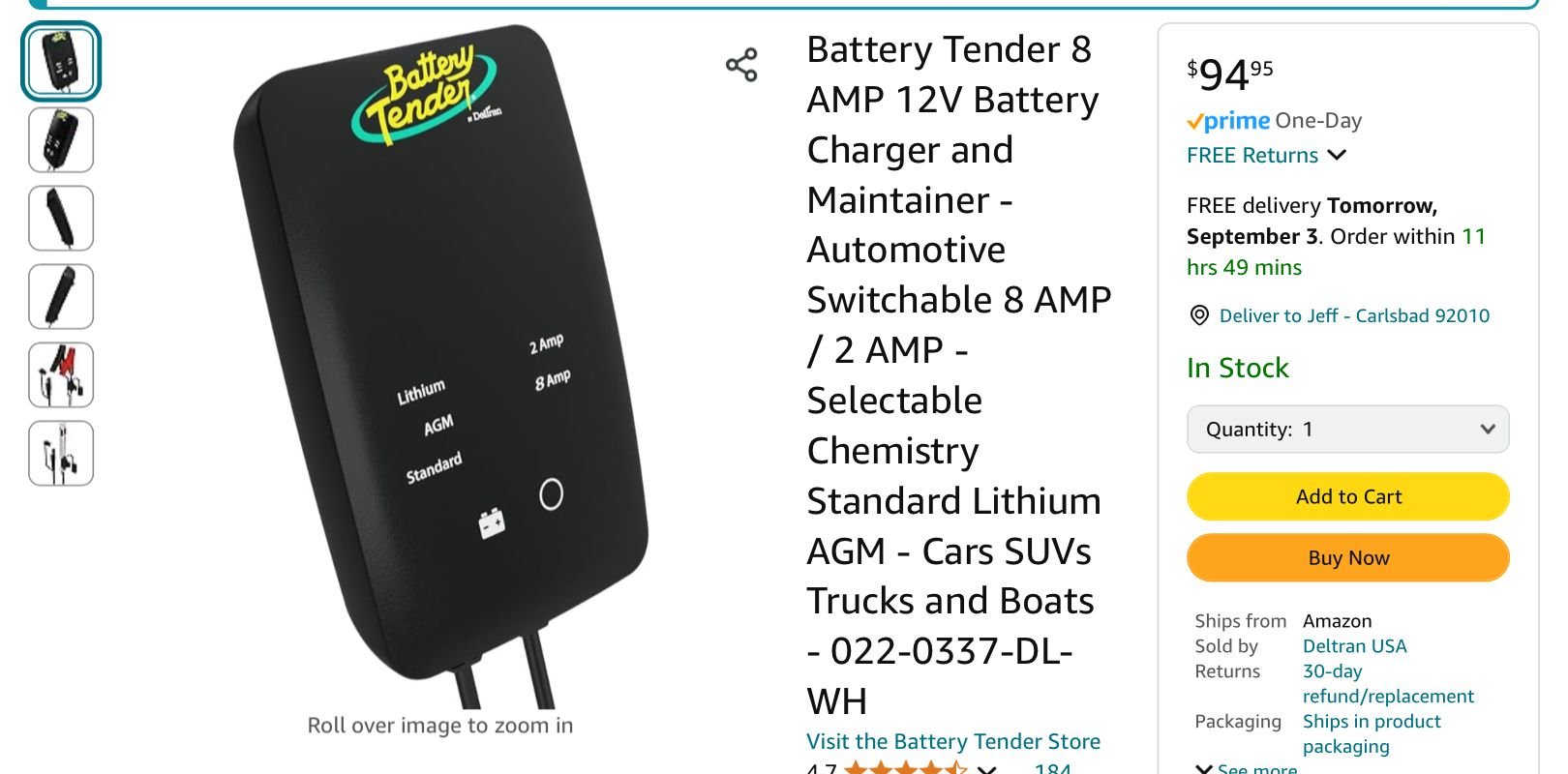

Over 700 people on Amazon found my Battery Tender review helpful. Read why I will never buy another Deltran product again.
I didn't get angry. I got even.
Warranty a Joke Warranty a Joke
