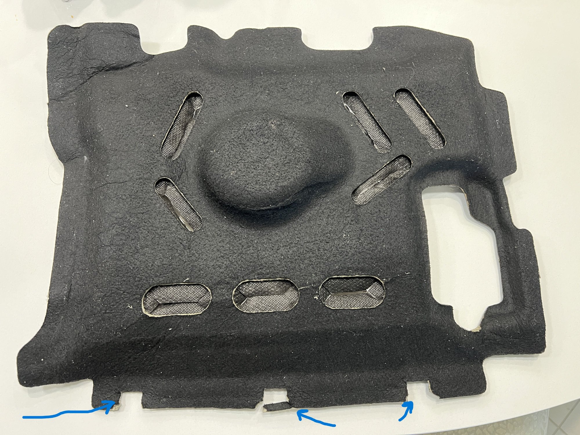

Has anyone had any experience repairing the Jaguar Insulation Panel Part # C2P17130 that sit under the Glove Box? As you can see from the pic, the 3 points where the retainer clips are used are all broken. I can use some advice on how to make a good repair.
Thanks,
Ken

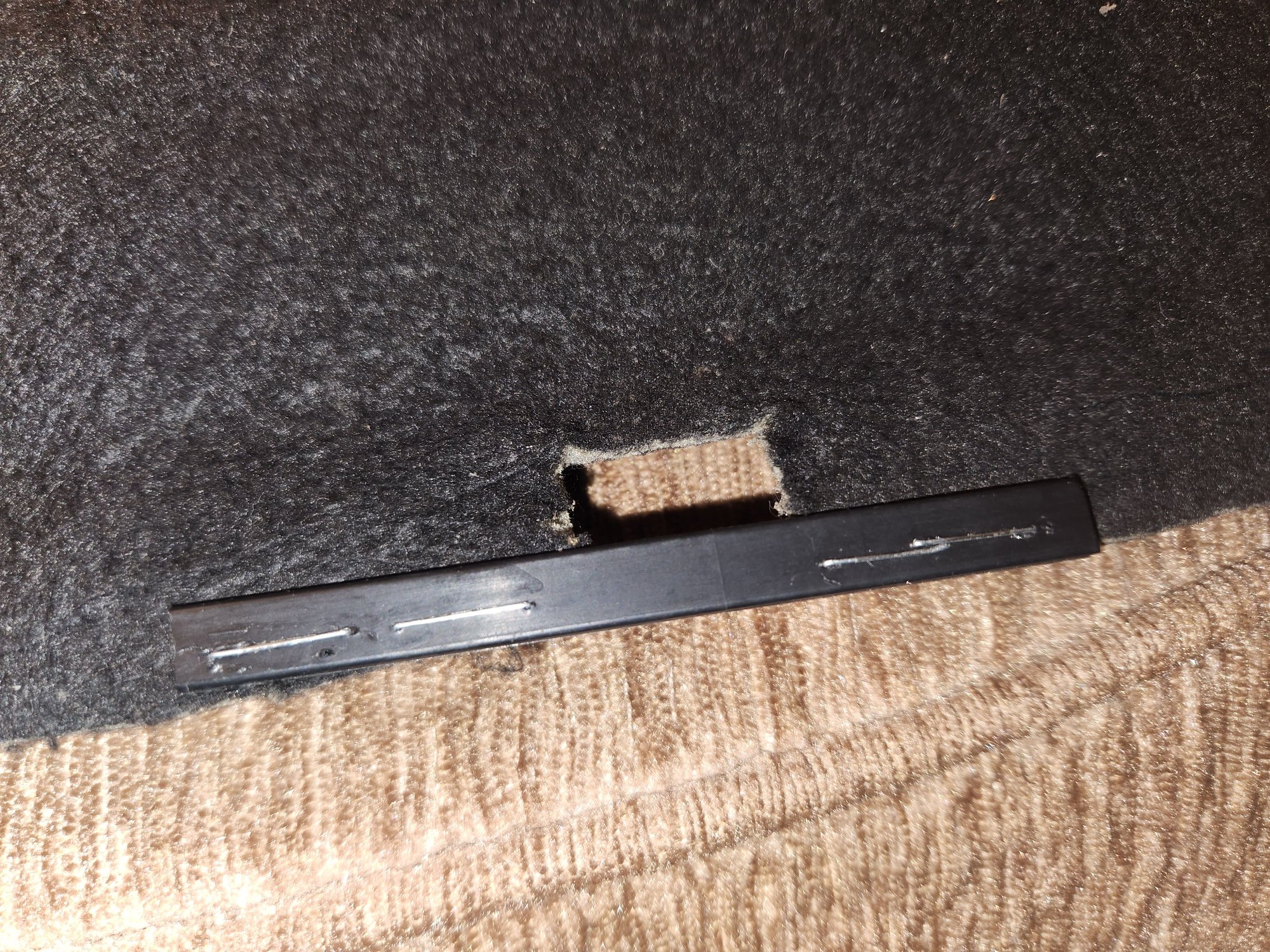

I just did this exact repair today. I found some thin black plastic and stapled it. no one will ever see it/

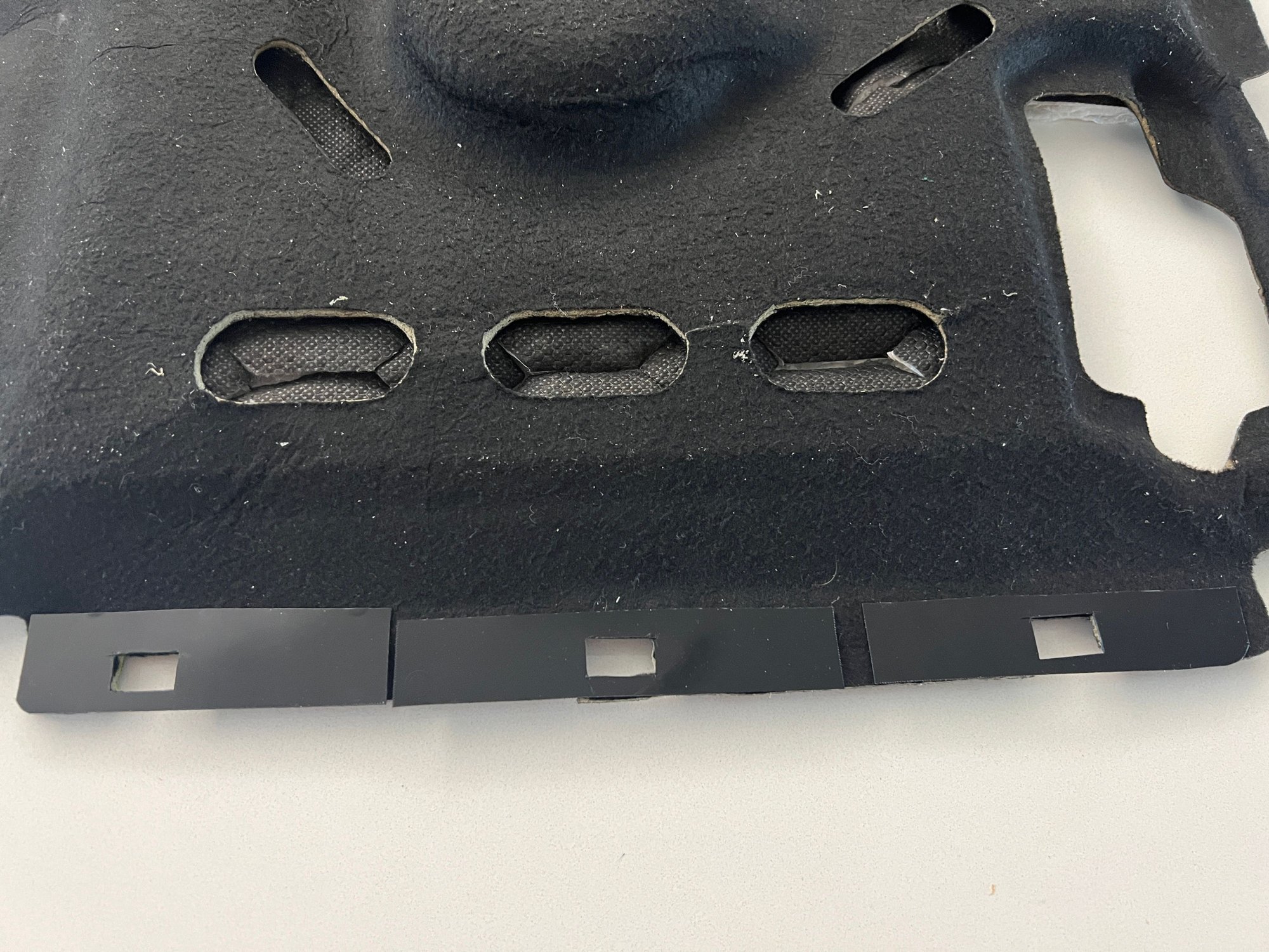

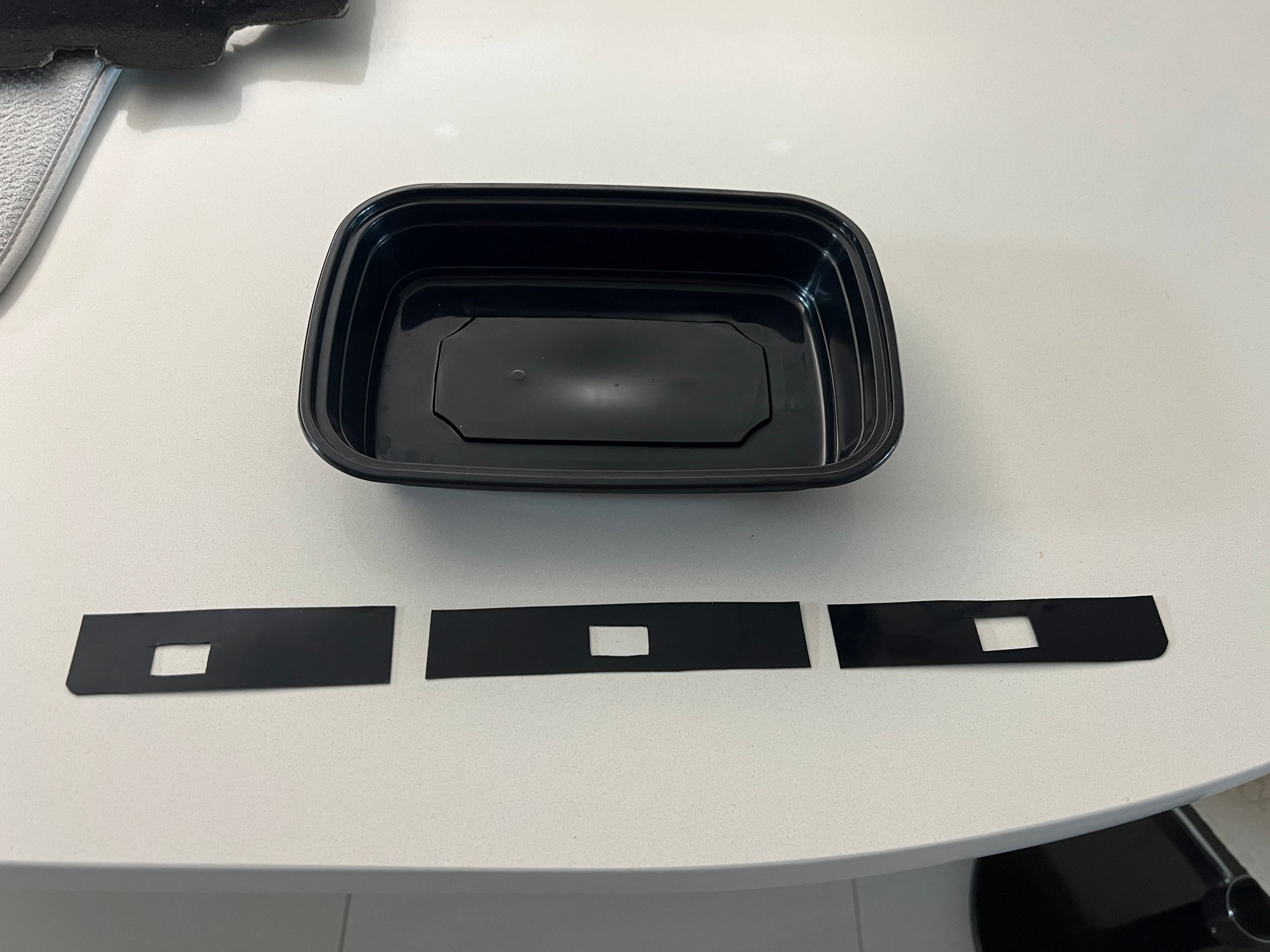

So here is how I repaired the piece:
1) I took a black "to-go" container and cut rectangular pieces to lay over the insulation. I left a spare piece in my car for the last week to see if the plastic would get brittle. I know it's a short period of time to test it, but we'll see how it holds up.
2) I then used some JB Weld epoxy to secure the pieces to the insulation. The JB Weld epoxy should hold up in high temperatures.
3) Finally, I put in some rivets to secure the plastic pieces
I hope this helps for future repairs.
Ken
