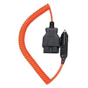

This one plugs into the OBDII port of the car whose battery you will change and has a coiled extension cord that plugs into the cigarette lighter socket of an adjacent car. Just make sure that cigarette lighter socket is on. Here's the link: Amazon.com: E-Z RED (EZRMSBD28) Auto Memory Saver: Home Improvement

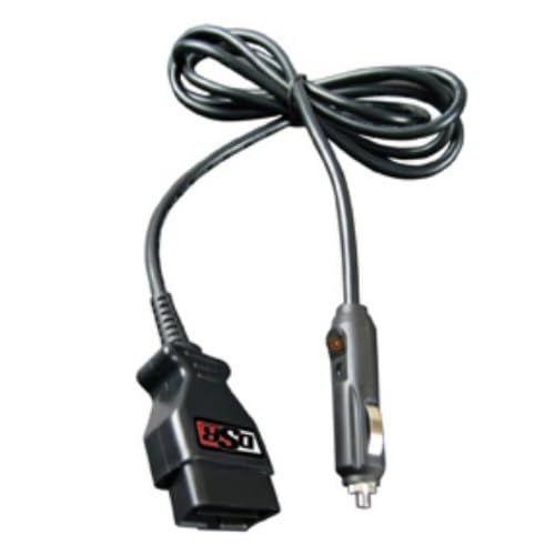

This one also plugs into the OBDII port but has a 6' lead to reach the other car's socket: http://www.amazon.com/Schumacher-INC...ref=pd_cp_hi_2
