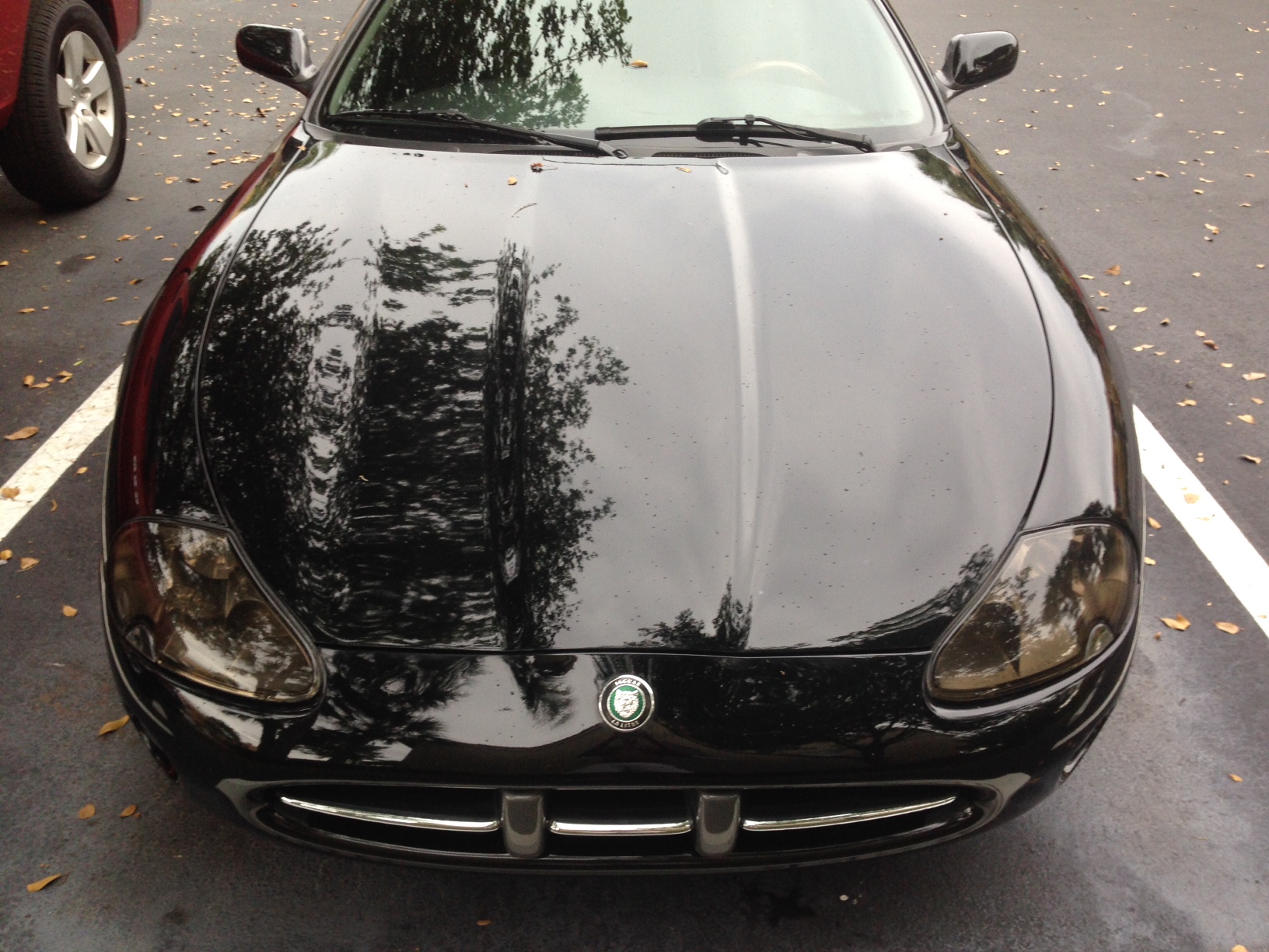

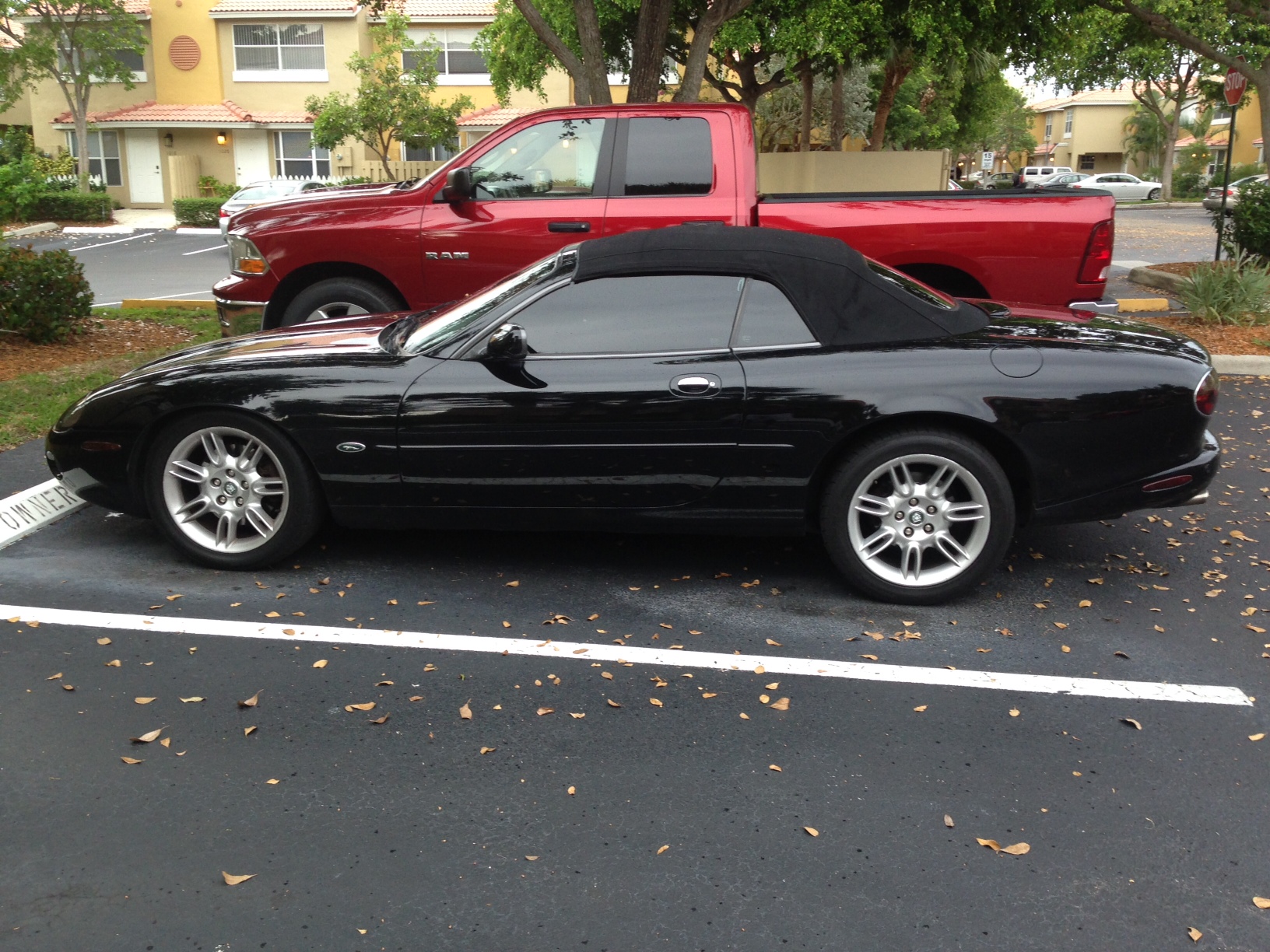

I just replaced the transmission on my 2002 XK8. The transmission put in was from a 2003 with 50K miles on it. Now I have had the car over three years. So I am very familiar with how it drove and responded. But I have to say driving my car with the replaced transmission it responds and shifts so much better than it ever did. Some may say its just a figment of my imagination. But it is like driving a different car. IS there ANY difference between the 2002 and 2003 ZF transmission? Or was the transmission just sluggish and worn and I didn't know any better. It really is an amazing difference. I love driving it even more. Just had it painted and the head and tail lights smoked. What a fun car to drive! Oh and also the Motor mounts were replaced because they were in extremely bad condition. Could the motor mounts make any difference to the performance?
