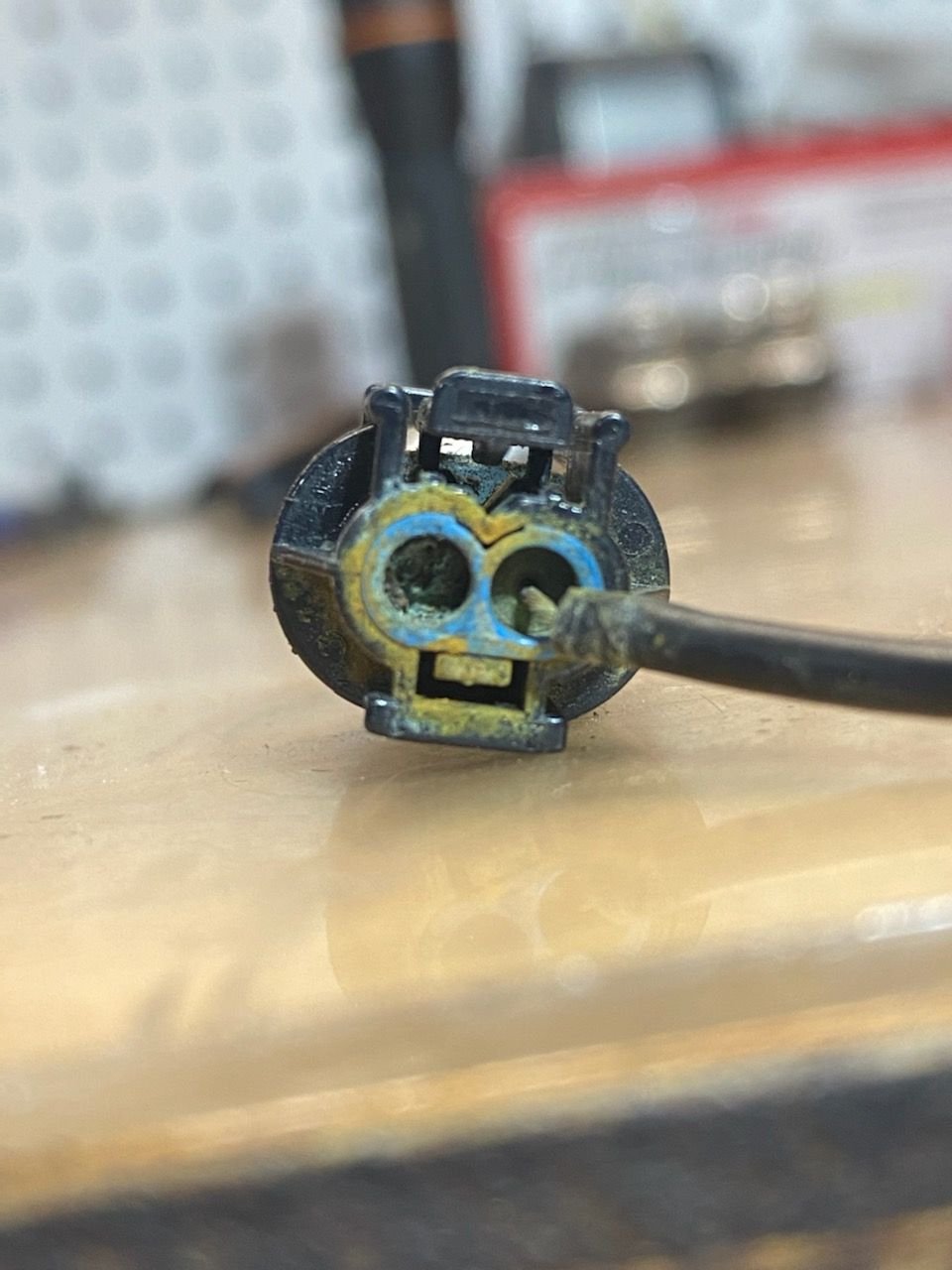

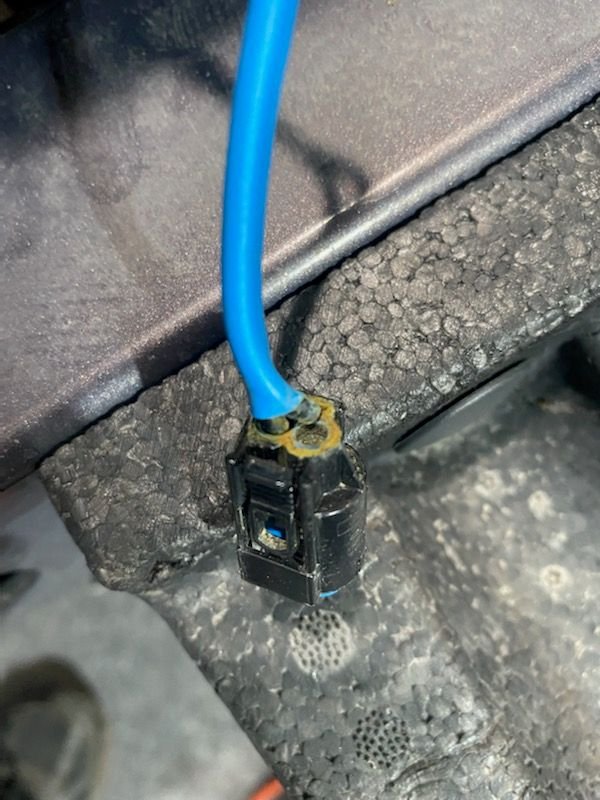

So I want to let everyone know its been a year since I installed the Bosch pump and I recently got the P2601 code on the highway.
Popped the hood and the intercoolers were very hot (they are normally cool). So either the fuse or the pump went bad?
Very disappointed if the pump is shot.
Old Feb 28, 2022 | 03:19 AM
  #36
Justtttttom's Avatar
Joined: Dec 2020
Posts: 44
Likes: 12
From: UK
I take it that the coolant level is still fine?
I'd buy a bluetooth reader and get the torque app and just monitor temps for a bit. Could just be a one off.
Old Mar 1, 2022 | 10:19 PM
  #37
gkubrak's Avatar
Joined: Jul 2014
Posts: 994
Likes: 710
From: CT, USA
Yeah thats the first thing I did... engine temps were fine, coolant level was good. Just the s/c cooling.
I did rig a 12v battery to the pump and it did run, so thankfully I wont have to replace it or drain the coolant.
Turns out the connector was fried. I pulled it off and the (+) wire broke right off. Not sure how that would be caused but I'll have to get a new connector and maybe some better wires.
It does sit right behind the grille so i'm guessing my weekly car washes were getting it wet.
