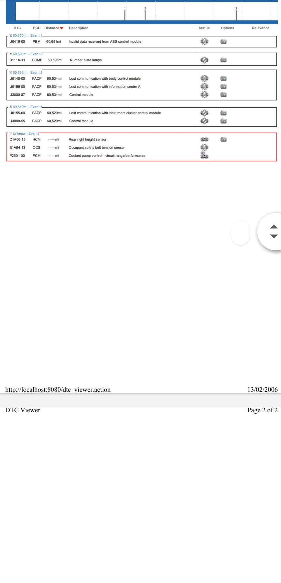

Hey,
Recent owner of a 2010 5.0 xkr on 60k miles in white. Love the car and seems to run sweet as a nut (most of the time!)
The other week I received "restricted performance". I'd be driving for approx 50 or so miles, stopped for an hour, then within 5 mins of driving again got this code and extremely sluggish performance. No weird smells, sounds, noises. After turning the car off and on again, issue had gone and car performed normally. I thought nothing of it.
Yesterday I had a similar journey, a bit over 50 miles, stopped for a bit, then within 10 mins of driving got the same issue again. As I was on the motorway, I had to drive for about 20 miles or so like this. Again, no weird noises, smells, sounds. Stopped the car and on restart, car was back to normal.
An amazing neighbour plugged the car in for me and the attached codes came up. Interestingly p2601-00 coolant pump control - circuit range/performance. I've just checked fuse 24 in the engine fuse box and the intercooler pump fuse is intact.
Before I get the pump changed, any other ideas on what this could be? I'd have expected the fuse to have gone if the pump had, and expected the issue to kick in sooner and more persistently.
(as an aside, any advice on other codes appreciated)

Those SC pumps are not the greatest. I would, along with several other forum members, suggest getting an uprated pump.
Someone else will be along soon to give you the brand and part number, and I will also probably buy one, install it after I get my garage furnace fully installed (a week, maybe).

I had the same on my old 2008 4.2 XKR. In my case the S/C coolant pump fuse was blown, I changed it and drove for a few miles then pulled it out, blown again. Tried a third fuse with the same result so concluded it was the S/C coolant pump. I ended up getting a standard pump from a breaker and replaced it myself which resolved the issue. There are other parts you can use from the likes of Bosch but none are direct replacements, they'll require some work on wiring, mounting and possibly plumbing to get working. If your car is standard as regards engine performance modifications and you don't live in a hot country then there's likely little benefit in an uprated pump anyway.

So yours does sound like it's failed. Try removing the engine cover, take it for a 20 miles or so drive and then check the heat in the engine bay; if the supercharger coolant pump has failed then the charge coolers will be too hot to touch. Normally they'd feel hot but not dangerously hot to touch.

From MY experience... those OBD 2 car problem codes DON'T LIE!!!!!!!!!!!Fix that issue and your car should be working fine again.

Thanks again, chaps. Part on order.
Decided to give the AVT pump a go. Seems a copy of the Bosch, with reportedly better performance. They seem to have a few happy customers from aftermarket cooler system scene so will see how it goes.
