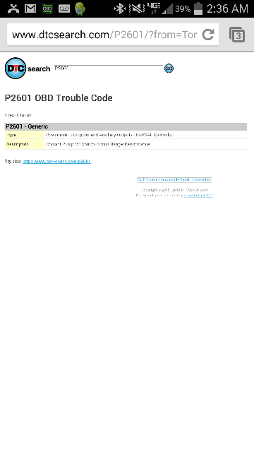

Got error code P2601 last night after a number of hard runs. Car went into "Restricted Performance" mode 3 times over the course of 3 hours. Everything was fine each time after it reset. The language is a bit vague on the code so wondering if it means the engine got "hot" or if there is something hardware related than requires repair. Any guidance would be greatly appreciated.

Kyanite, it isn't so much that your engine got hot, but your supercharger got hot. Doing a little bit of reading, it seems Land Rovers are suffering from a condition that the cooling pumps for the supercharger cooler is wired backwards from the factory which then causes the pump to push against the normal flow of coolant. So, at light throttles, there is enough flow through the supercharger cooler that things are within normal range. But, you start getting on the gas harder (ie, long, hard pulls like you were doing), the heat will build up and cause the temps there to exceed a limit. You can look up "LTB00041, Rev 2" for a bit more information. In your case, it can possibly be just that the auxilary coolant pump for the supercharger is getting weak and isn't flowing enough. Could be that the fuse blew for the pump and it simply is not aiding the coolant flow like it should.
Hope this helps in getting to the root of the problem.
