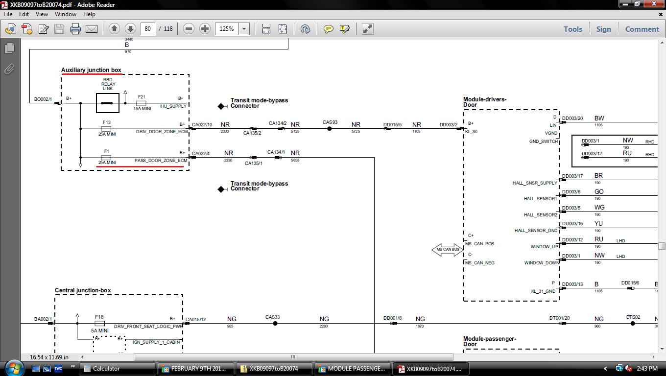

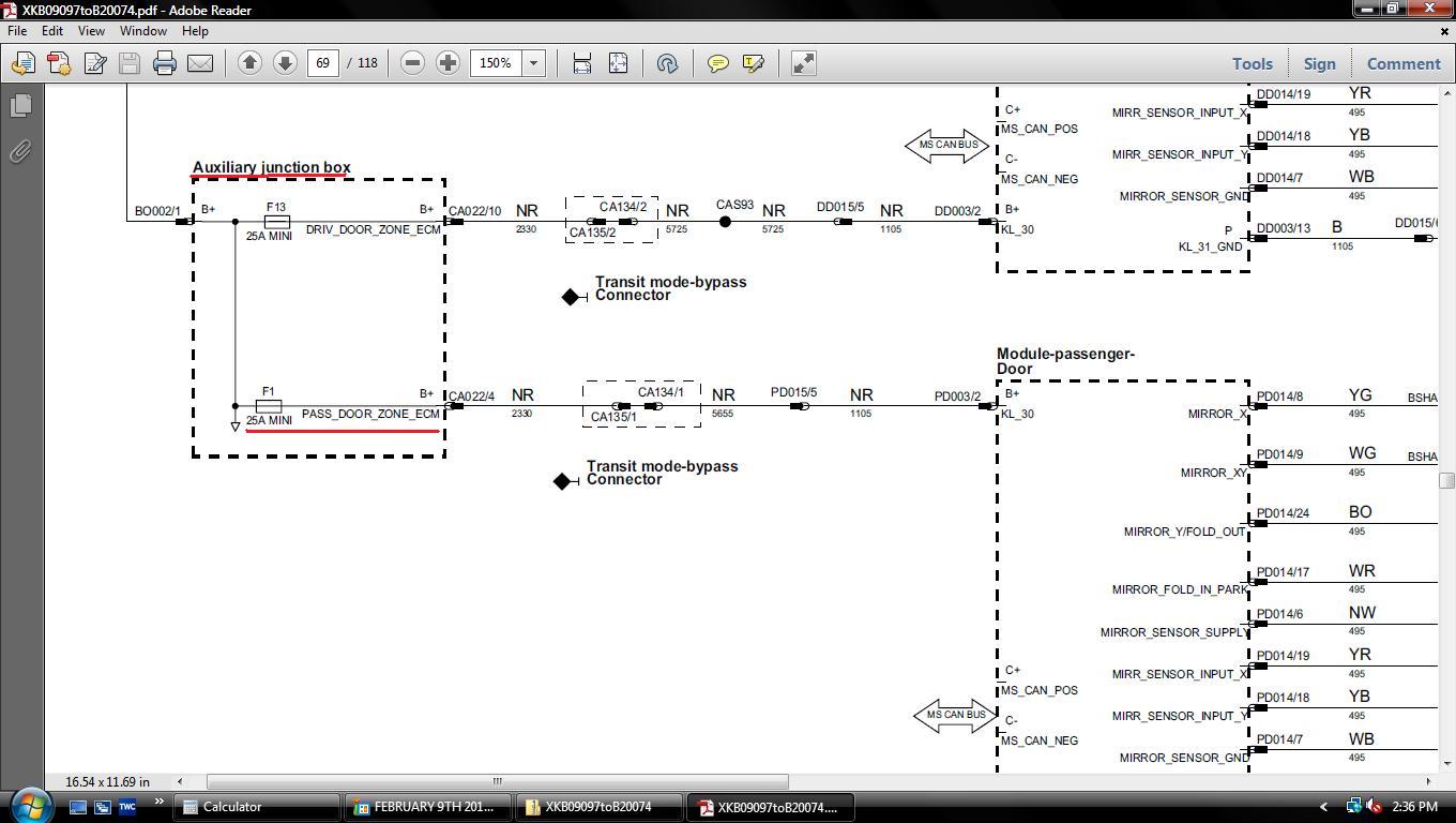

There is a module for the passenger window and another module for the passenger mirror.
Both are fed from a 25a fuse in the auxillary fuse box behind the rear seats (remove the middle pad b/t the rear seats and it's staring you in the face.
That's how it is on a 2007 non supercharged XK.
Drivers handbook shows how to remove the pad b/t the rear seats to access the fuse box and the same book shows the location of the fuses.
Fuse name is : Pass Door Zone ECM
Engine runs, alt puts out.......feeds battery buss........which in turn feeds Aux fuse box and its fuses. No low batt involved.
Shoulda said Auxillary junction box instead of aux fuse box. Oh well.
Attached Thumbnails Rightside Mirror and Window not working-module-passenger-door.jpg   Rightside Mirror and Window not working-passenger-window.jpg   Rightside Mirror and Window not working-pass-door-zone-ecm.jpg

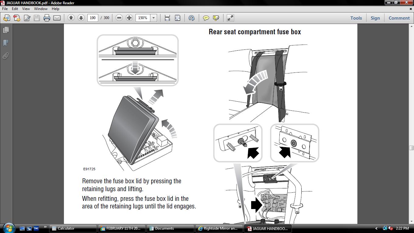

JPGS Show how to access the Aux Junction Box.
Just drive the car or idle it for thirty minutes. If the batt is worthwhile the thing should be charged up enough for anything. If this car has had no problem starting up, then I say it isn't the battery. I've a batt put in 05/08 and have no battery problems.
If the fuse is blown........then there's probably something causing that. But what the heck, put a new fuse in and have a go. Or if it's blown, then look at the Door Zone ECM fuse and swap 'em out and have a go.
Move the drivers seat all the way fwd and then tilt the drivers seat full fwd. That gives one room to get in the back and grab the pad b/t the two rear seats with both hands (like the Owners manual says I believe). Grab it near the top six inches on both sides. Make a sharp yank fwd. It should release, then you LIFT UP about six inches to fully remove the thing. Aux fuse box is now in full view.
