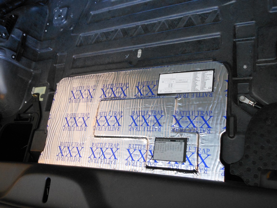

Not only may the tires be a problem but road surfaces as well. I own a new 2015 Corvette C7 that had Michelin run-flat tires. I scrapped the run-flats, sold them to another Corvette owner and replaced them with 19" & 20" Continental Extreme Contact DWS 06 tires and it made a difference in the amount of sound in the cabin.
I also installed "Fat Mat..Rattle Trap Extreme" in the rear cargo area and bulkhead in back of the seats which made a real difference.
Don't blame just the tires. The infrastructure of American roads and highways are terrible and need of repair at best.
Here's my install of the "Rattle Trap Extreme Sound Deadener".
This is in my 2015 Corvette C7. I have not completed this in my 2009 Jaguar XKR as of yet, but am considering the product.
