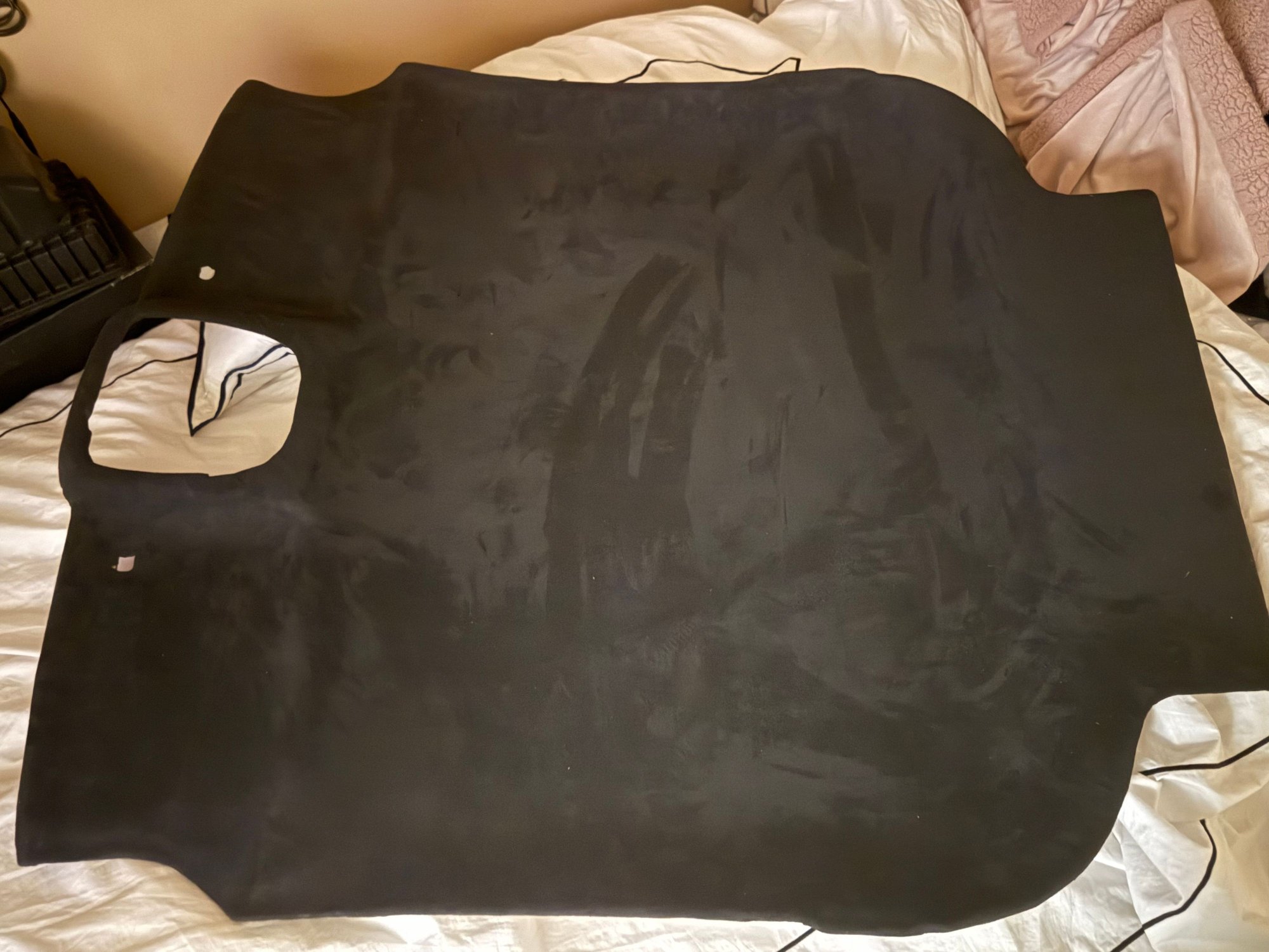

Well did it all except the visors!
Jet black from fabric empire

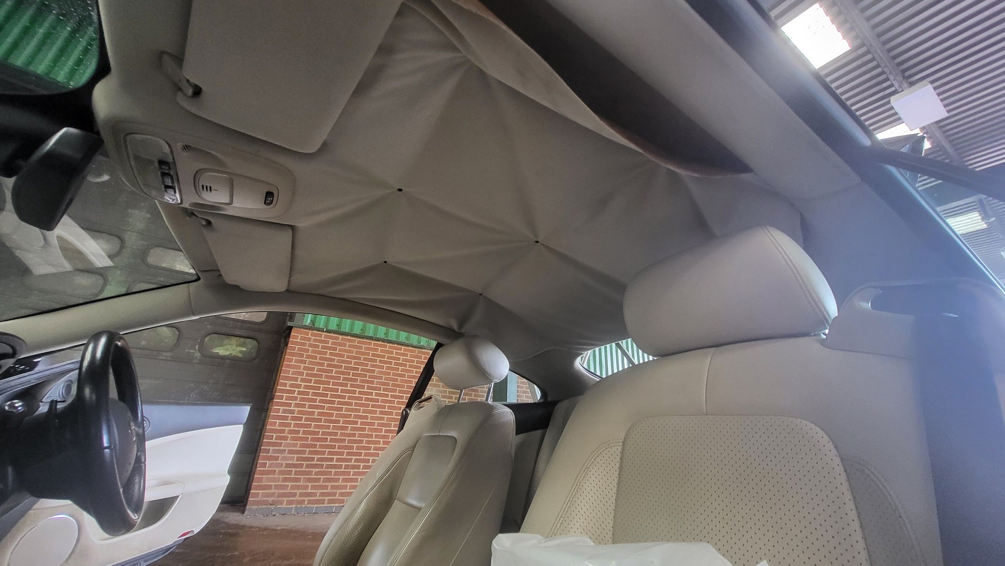

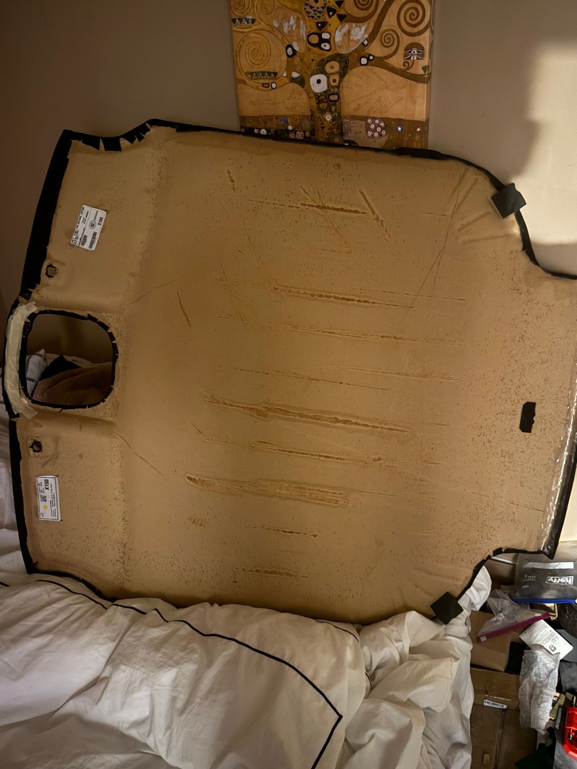

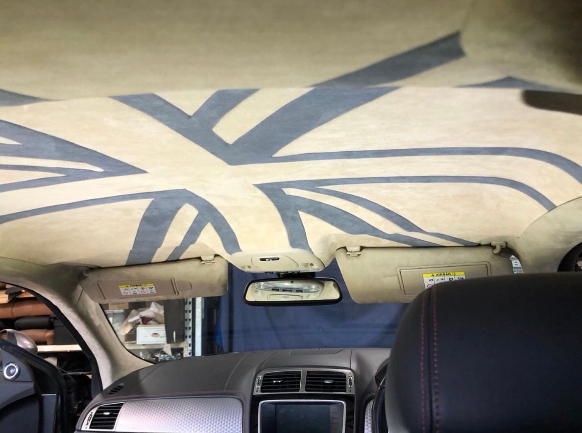

When mine sagged we decided to have a bit of fun…
