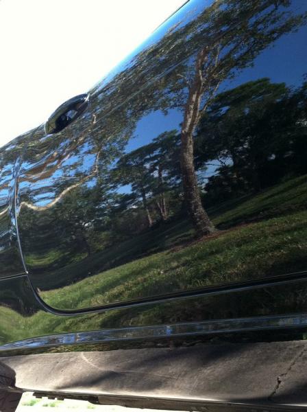

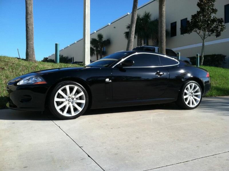

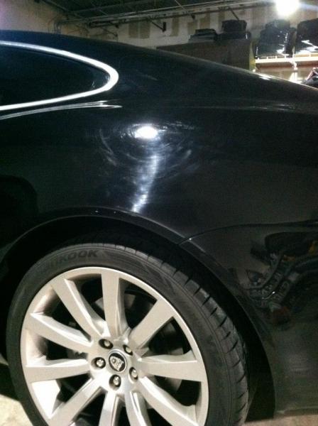

Got some paint spray on the car while on a trip to Tampa. Must have been overspray from an overpass construction area. Anyway I took it to a local car wash in Tampa and asked if they could get it off. The guy said they could clay bar the car and then wax and that would do it. The results were horrifying, The car was totally scratched with fine scratches and swirls from end to end and top to bottom.
When I got home, I took it to Impressions Auto Detail in Palm City, Florida. The owner, Robert DiTerlizzi said he could fix it. I was surprised because I thought I was looking at a repaint. He had the car for three days and I picked it up yesterday. See photos of the results. I'm amazed! The car looks wet! In just three days Robert turned a disaster into what looks like a new car!
Attached Thumbnails Scratched Cat-cat-scratch-hood-530274_466703000031439_333954109_n.jpg   Scratched Cat-cat-scratched-fender386596_466702506698155_557533031_n.jpg   Scratched Cat-cat-scratched-tail386700_466702433364829_1188405529_n.jpg   Scratched Cat-cat2603306_467937403241332_328542284_n.jpg   Scratched Cat-cat530851_467938019907937_519587790_n.jpg
