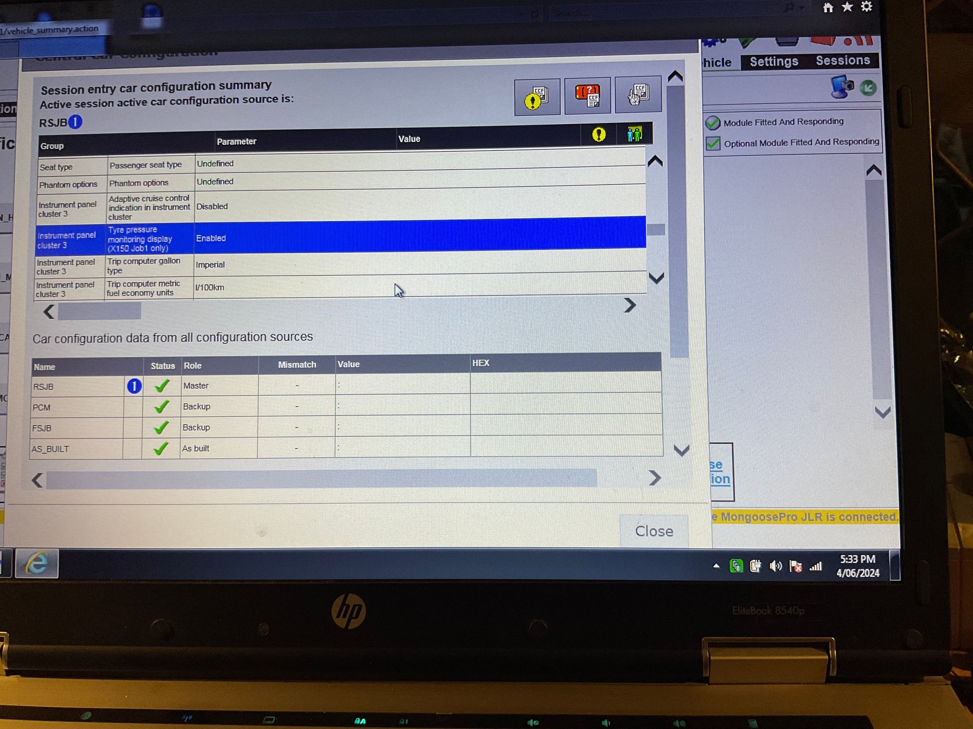

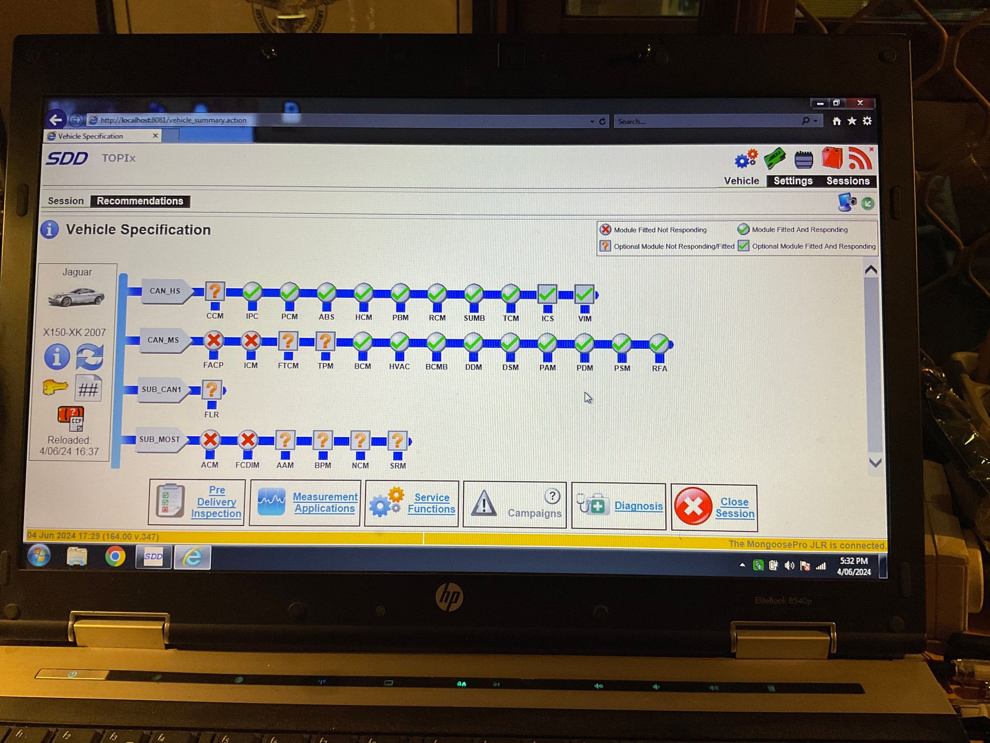

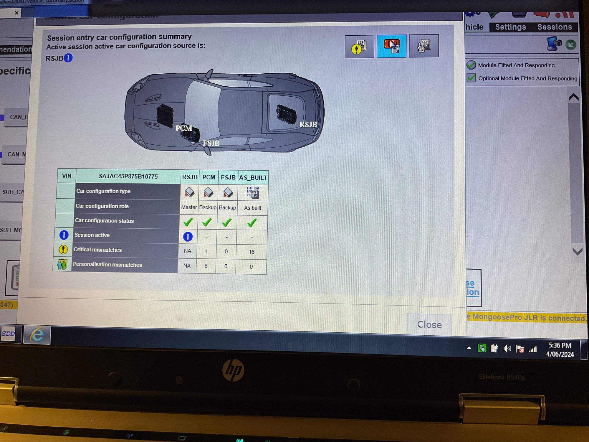

Hi to all from Queensland. I have a 2007 XK which is plagued with TPMS issues. I have tried new modules, sensors without success. I am trying to disable the system but can’t make the last switch on SDD. I have SDD v160 and a working Engineering access password generator. I get into engineering mode and the CCF files but although the parameters can be selected I do not get the selection on the lower part of the screen. See my photos (taken on a desk for the photo so battery is red, it is green when on the car with a power supply connected).
can someone tell me what I am doing wrongly?

That doesn't look like the right spot. When I did mine, I SORT OF remember changing two entries, but that one doesn't look like one I did. Oh, maybe you shouldn't be in the "SUMMARY" page. Try using the RECOMMENDATION pages.
