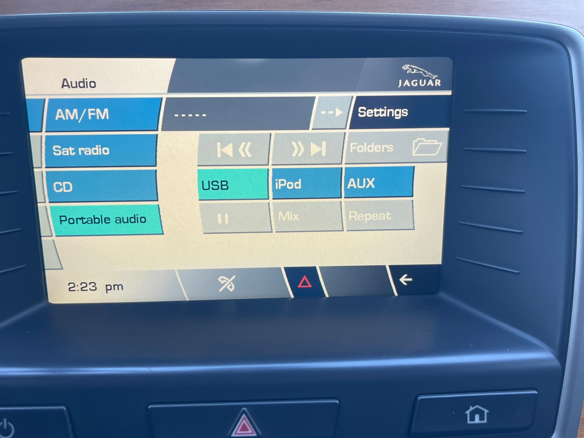

I want to thank everyone (you know who you all are) for the assistance in enabling Portable Audio/USB and AUX.
My Indie shop was able to do it for the low low price of $345.
In case anyone was following along, this was via a remote session with Autologic.
Success!
At this point I have to say, I am about $1100 all in.
So if you have an 07-08, without SDD access, just be aware.

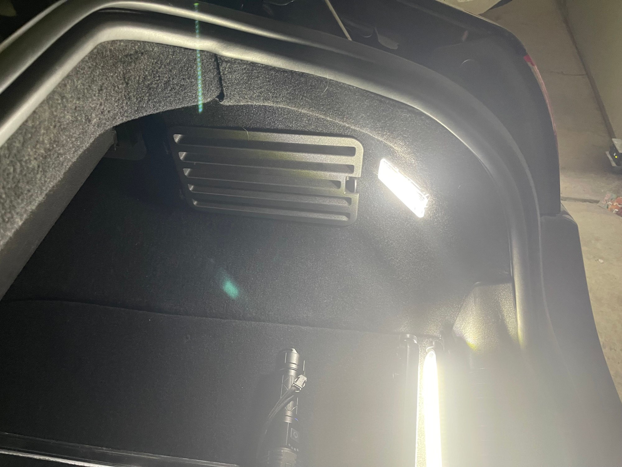

Just for you I will pretend I’m doing it. (Remove the cover and show the spot since that part of their video stinks.
I have zero video editing skills, so stitching in their Install showing the bypass ain’t gonna work. Maybe I’ll clip theirs as a Step 2.a or something.
EDIT:
I see arena mentioned it was difficult.
i opened it up and tried to get a good pic.
Arena, any chance you would be able to add some closeups to identify which connector and what it looks like in a vert?
Psgr side trunk,
Psgr side trunk,
Cover pulled back. Nowhere as much room as in their video.

I found this step to be the most difficult part of the process. When you remove the connector from the module you need to disassemble the plug to be able to connect the loop. I broke mine. Once the loop is connected it’s not necessary to to plug back in to the module…just sayin’

No worries. I’d guess that spot is the same.
So not much space to put the box. I’d guess right next to the hydraulics there.
The video isn’t an X150 for the bypass part.
But that gray foam on the top is in mine, squished on top of the hydraulic box.
