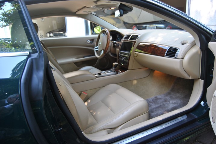

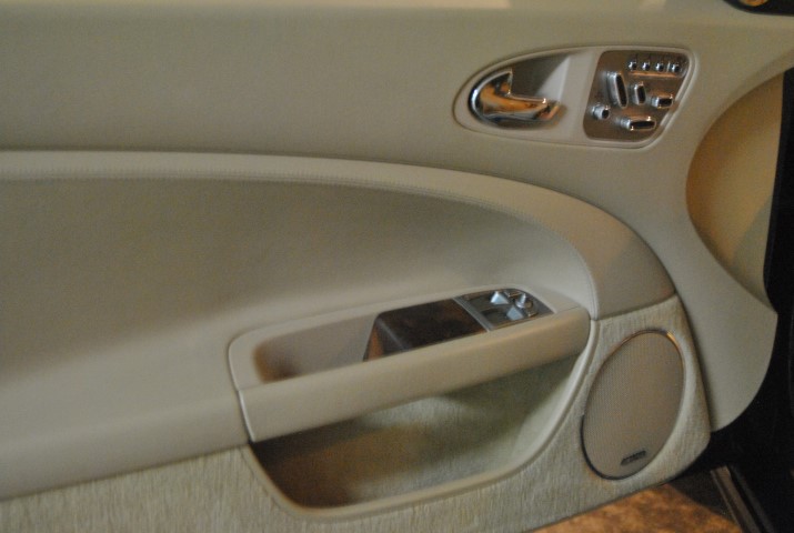

I have made this change - child's play, really. The newer button unit just plugs in in place of the existing unit - a perfect fit and perfect operation - and it looks so much more "upscale" - you can also make other upgrades as Jaguar did: replace the 2006/7 window switch panels with the later two-piece wood trimmed units - but you must also replace the switch pack because the older window switches do not clear the later panel cut-outs, so this becomes and expensive change (but again, it is a "plug and play" upgrade). You can also install the chrome-trimmed tweeter covers, and the chromed-trimmed column switches - all of these satisfying changes can be seen in the photos of my 2007 car (compared to these beautiful Jaguars, the Maserati competitor looks like an XK designed by a committee that could not agree on anything except that it should cost too much and preferably but not necessarily last until the warranty period expires).

I also have replaced the door panel window switches with the newer version type and made them fit the existing gaps in my 2007 XK, just a bit of filing of the plastic that the switch pack sits on and they then fit flush and I've also changed the indicator stalks to the chrome ring type, looks loads better.
I've also replaced the chrome ring tweeters £35 for the pair off eBay after I used my nectar £15 off voucher.
The door card requires to be removed to fit the seat switches, once off it's just a case of unscrewing the switchpack, unplug the connector and then replace with newer version. 2010MY when they changed to the upmarket switches and were green LED so match nicely with the 2007 interior.

Drat - discovered. Hi Michael...all the parts I used for my interior upgrades were bought through my Jaguar dealer, but there must be some available from wreckers - I just wanted to keep my XK pristine.
The door panel removal is not difficult. It is in section 76.34.01 of the repair manual and essentially goes like this: remove the tweeter housing (3 clips) and disconnect the speaker. Remove the door panel: there are two torx screws under the armrest and there is one hidden at the latch side of the door, at the top, covered by the black plastic piece which is gently pried off. The door panel itself is held to the door by the normal series of plastic clips around the edge and the top. Begin by releasing those at the top (window down for easier access). Now you might release the interior door handle cable (removal obvious) but I did not. I simply sat on the sill, and supported the panel on my knee.
The seat control panel is held to the door panel by 4 torx screws; remove and disconnect the electrical connector. Replace it with the NEW and beautiful seat control panel. The rest is a reverse of the dismantling - just make sure that the door handle cable is properly fitted if you have removed it. There you have it! While in there you might see if anything need lubrication.

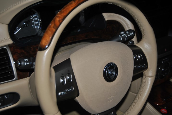

The wood-trimmed steering wheel was part of the "Luxury package" on the Canadian-market XK for 2007 (and probably for other markets as well). The other items in this package: 16-way all-leather seats (leather everywhere with a different upholstery design compared to the standard seats which had only leather seat facings), 19 inch Carelia wheels, adjustable seat bolsters, the full leather interior including the leather instrument panel - and that wood/leather steering wheel which was also heated - very nice in cold weather. The Canadian cars also had the heated windscreen and the engine block heater and headlight power wash as standard equipment.
The wheel is a direct replacement for the standard all-leather wheel but the airbag module needs to be de-energised. While it can be a DIY job, I would leave this to a dealer.

The later-style chrome trimmed switch packs for the seats were, as I wrote earlier, new and from my Jaguar dealer; the part numbers for the 16-way seat switches are C2P17341 and 17343. The dealer charged me $150 Canadian each - which was a discounted price. But the visual difference is well worth the cost!

Gaudin lists those parts as "seat switch". I probably misunderstood, but thought you were able to replace just the buttons and cover plate. I am now guessing that the only way to upgrade is to replace the whole switch, which would explain the cost.
Old Feb 14, 2016 | 11:38 AM
sov211's Avatar
Posts: 3,919
Likes: 2,524
From: Victoria, Canada
Yes, the switchpack, buttons and plate are one unit which simply fits into place with the 4 torx screws. The parts are not available separately. But honestly it makes a huge visual upgrade.
