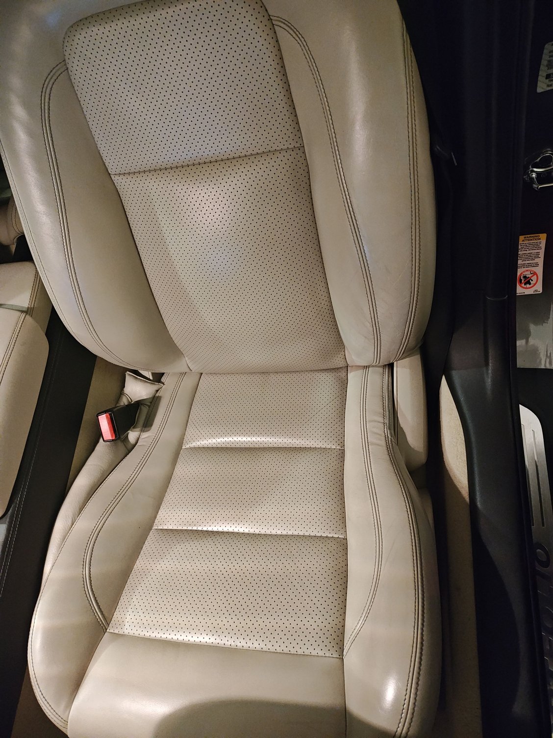

I've used Griot's Leather Cleaner for years, and my leather is still like new, including the dashboard. I've kept the seats that way by occasionally touching up the driver's seat where abrasions are caused by getting in and out.
I've also changed the way I get in and out of my XKR. I used to face the front of the car while putting my right leg in while sliding my butt into the seat. Doing so caused abrasions on the upper and lower outer bolsters. I now get in with my back to the driver's seat, plop my butt into the seat, and then swing both legs in while swiveling my butt in the seat to face forward. That minimizes abrasions to the outer bolsters.

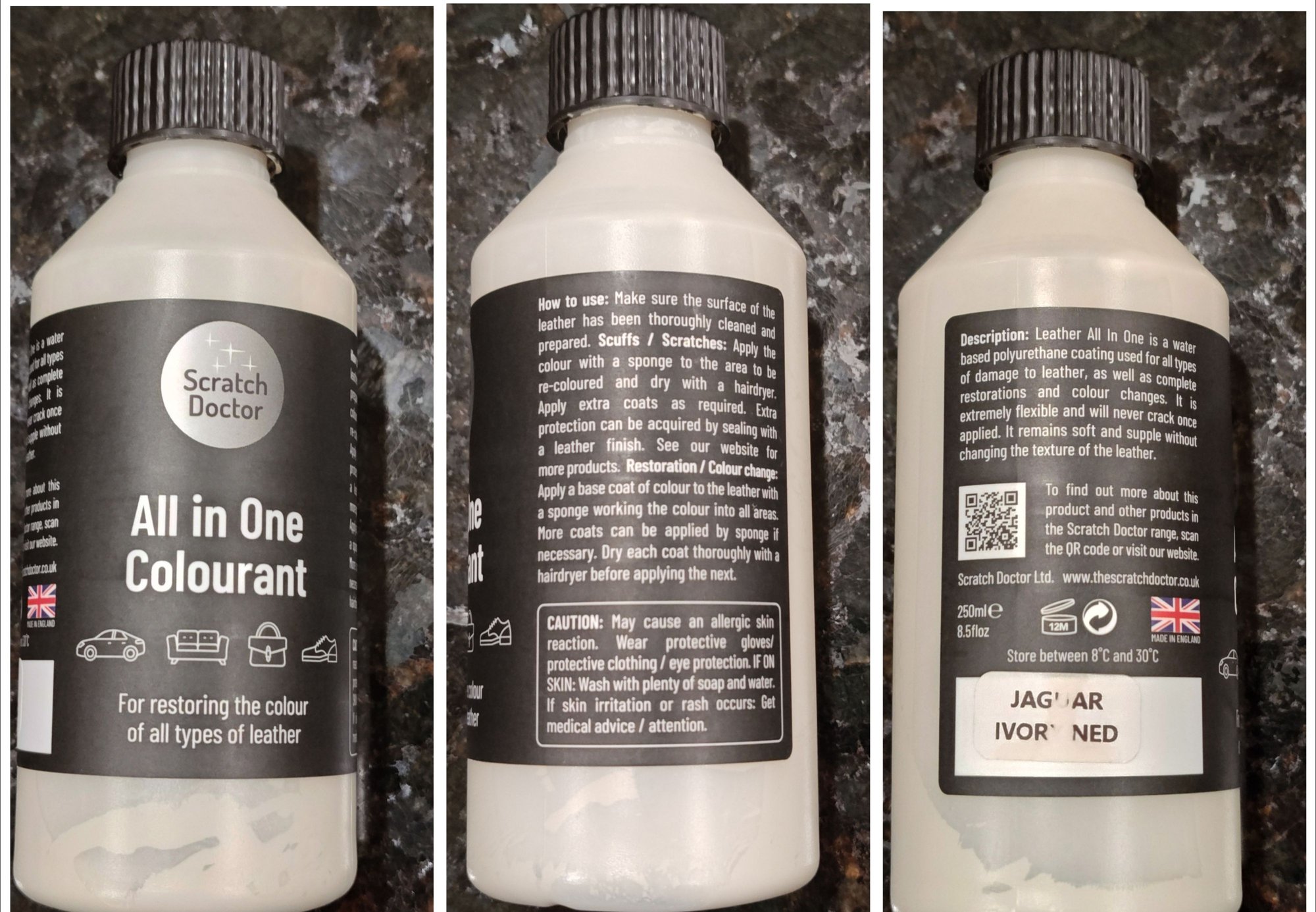

I highly recommend this leather dye (actually, it's paint). It's water based and easy to use. Read the instructions. It will fill in thin cracks in the polyurethane coating and improve the appearance of your seats. Sorry that I didn't take "before" pictures.
My driver's seat:

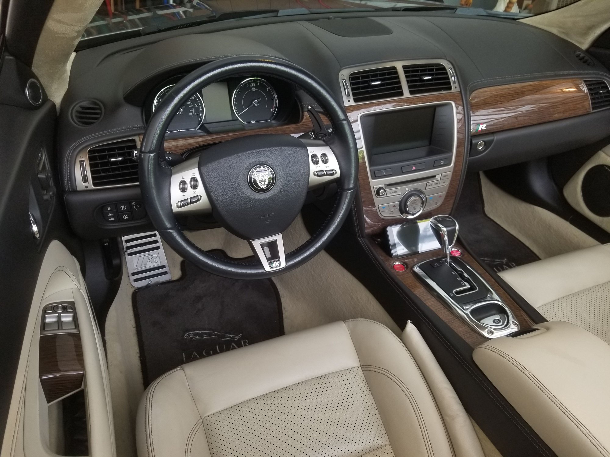

Full interior
Color differences are from lighting differences.

Did you use their color matching service? If so, did you need to send the swatch sample?

I didn't use their color matching service. Their stock formula for Ivory was fine. The key is to clean the surface thoroughly, use a hair dryer on low to dry the surface, and apply one or more thin coats with the supplied sponge and dry each coat with the hair dryer until you get the desired result.
