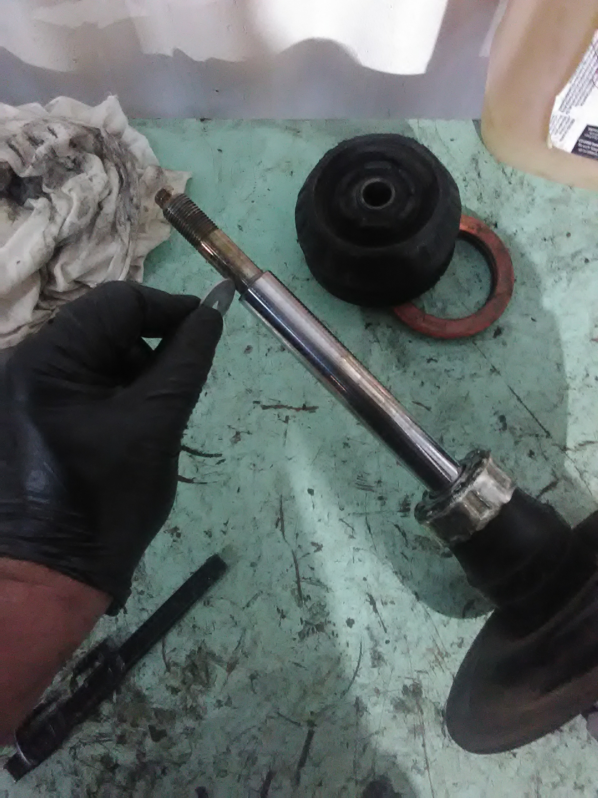

Steve, a couple of questions for you. Should the new top plate come with a new bearing? Also, and this one is going to sound dumb, but does the bearing looking thing that come with the Bilstein struts and sits right on top of the piston(under the threads) stay right there when you install it? I'm almost positive that's where it was when I removed mine but I want to make sure at this point.

By memory there should also be a washer that sits here
(PS this is not a Jag strut I'm simply using as example)
Yeah it's a washer and that's where I have it. It's just a pretty thick washer so I wasn't sure.
