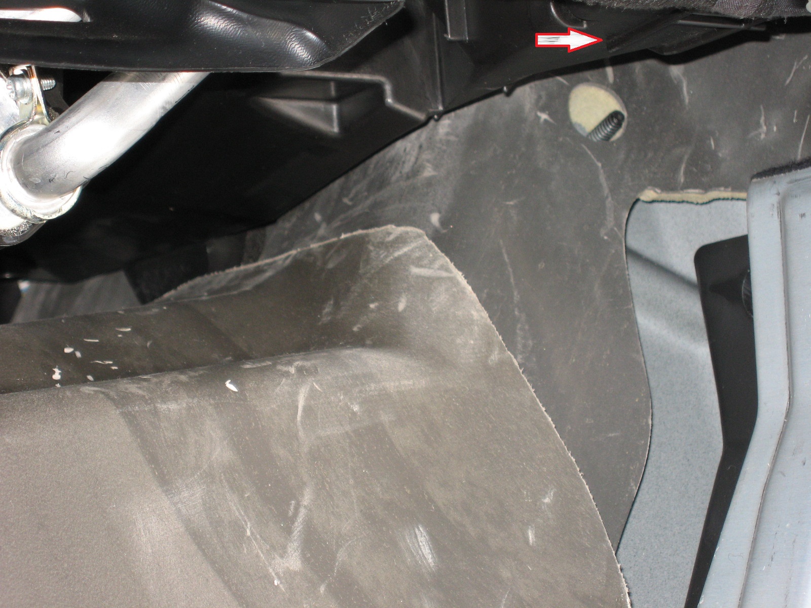

After noticing the dreaded condensate water in the passenger footwell of my '07 XKR (14k miles) from clogged A/C drain tube, I diligently checked the forum and found that I needed to: either drop the tranny and update the A/C drain hose; remove some exhaust parts and cut off the end of the drain hose; or add a new DIY drain hose behind the carpet in the passenger footwell. OK, says I: put in the DIY drain and that way, you can access and clean it easier if it clogs again.
So, looking in to the footwell with carpet removed, I see the little triangular funnel on top of the drain tube over the tranny in the center of the dash. See the low, black piece in left center of pic. Hmm. Maybe if I whacked it ( I used a 12" x 1/2" steel rod) it might loosen up the tube and start draining. I really didn't want to drill holes in my mint XKR floorboards. Sure enough, a couple whacks resulted in a fine half pint of drainage onto the garage floor. Problem solved, at least for now, and all it takes is pulling back the carpet and whacking the tube a couple times. Less than 10min work. It's been draining fine for over a week now.

This is great information but I wonder if you could clarify exactly where the triangular piece is - for the life of me I cannot identify it in your photo! Where exactly do we whack???
I can't see it either in the picture, can you edit your picture and circle or highlight where it is or another pic.
The only thing i see in your picture that looks like a pipe is where i have the arrow pointing to. Is this it.
Thanks
Attached Thumbnails Simple A/C Condenser Drain Fix-drain-tube.jpg

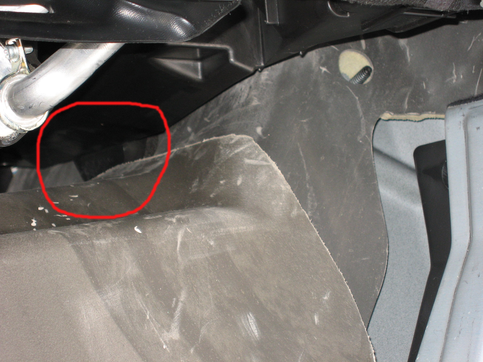

I think he means the area I circled in red.
It looks like the area he mentioned, left center of photo and is probably connected to the drain tube. Black thing hanging down in the center of the dash but maybe he can confirm.

Sorry guys, I should have been more clear regarding the area. Yes, DpezXK8 circled the correct area for the drain in red. The black plastic condenser housing has a little triangular shaped "funnel" over the center of the tranny tunnel that has the drain tube attached to the bottom. You can't see the drain tube from the passenger foot well, but you can easily see the funnel and get to it for a little whacking. I wouldn't recommend hitting it too hard as I guess it could break. I hit it 5 or 6 times about as hard as I would hit a finish nail in carpentry. The car is still draining properly now after a couple weeks.
