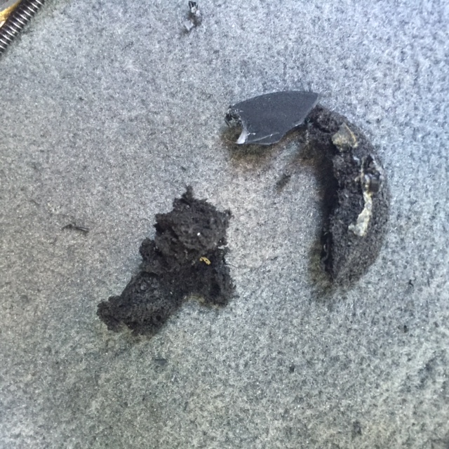

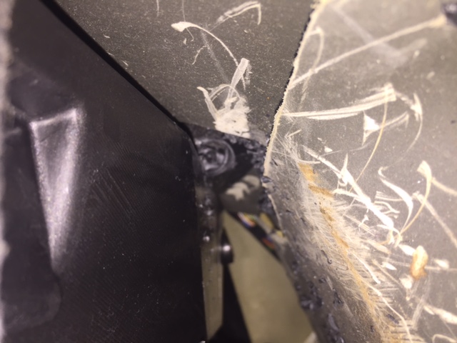

Hey guys, I thought I would offer an update on this thread. I previously mentioned in another AC fix thread that I would attempt to cut into the funnel, but since this thread talks about cutting the funnel, I thought I would share what I found today.
I drilled a hole into the funnel and the outer piece actually broke off. Behind the outer plastic "mold - funnel" is a rubber foam material. That was also coming out in a few chunks.
I stopped drilling / cutting as I was unsure of what I actually was cutting into.
Thought on where the drain would be? Is it directly below the funnel? Is it on the other side of the firewall "ahead" of the funnel?
I live in Florida and normally I will get a few drops under the car or more recently...water in the footwell. My BMW leaks like crazy.
Today could have been the driest day I've seen. 20% humidity... I don't think I can even get the car to leak today with the AC on.. Im unsure if I will feel moisture in the new hole I cut... or if I havn't cut far enough.
I figured worse car scenario, dash has to come out anyway to fix this...that's why I decided to give it a shot. Unfortunately, the evaporator is crazy hot when you have the car running trying to feel moisture... a nice burn told me it was time to rethink this.
I can grab another pic tomorrow, but I actually drilled in deeper than these pics show.. seems to be lots of insulation in there. I didn't see any metal (other than the fire wall / trans tunnel" right in front of funnel).
I should note that I was able to insert a thin piece of wire into the insulation and I thought I feel it get hollow as I slid it past the insulation. Is the water being funneled into hard plastic or rubber? I know the duckbill is rubber..but I am really confused on to what I saw / felt today.

The duckbill is on the other side of the firewall, sticking out above the transmission.
I'm surprised there's insulation in there - seems like it would act as a sponge and retain water. But maybe it's to stop condensate from sloshing around before it builds up enough to open the duckbill. Dunno, never seen inside the casing.
