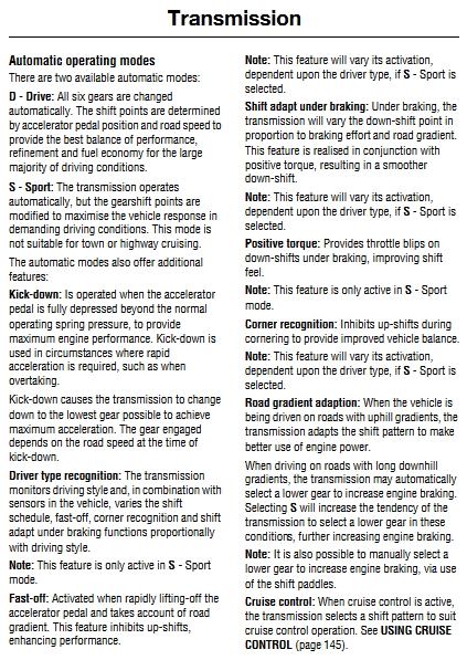

I called it the wrong thing, this feature is called "Fast Off" and you can see it described in the owners manual:
Fast-off: Activated when rapidly lifting-off the accelerator pedal and takes account of road
gradient. This feature inhibits up-shifts,
enhancing performance.
