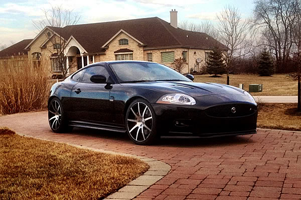

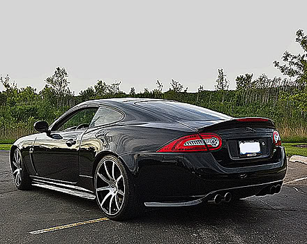

I went with Paramount Performance UK lowering springs which are about an 1 inch drop (25mm). There are some more aggressive springs that are 1.5 inch drop but didn't wan to go that low. In the past, I've lowered my C5 Corvette (lowering bolts) and Mercedes (lowered by star diagnostic programming with the air suspension) and had no problems. Typically it does ride harsher but I lower it so it doesn't have the 4x4 look. I go over speed bumps all the time with the Jag at the club with no problems and I do angle in and out of the driveway due to the fact I also have a front splitter on my XKR but you just have to go slow. I've had the lowering springs for 2-3 years now. Here is the PP lowering springs.

Near the end of my friend's vid in my sig below...you can also get a sense of how much of a drop with the PP springs.

The wheel size I'm running are:
Fronts 20x9 with a +40 offset
Rears 20x10 with a +25 offset
Tires:
Fronts: 255/35/20
Rears: 285/30/20
I was looking for standard 18s when I was buying the XKR as I knew I was going to go aftermarket and didn't want to spend the extra $$$ for the optional 20s. For some reason it was slim pickings at that time for finding a new black XKR with 18s and a few options. You would think black would be easy to find but luckily my dealer was able to find one in NY and ship it to Chicago.
Spires exhaust? NICE! If it's the same one that it's on youtube, that thing sounds bada$$.
35mm actually might be better than my 25mm as I still have a small gap between the tire and wheel well. 35mm should eliminate that gap. You should take a vid of the spires exhaust!

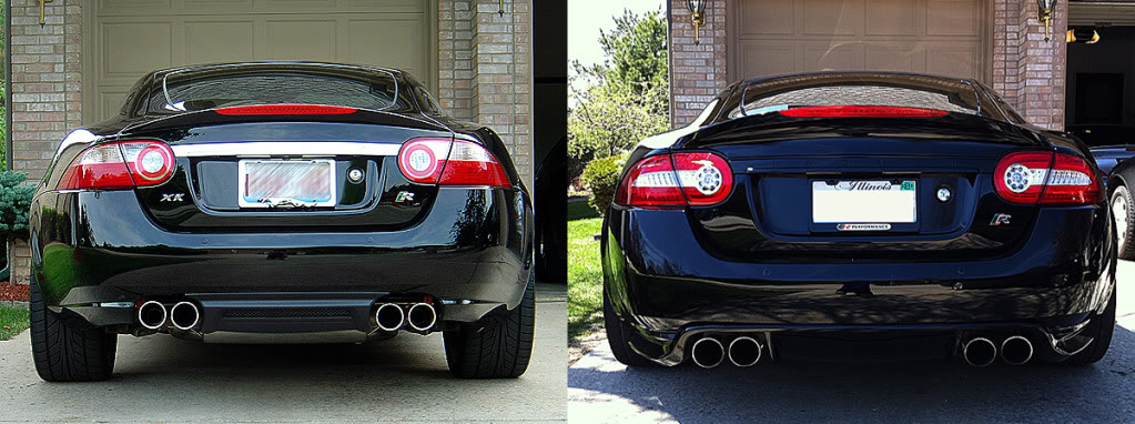

Hi sending some more pictures of the completed stance setup:
- 35mm drop H&R springs
- 20mm wide H&R Trak+ spacers rear 15mm front
- Color coded Jaguar strip
- Debadged
- Color coded plastic diffusor
- Jet black painted front griller
- Carbon fibre wrapped jaguar badge
- R badge on front grill
Already ordered
- Bigger rear Spoiler
- RS rear diffuser
- RS front lip
- RS sideskirts
- Still waiting for the tytanium quad 4" exhaust tips from Spires as they are on back order
Also considering to have the car tuned by Spires (pulleys upgrade, induction kit, exhaust already in but additionaly 200 CEL sport cats and manifolds, and a custom remap) all together should give around 480bhp according to Spires.

The rears look to have a lot of negative camber, as that just the camera angle?
Vince
Did not have the time to do the laser aligment yet but to be honest it looks quite nice and agressive the way it is now, plus it drives perfectly fine Springs + spacers and no rubbing no matter what the road even on full lock.
What are the downsides to running such camber? (photos make it look like it has alot of negative camber but its not that much really) apart from the obvious tyre use being higher on the inside.

The first and biggest thing you will notice is your tires will wear much more quickly.
It would take a little study of your setup to see just how much traction you are giving up as well. You have offset your footprint, so you have given up maximum traction in all conditions except where the tire is on the outside of a hard corner.
Doesn't seem to be a deal breaker for many out there, but for the price of tires you might not like cutting their life in half. Ka-Ching...
I'd definitely get it checked and see if you can get dialed back into specs....
