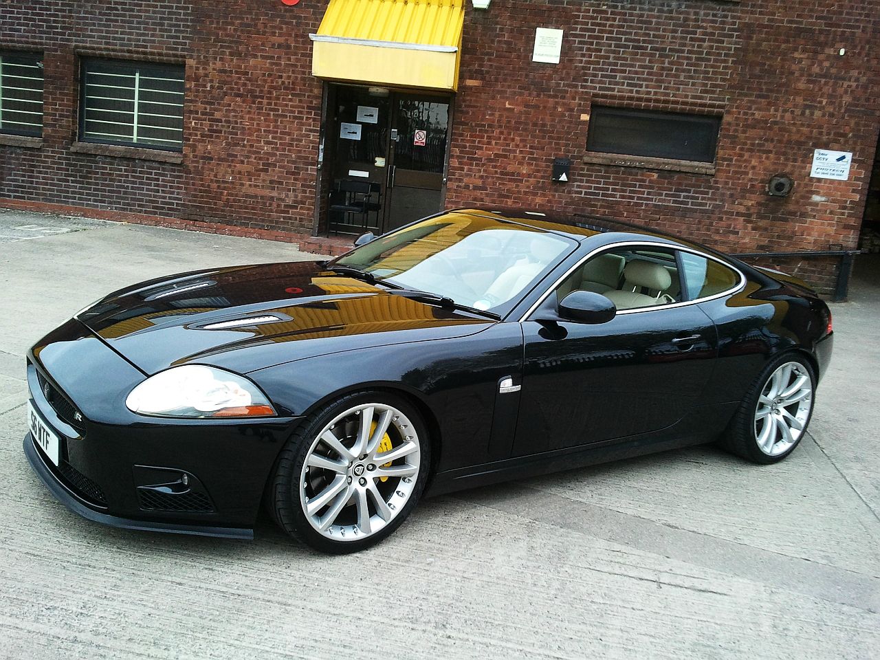

Originally Posted by Jeff2130
So what type (brand ) exhaust system did you install on your XKR ? Did you go from the cat back or an entire system and the final cost of that system.
Now its a long story but after Spires has failed teribly for me i have build my own exhaust and it consists of a miltek 200Cel Cats, custom fabricated x-pipe section with the actual X bit being a magnaflow component and a Larini lightweight backbox. The whole system is 2.5" made from highest grade materials.
As far as sound goes i have also removed the silencers or "air pockets" from both intake pipes (6 in total) (in uk we call them intake baffles) and installed track performance ITG foam filters instead of paper ones.
The effect?
This is not just my opinion but alot of people i met on Car meetings and cruises agree this is the most meaty, meanes and deepest V8 Roar they ever heard.
Total cost is about 5000GBP for such setup.
Additionaly had the upper pulley upgrade and a bespoke remap, the car was dynoed at 503 bhp
But it does not feel like 80 bhp extra, it feels like a whole new car as its more agressive, stiffer and louder as you drive it now and its what i wanted to achieve

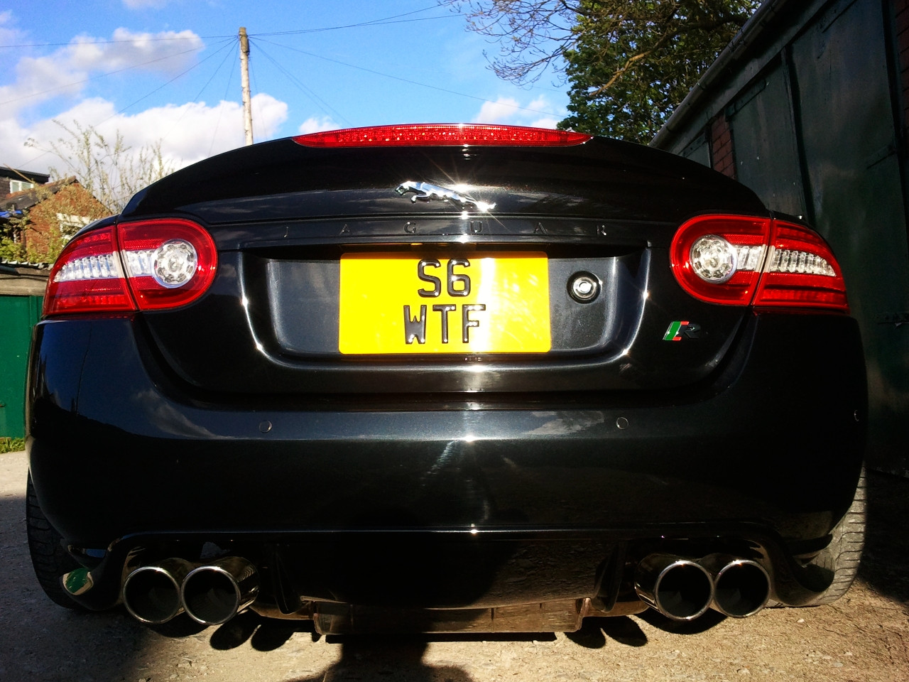

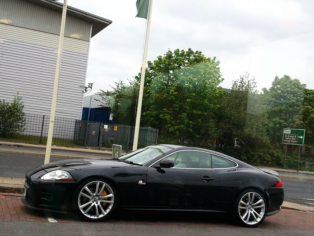

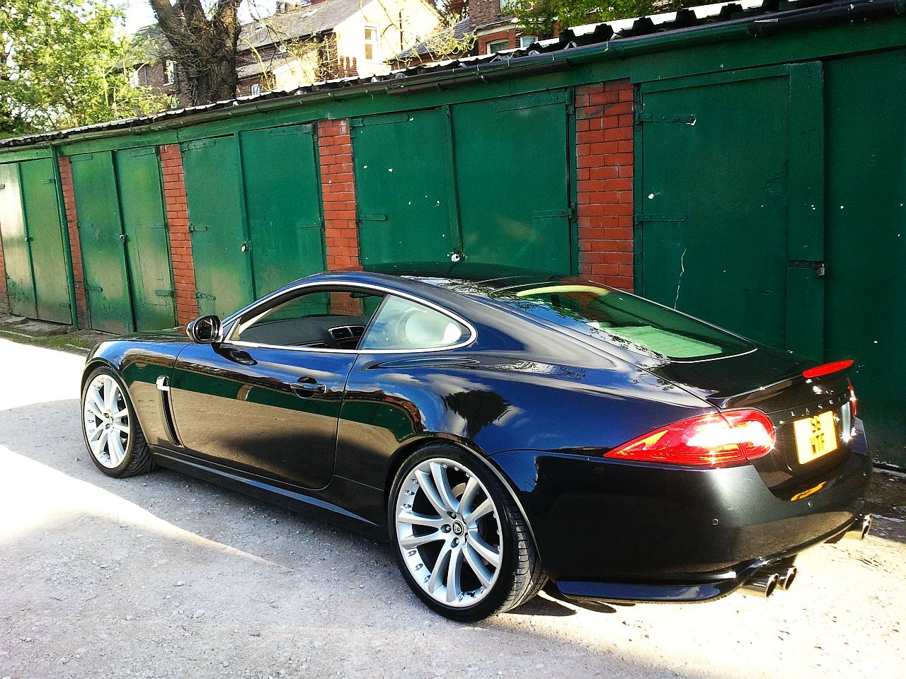

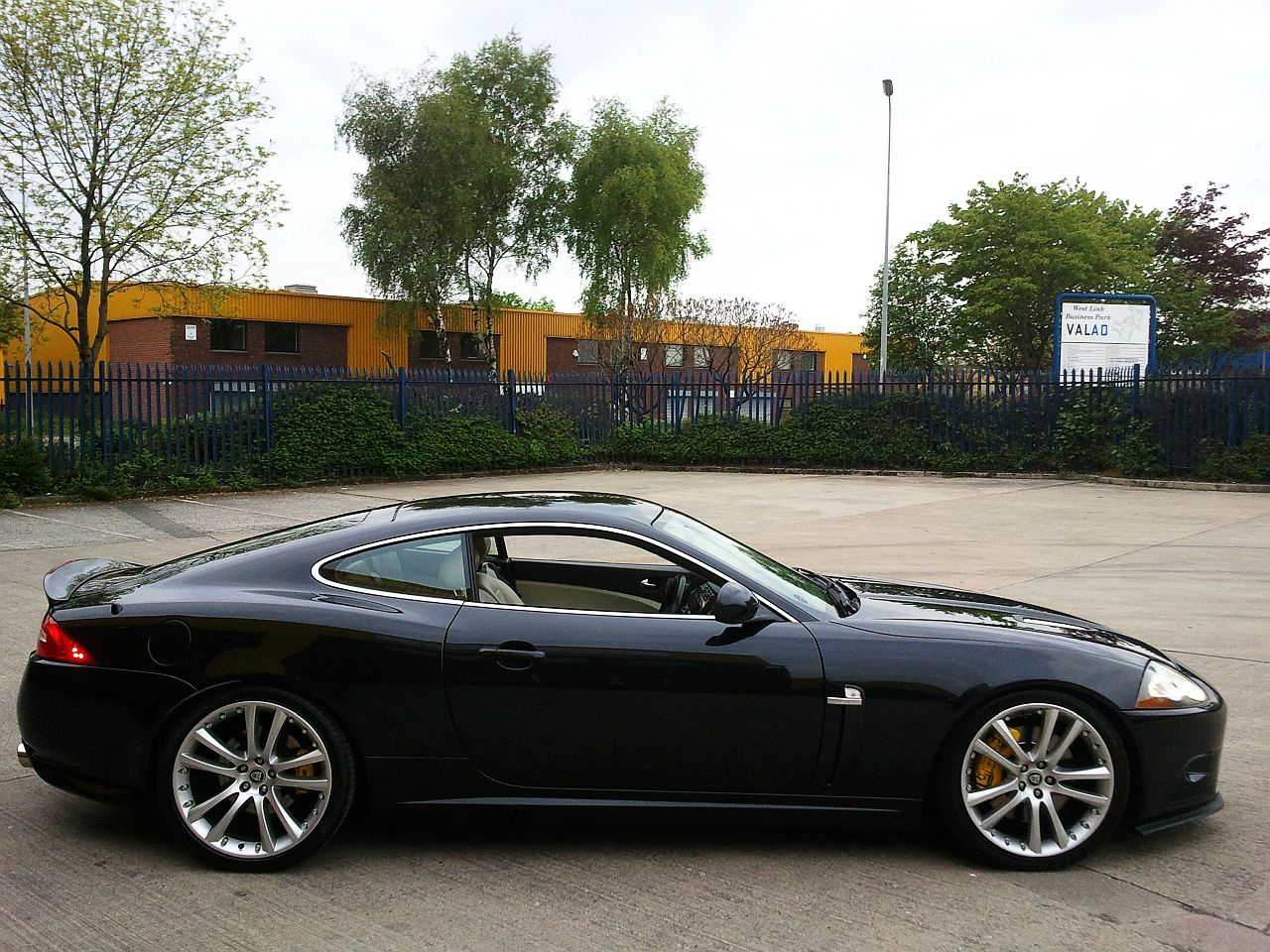

Heres some pics for you Evoking Hope you enjoy your newfound XKR stance as i do
