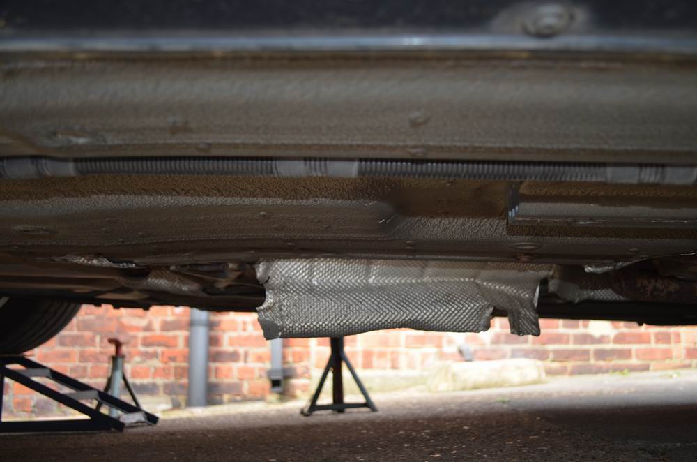

An annoying source of rattle I had on mine was a broken rear heatshield.
Fitted to the underside of the luggage compartment floor on four studs and secured with inadequate sized washers and hexagon nuts, these can rip through at one or more of the fixings and rattle against the top of the rear exhaust box.

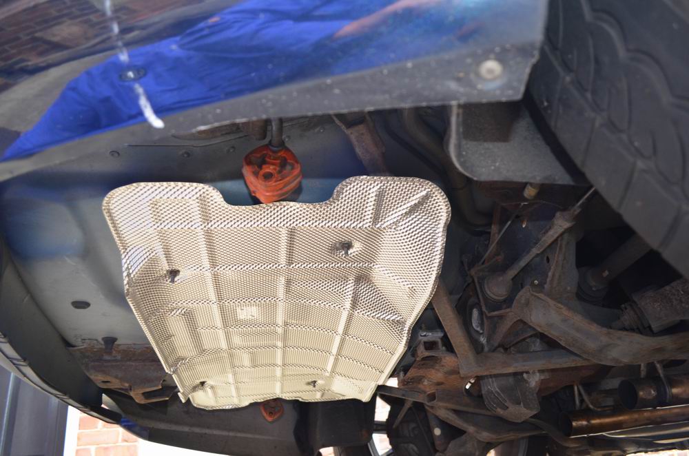

This is what the less than perfect Spanish roads in the Sierra Nevada did to my centre heatshield during the Summer!
Just what I needed 2000 miles from home.

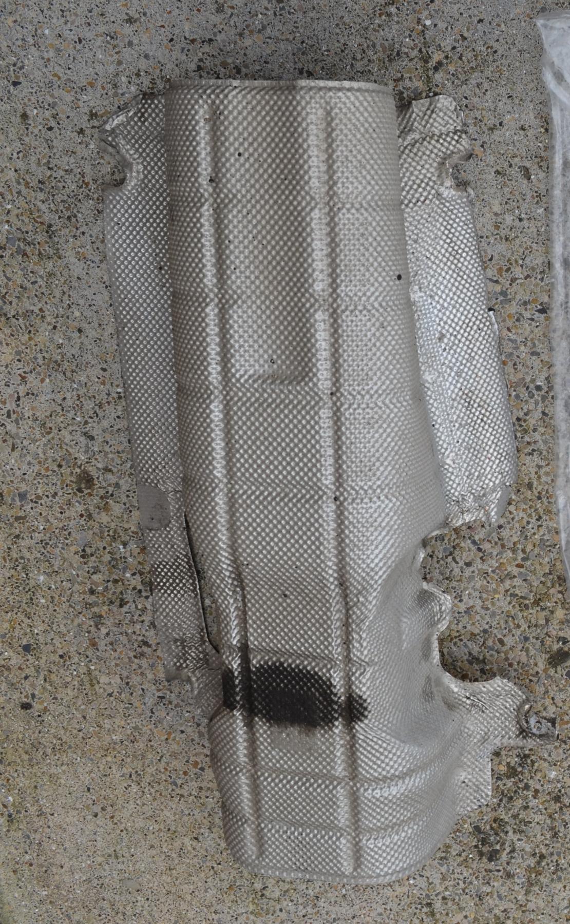

A 'traffic calming' road hump leading directly into a pothole. It certainly didn't calm me!
Original with a piece ripped out of the side:

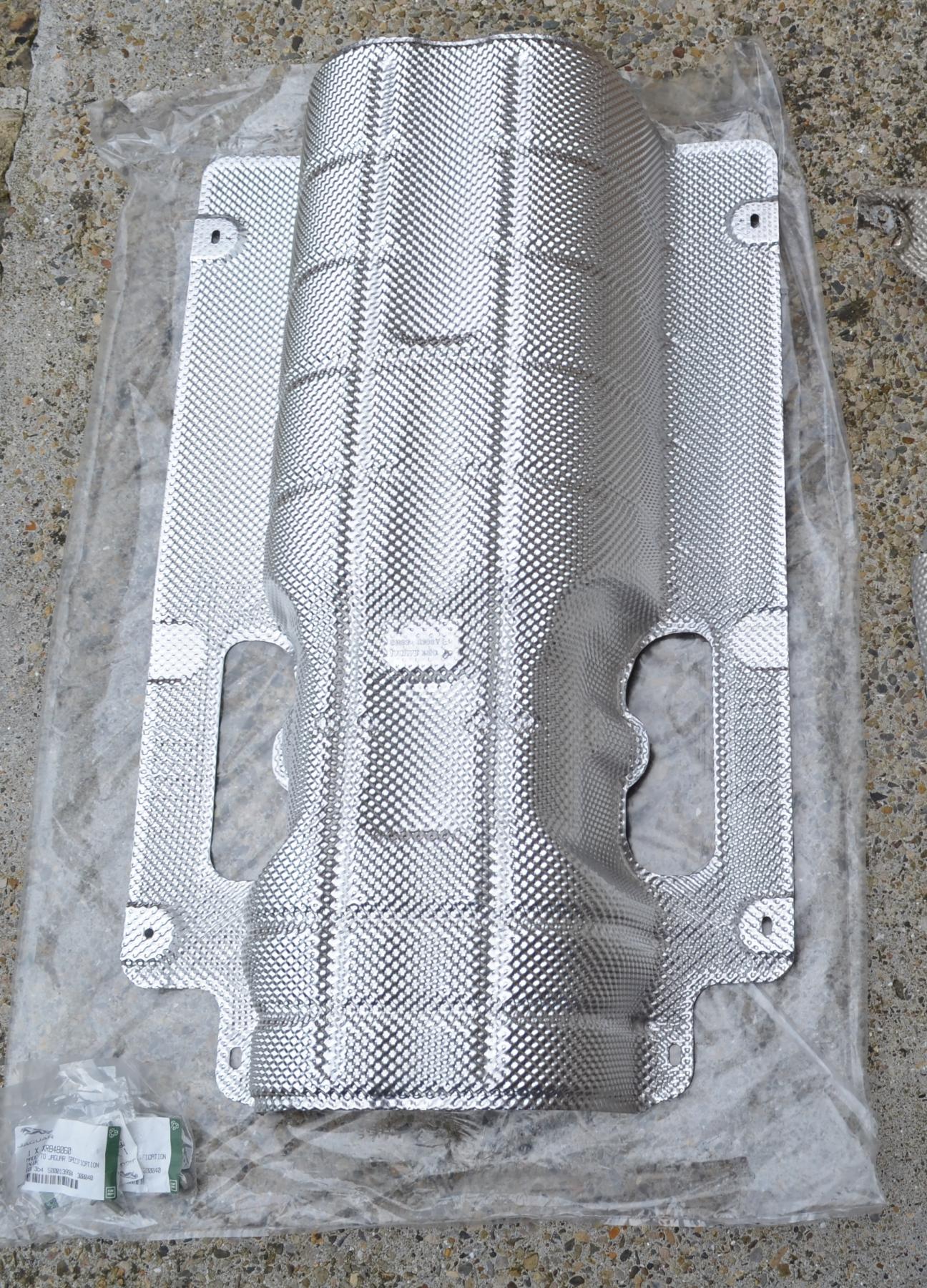

Replacement:
The heat shields are very flimsy, lightweight material.
