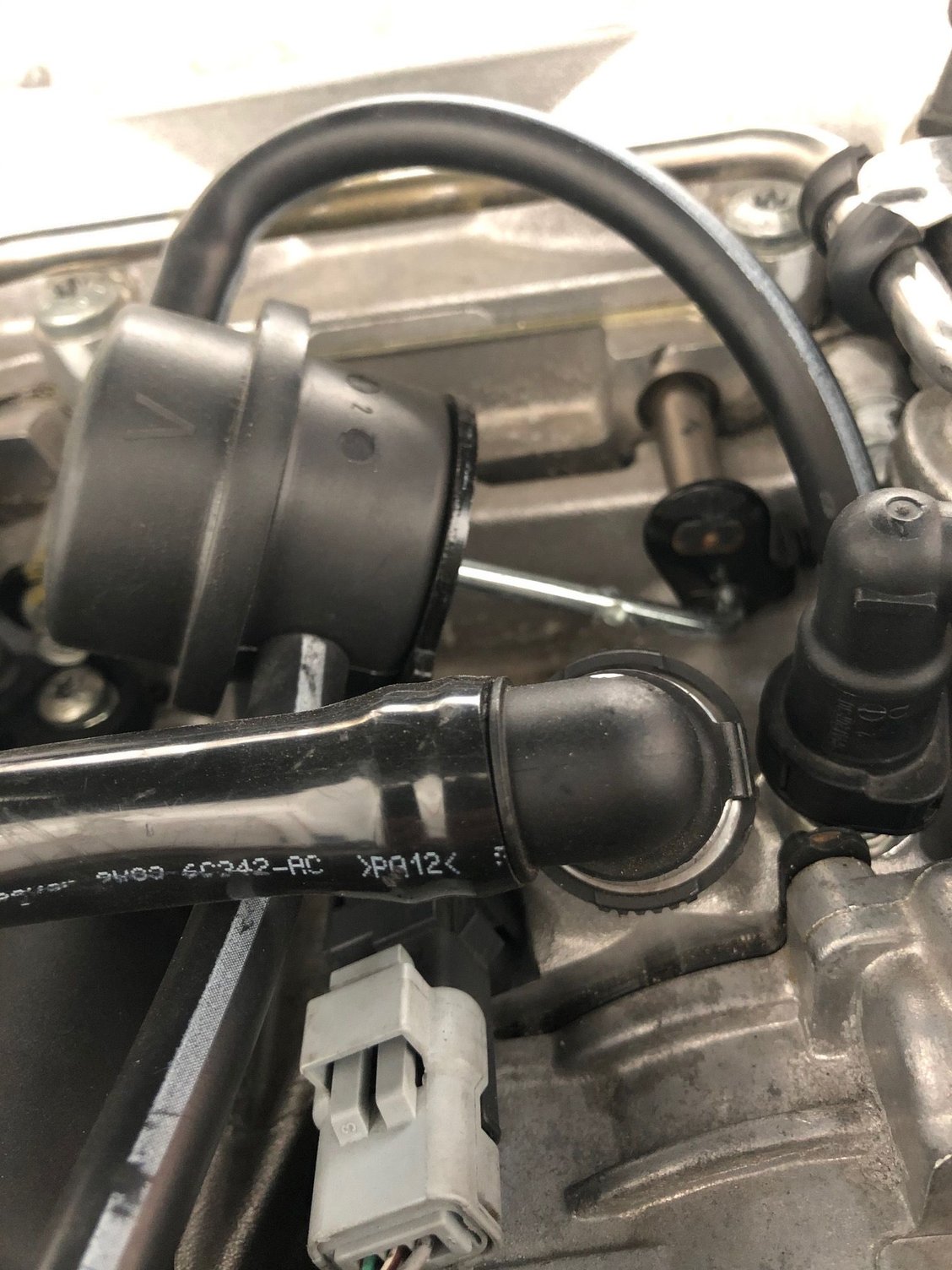

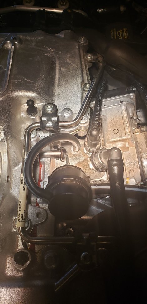

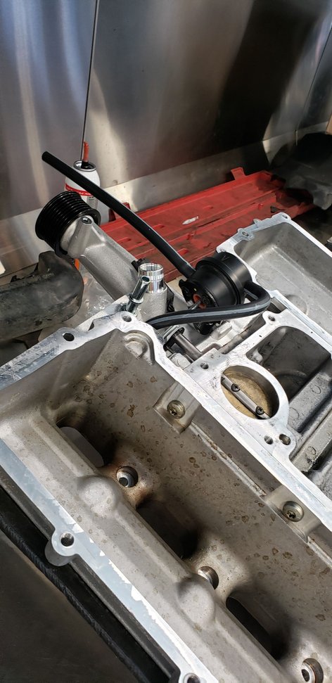

Can someone post a picture of their supercharger by pass, vacuum type--engine top picture with cover removed. From closely inspecting my car after having the torsion isolator replaced the bracket at the end of the actuator by-pass appears to be bent. I'm curious if this is the way it should be or should it be straight, picture below. I also have a picture of the supercharger with it off the car in the shop and it appears to be straight. Can someone please take a picture of their engine top and post it for me from the right side similar to first picture posted. Thanks.

The "L" shaped rod coming out of the vacuum actuator has two raised dimples. The arm on the bypass valve is supposed to sit between them and is straight. I can't tell from the pictures if this is your issue but if it is, it causes the actuator arm to come out at an angle. Easy fix - just unbolt the actuator and wiggle it about until the arm sits between the two dimples. Of course you'd think paying close to $200 an hour for labor would prevent such issues occurring in the first place!

Thanks TXFireblade. The circled black bracket appears bent and not straight. Yes, at 154/hour one would think he/she would get quality work. Do you have a picture. I will go back armed with the picture demanding it be fixed. I'm concerned about why the bracket is bent. It would take a lot of force to bend the bracket to the shape it is in.

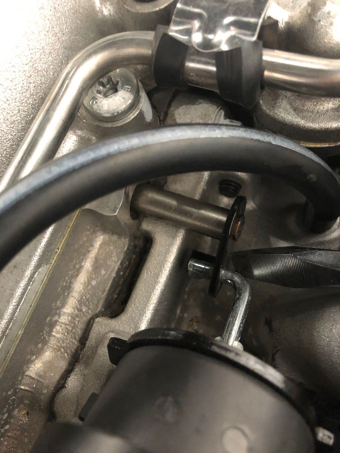

As requested. I took a closer look at your pictures and i see what you mean. Bunch of cowboys!
In this image the actuator is in it's relaxed or resting position.
In this image the actuator is in the retracted position.
If the actuator arm is bent, you'll need a complete new supercharger as the bypass valve doesn't appear to be available as a spare.

This really pisses me off. I wanted to check to assure it is suppose to be straight, as evident in the first picture of the supercharger removed and confirmed here. I expected them to provide much better service and to be honest with me. I will have a good conversation with them tomorrow to see what happened, why they never told me, and what they are going to do about it. For them to bend the small bracket that much they must have put alot of force on it.

No, no, no. They can't say that. The picture of the supercharger on the bench is my supercharger they removed from my car showing a straight bracket! My service Rep took me out to see my car in the shop and I took a few pictures. It obviously was done in the shop.

How did you get it to retract so you could take the picture--it is vacuum operated?
Old Sep 2, 2020 | 09:02 PM
kj07xk's Avatar
Joined: Jan 2015
Posts: 5,323
Likes: 2,597
See the tip of his screwdriver pushing it in?

You can also use a hand vacuum pump if you have one lying around .

The technician first installed the new manufacturer torsion isolator when he was suppose to install the solid isolator supplied. The picture of the supercharger removed from the car on the shop bench is with the manufacturer's
new torsion isolotor installed (installed with factory gasket). As evident in this picture the technician installed the solid isolator using a red sealant and not an OEM gasket supplied with the kit which he used at first to install the incorrect isolator. When he installed the solid isolator he did the damage.
