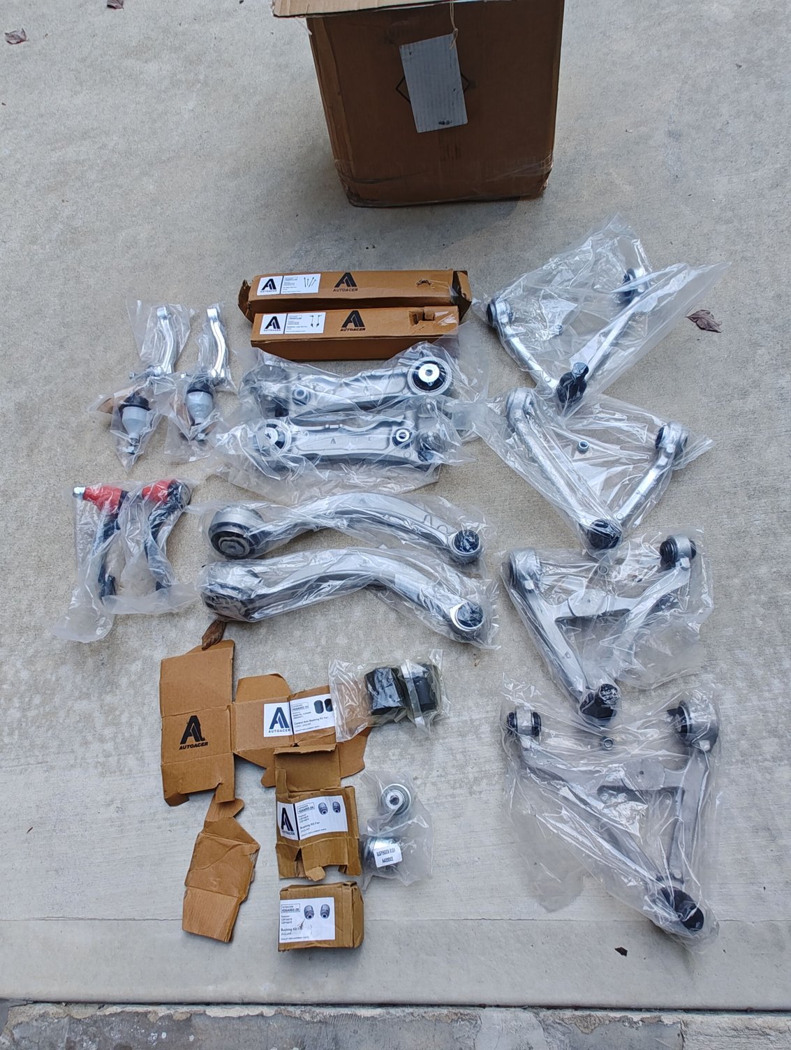

@luv2fly There's no point in buying expensive OEM Jaguar replacement suspension parts as we know those bushings don't last. What we don't know is how long the kit I bought will last. When they fail, I'll replace the rubber bushings with polyurethane.
Old Oct 28, 2024 | 10:47 AM
Stuart S's Avatar
Posts: 10,108
Likes: 7,119
From: Atlanta suburbs
I received the kit. I'm taking it to my technician today to inspect all the components and schedule the installation. I initially rejected delivery because the carton was damaged by UPS and several parts were ripped out of their boxes and I didn't know if they were damaged. The vendor persuaded me to accept the shipment and promised to replace any parts that were missing or damaged. I did so because that's covered by eBay's guarantee. To my untrained eyes, they appear to be excellent quality.
To be continued ...
To be continued ...
My box arrived partially crushed, haven’t opened it yet to inspect and count items, should do that sooner rather later…
Not planning on installing anytime soon, just nice to have spares on hand.

Following up on my installation ...
Everything was completed today, including replacement of all 26 front and rear suspension parts as shown in my Post #26, above. The only glitch was that both front tie rod ends didn't fit, so my installer sourced them locally. I will let the eBay vendor know, with photos and an explanation. After the wheel alignment, I took it for a lengthy test drive and I was very pleased. There's still more cosmetic work to be done, so stay tuned for the detailed photos.

I didn't say that all the work was completed in one day. In my post #26 I explained that I took it to my mechanic on October 28 and he began work the following day, 10/29.
The issue with the kit's tie rod ends is that the bolt diameter is larger than OEM. It simply doesn't fit.
