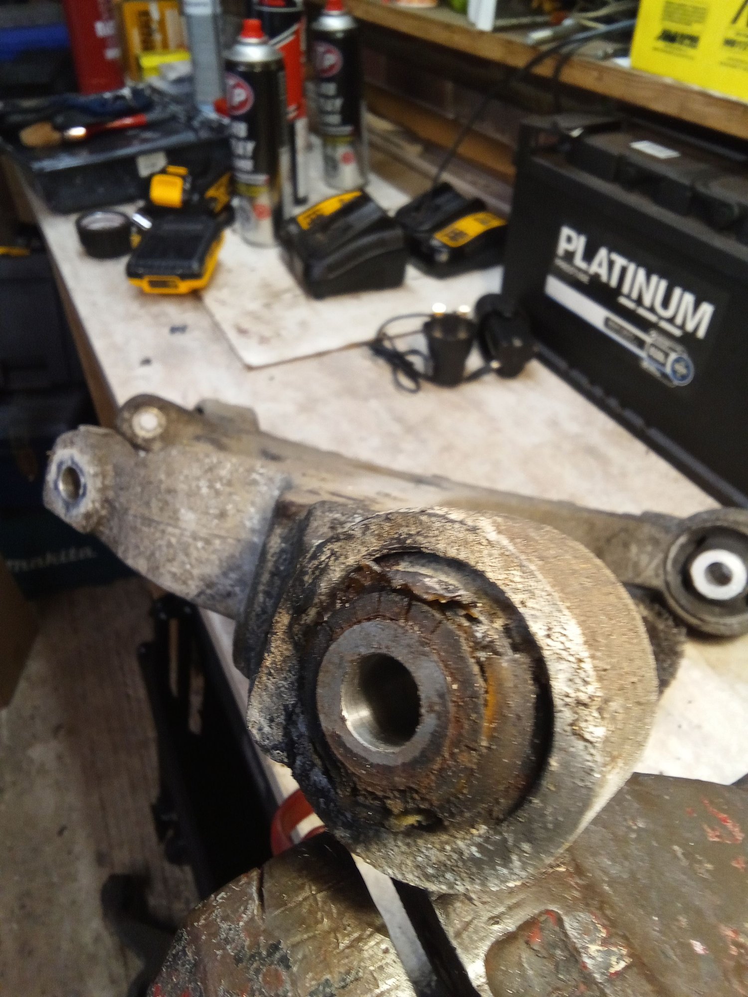

Just replaced both bottom rear arms today.
Son and I ,done in about 3.5 hours . I am extremely fortunate he is a mechanic in high level motorsport, he works fast and is 10 times more nimble and flexible than me . Car in 2006, we took off non Jaguar parts , so thet must have been done at some point. Fitted new non Jaguar parts .

To be honest mine looks nearly that good at the front , it's the rear that has suffered in UK climate. The front of my car is very clean , bushes and rubber covers all good , some rusting on the bottom of the shock. The rear has now had new lower arms,top arms, drop links and stabiliser bars , all had decayed rubber boots . The lower arms did not look that bad , however out of the car , you can see they look terrible and in a vice they have absolutely failed.
