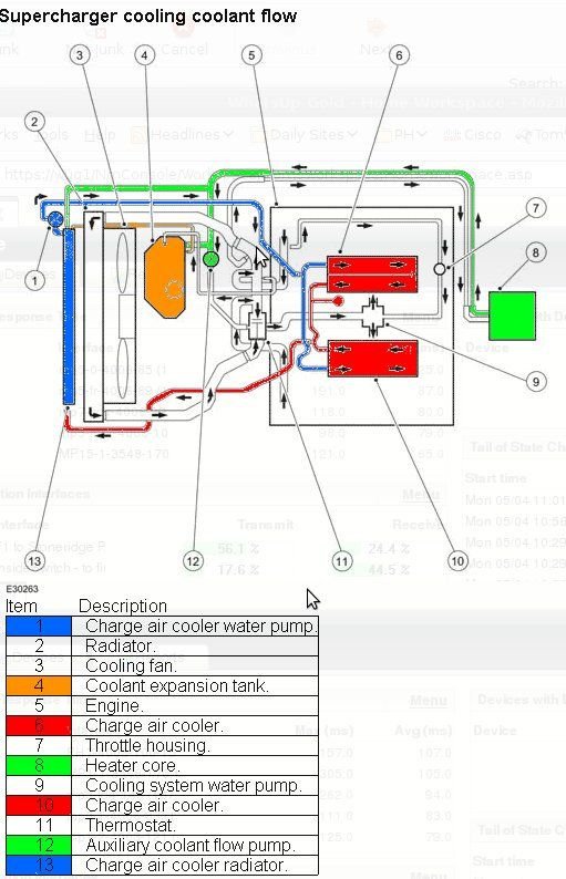

MoparDude,
I have the same XKR as you and suspect my t-stat is not opening. Does the coolant flow from the coolant manifold through the t-stat to the driver side hose (which I assume goes to the radiator)? I can feel the smaller "clipped in"hose that is connected at the t-stat location getting warm, but the larger hose is not getting warm. Hence, my assumption the t-stat is not opening. Thanks in advance.
FWIW....I just finished replacing the water pump and a doing all the operational checks when I found the t-stat issue. Also found the electric cooling fan running and it sounds like it's been running all the time, bearings are loosening up and spins a good while after engine is off. I just purchased this car, so no telling...but will have to check it out. Knock on wood it keeps running for a while...thanks.
Old May 28, 2022 | 12:52 AM
MoparDude's Avatar
Joined: Oct 2020
Posts: 128
Likes: 80
From: SW Ohio, USA
Originally Posted by mizzleman
MoparDude,
I believe it's actually opposite of what you are thinking. It flows from rad, up driver side rad hose, thru t-stat and into coolant manifold where it then branches off into 713 different flow paths lol
Attached pic should confirm it. Also, from experience I had reinstalled (or rather assembled) the new t-stat backwards the first time and obviously the XKR let me know it wasn't happy, got the warning light on dash. So I shut it down and after a visit on here and some investigation on my own that's what I found. T-stat installed incorrectly.
From what you describe though, you are most certainly not getting flow through t-stat, and failed or improperly installed is what I would check first.
Electric fan(s) powered on constantly is a sign temp is way up there. They kick on when car is overheating.

Thanks for reply. Great info. One question, what is the direction of flow from the t-stat to the auxiliary coolant flow pump? I assume that is the "clipped in" hose. I don't see an arrow on it?
I had planned on replacing the t-stat at some point and had purchased one with the water pump. Was hoping it was ok before I committed to changing it. No sense taking something apart if you don't need to.
