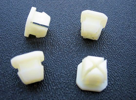

OK, guys. I have a fresh round of videos. I spent part of the afternoon with the XKR on ramps trying to figure out the sources of various noises I've been complaining about.
This is me hitting various parts of the exhaust/muffler with the back of a rubber-ended plumbers wrench.
Here is a video of the loose undertray. I thought if I fixed this, maybe it would've solved my strange drivetrain popping/creaking sound. I replaced two nylon nuts (similar to those pictured below) and now the undertray is nice and tight!
And the grand finale, and in my opinion, the most serious problem I have--the popping/creaking sound that seems to be drivetrain related. In the video, I am accelerating in forward and reverse from a stop pretty aggressively, which seems to allow the creaking/popping to manifest itself. This seems to be the same sound that occurs when I downshift aggressively using the paddle shifters in sport mode.
